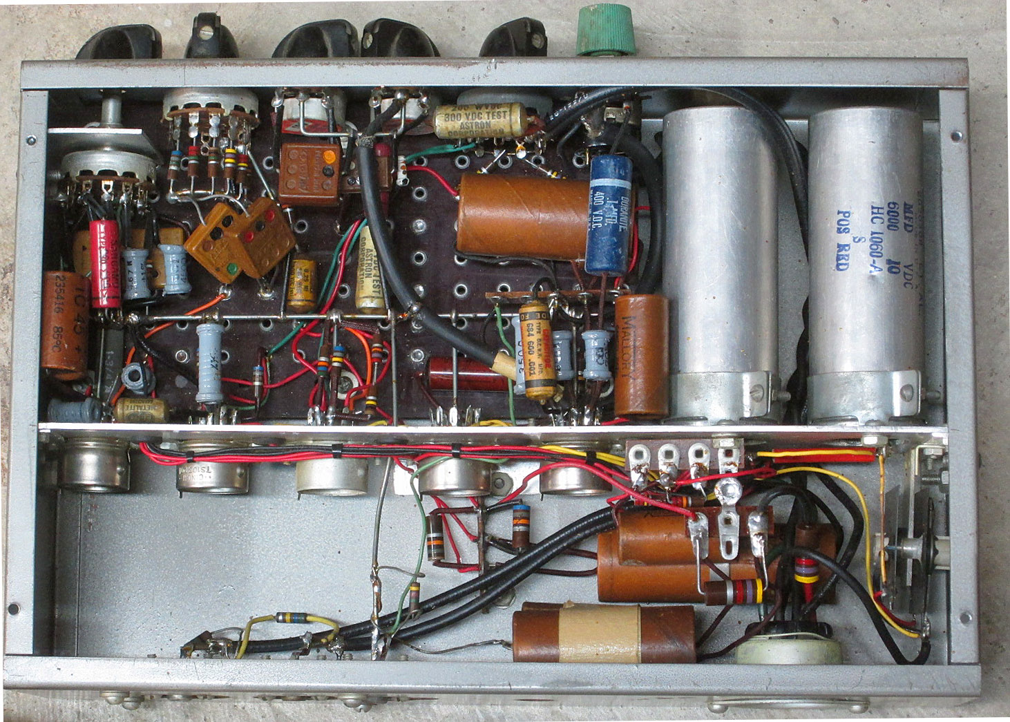

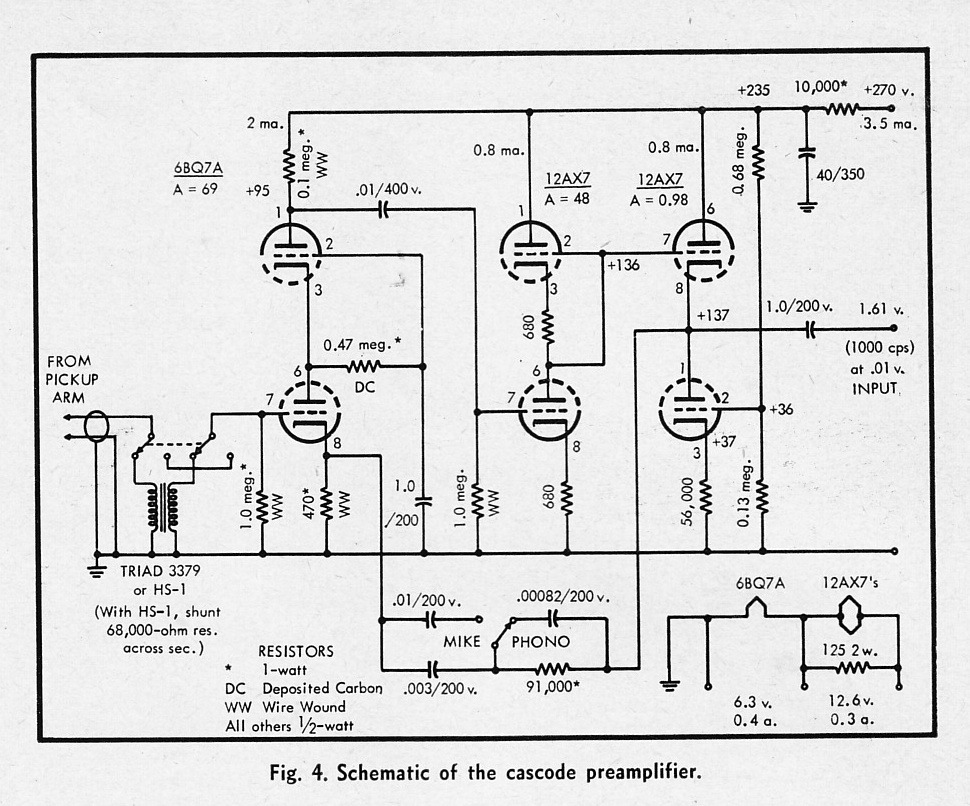

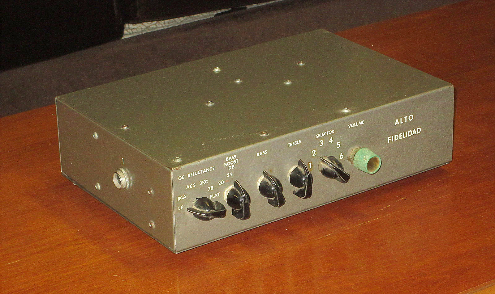

During the Golden Days of vacuum tube HIFI one of the most common pickups was the GE Variable Reluctance.
The mono vers was cheap & reliable. The stereo version not much good at all.
Hard for some now to believe, it was possible to get more than passable results from a 12AX7.
Better with a 12AY7 or EF86/Z729. Real low noise with a cascoded 6BQ7.
I built this one circa 1956 while working at the R&D Division of Ferranti.
Mine doesn't have the expensive Triad input transformer.
Used it for a few years, its still here on the shelf. 🙂
Yes they're in my HiFi book, section 6.3.Got any comparative measurements of D% to shew us? 🙂
