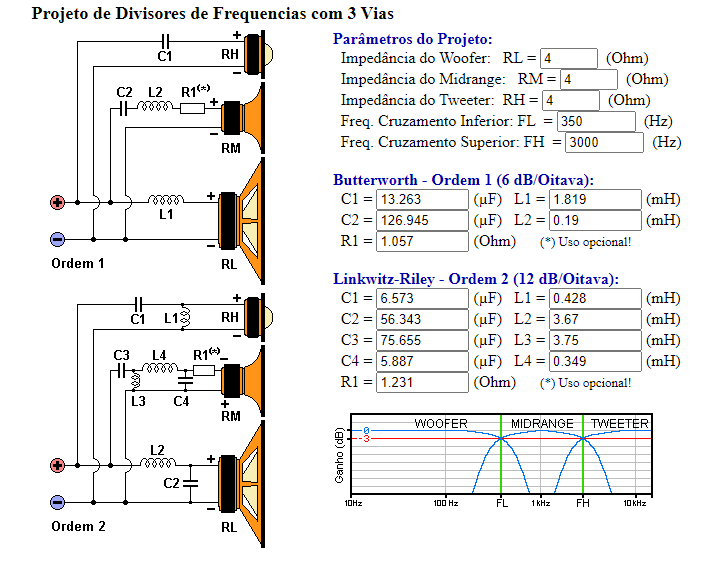

I was recommended by a friend to do a simulation through crossover simulation websites
I've never seen inductors with such small values
0.19 mH and 0.349 mH are not unusually small values to find in a loudspeaker crossover.
P.S. A "great crossover" is one tailored to match the individual characteristics of the drivers - something that is not achieved by using a crossover calculator such as the one above.

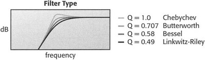

Step 1 is to understand what is meant by the 'Q' of the filter:
Filters with a high Q introduce 'ringing' which results in poor transient response.

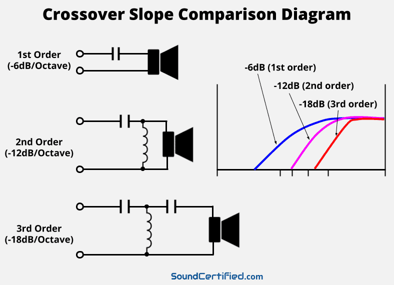

Step 2 is to understand the 'order' of a filter:
The order indicates the rate at which the unwanted portion of a driver's output is sloped off in order to integrate with the other drivers.

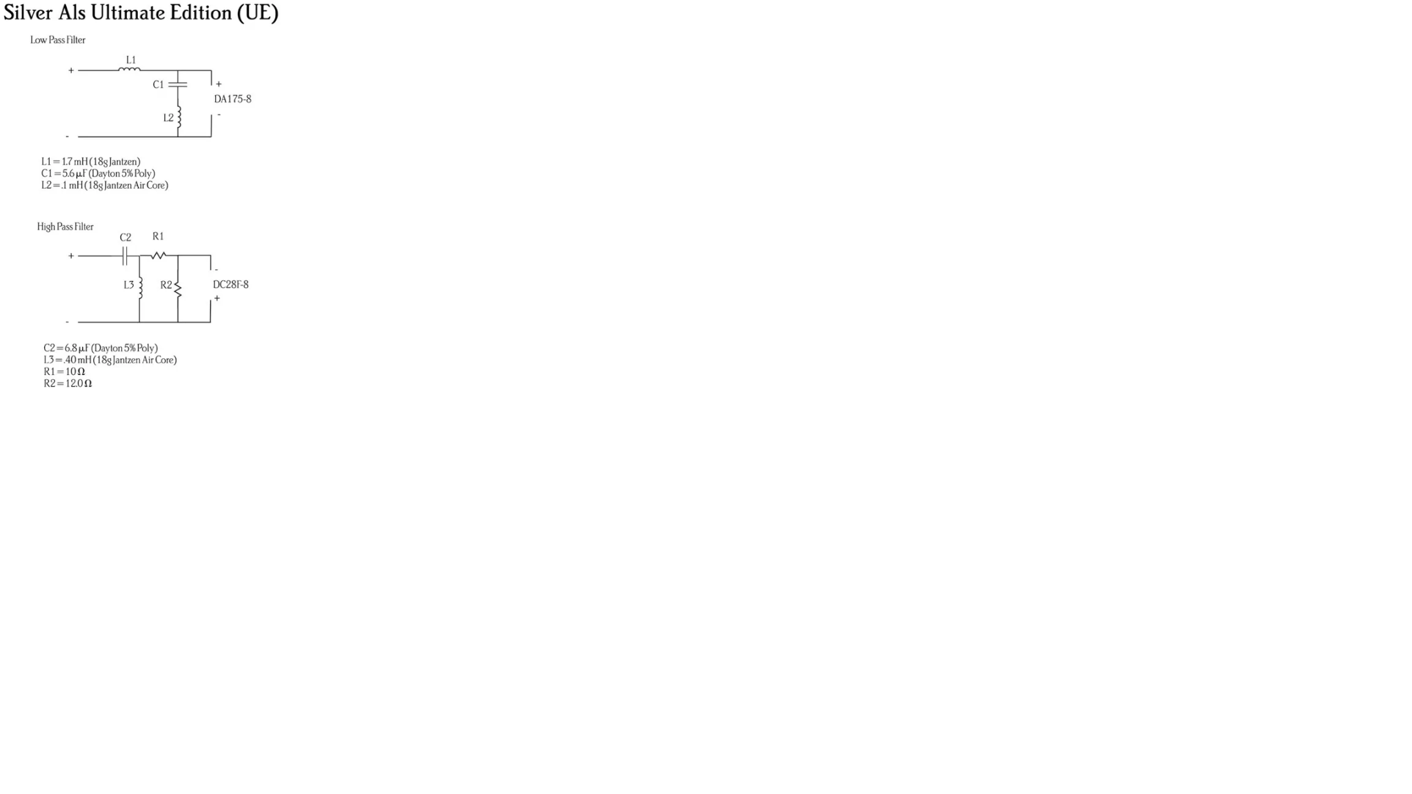

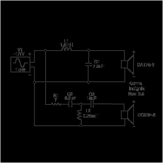

To use a simple example, here are two speakers - both apparently sound good - which use the same drivers: the Dayton DA175 and DC28F tweeter.
https://techtalk.parts-express.com/...53798-silver-al-redux?234654-Silver-Al-ReduX=
https://projectgallery.parts-express.com/speaker-projects/karma-indignia/
The crossovers are quite different.
I second Galu's comments about the sort of calculators to which you refer, they're not going to work. A crossover calculator wouldn't give either one of those speakers.
