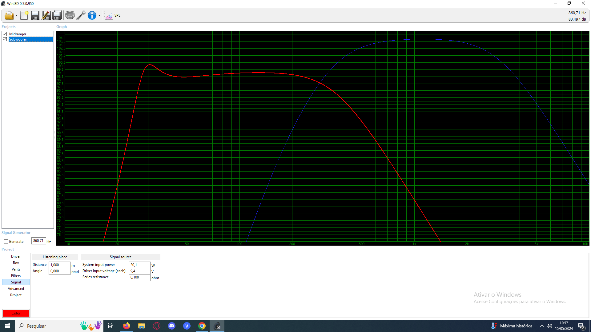

I'm studying winISD and I noticed that when I compare two drivers in the same project in winISD in the sound pressure tab (SPL), the sound pressure disparity is reasonably large and I would like to know how to improve this... I looked here on the forum and some websites that the use of resistors to reduce the power that would go to the driver in order to equalize the volume between them is totally reprehensible as it considerably ruins the sound quality, another solution that I was reading about was crossovers (which is the one I think about most). I was thinking about the work that I could also use to use equalizers to send more bass signal, for example, to the subwoofer or even reduce the signals from the midranger and tweeter, but thinking about it I think that wouldn't be a very good solution.

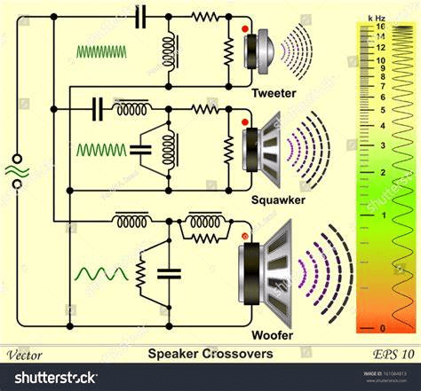

If a crossover schematic has already been decided upon then, in order not to upset the crossover function, the tweeter and the midrange should each be attenuated using two resistors in an L pad arrangement.
An L pad arrangement of series and parallel resistors is shown in front of both the tweeter and the midrange in the following schematic:
However, what you need to know is how to use software to design an integrated crossover/attenuation circuit from scratch.

padding a tweeter is pretty normal.
Dont care for magic " in the signal path" nonsense.
No need to pad midrange with driver choice.
Easy example is 12" woofer has way more senstivity
than a 3" around 6 dB or more
So easy to combine with baffle step losses.
WinIsd is just for theoretical transfer function of filter.
Not crossover design.
The woofer alignment shown is not a alignment
Pretty common for woofer to be 6 dB higher
than the midrange. Since your up against baffle step.
And expect to deal with up to 6 dB of losses.
Might as well start with drivers that have FRD files.
So you can get idea how speakers actually sum.
Winisd is just a quick reference to find box volume.
You hit .5 to .7 Qtc and there you go.
Nothing more to piddle around with.
Summing driver on and off axis
requires crossover designers software
and the baffle gets simulated in full space.
Which will include off axis information.
Winisd assumes Half Space.
You model in full space since the baffle provides
half space loading. And need to be aware of the baffle step
or stepped response that will happen.
Over to the speaker design experts!
The issue is that you would have to use the L-pad on the midranger and tweeter, both to attenuate and bring the woofer to the level.
