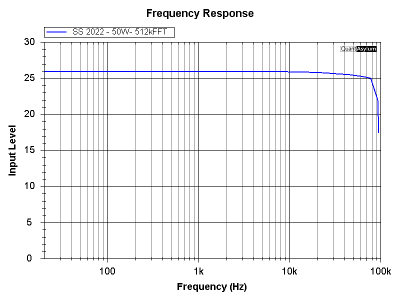

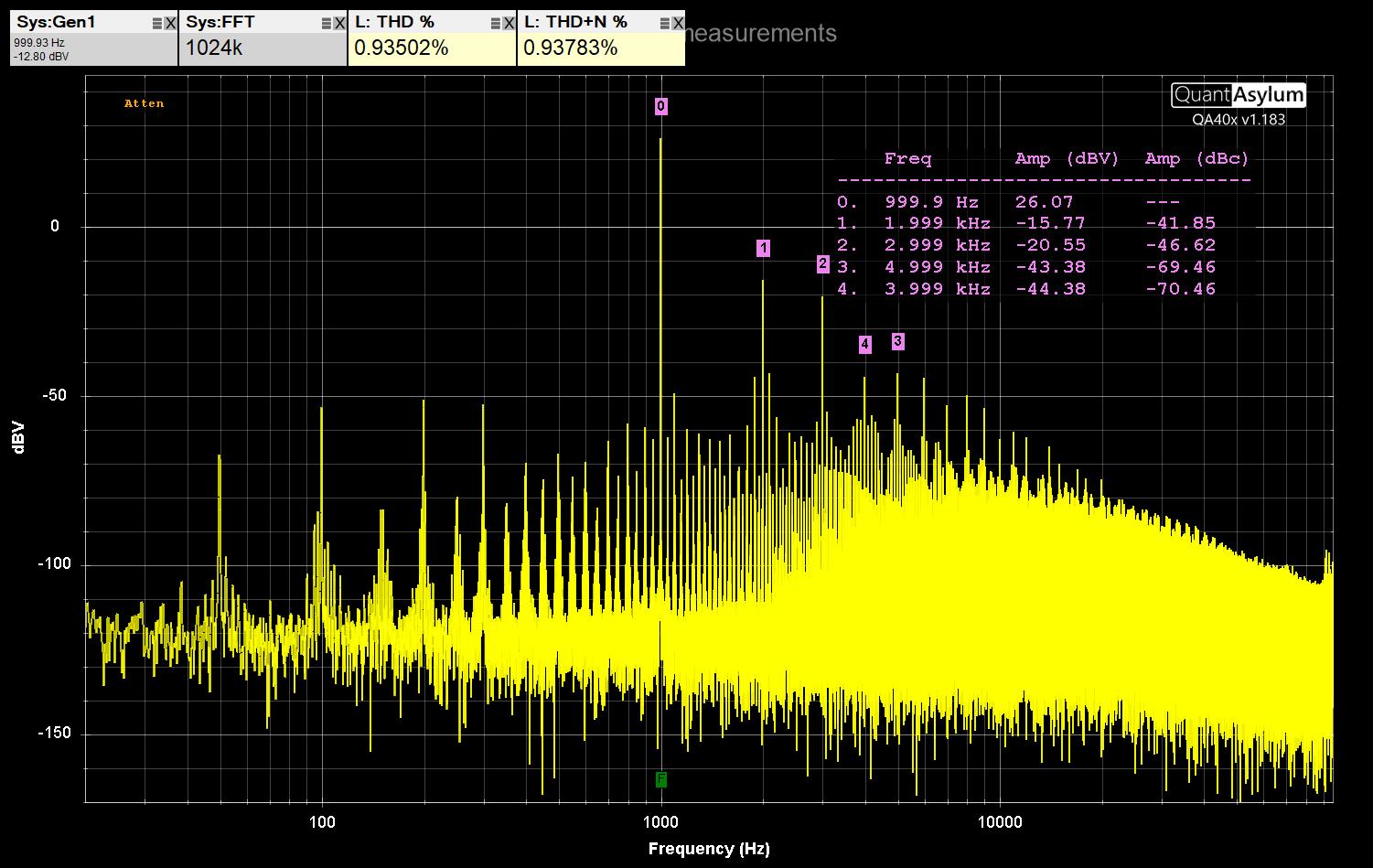

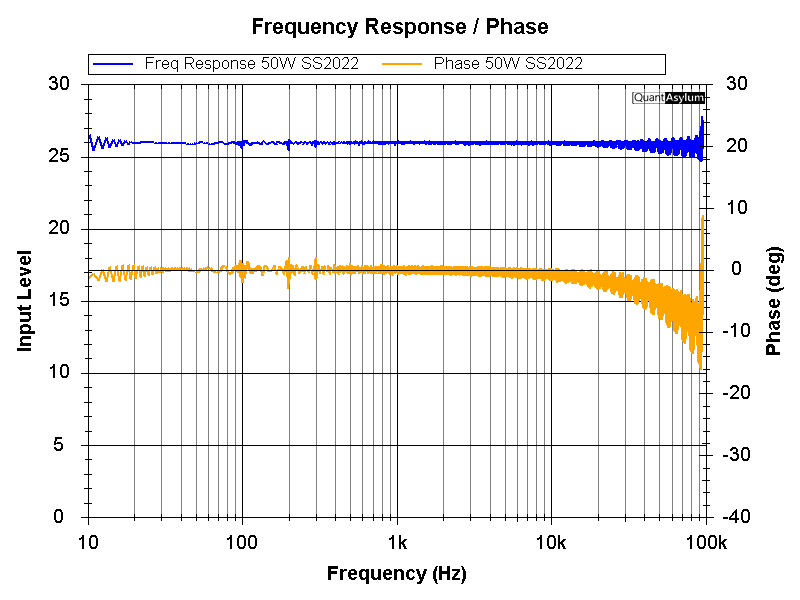

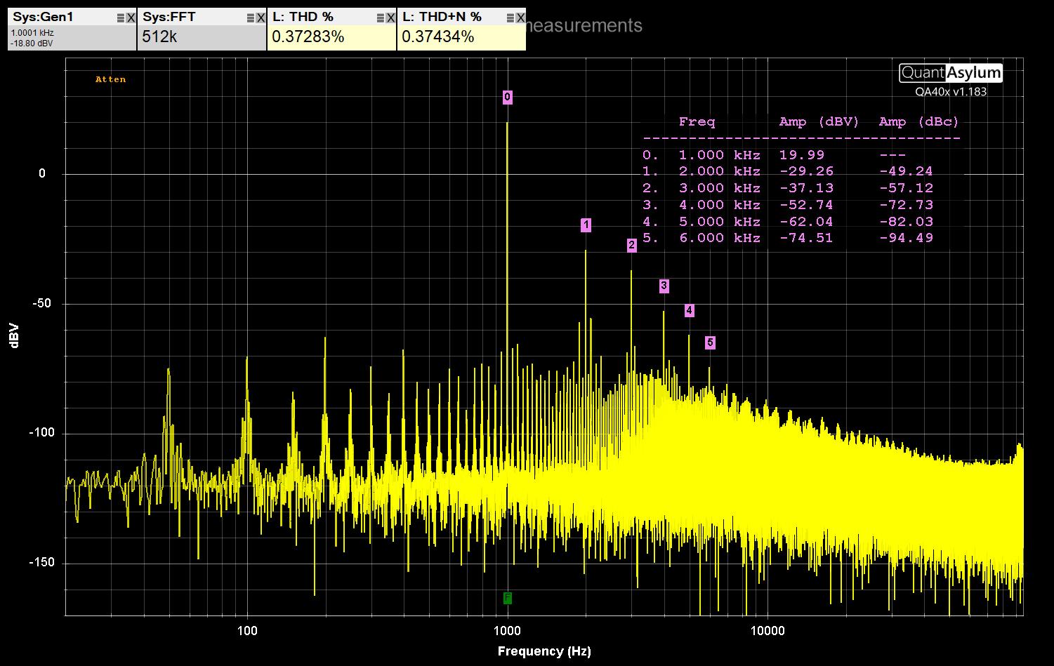

I have taken some measurements that I'd like to share. Note that I am measuring with a QuantAsylum QA403 and I have just started using it so I am getting to grips with it so take the results for what they are, I am not guaranteeing that they are correct. I am measuring using the amplifier balanced inputs. my amplifier has a 56k resistor in parallel to the negative feedback loop. Very nice linearity and harmonic decay. This amplifier sounds seriously good.
PS: the amplifier was loaded with a 8 ohm load. I am not sure that anything above 50kHz can be taken as gospel so please note.
Correct. After 20 khz the analyser starts losing a little gain due to the limitation of the ADC or anti aliasing filters. See https://forum.quantasylum.com/t/amp-frequency-response-test/941. Nevertheless, an impressive analyser given the relatively low cost. Importantly it allows me to check if I have made some mistakes during the assembly process.

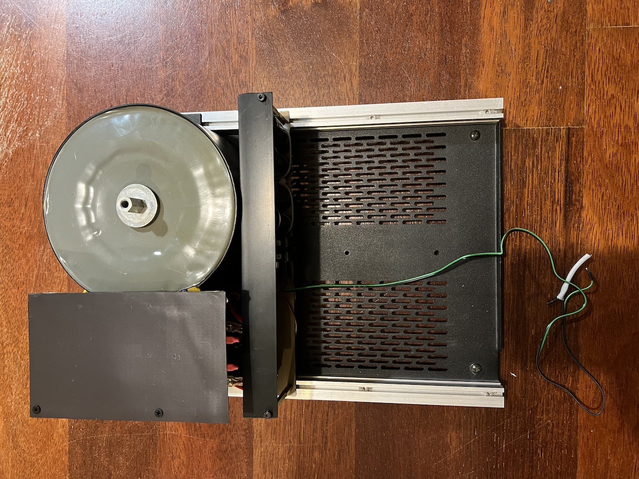

Soon my brother will receive the SS2022 that I made for him. Curious about his feedback, all -6dB of it (apologies for the bad joke)

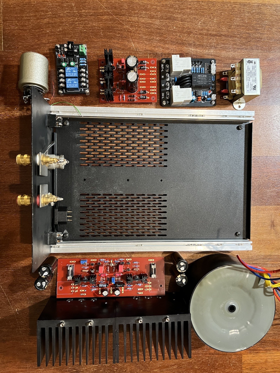

Now the second board and the hard work to put it into the cases.
900mA on idle, less than 6mV on outputs (a bit floating over temperature stabilisation)
grazie mille!!!

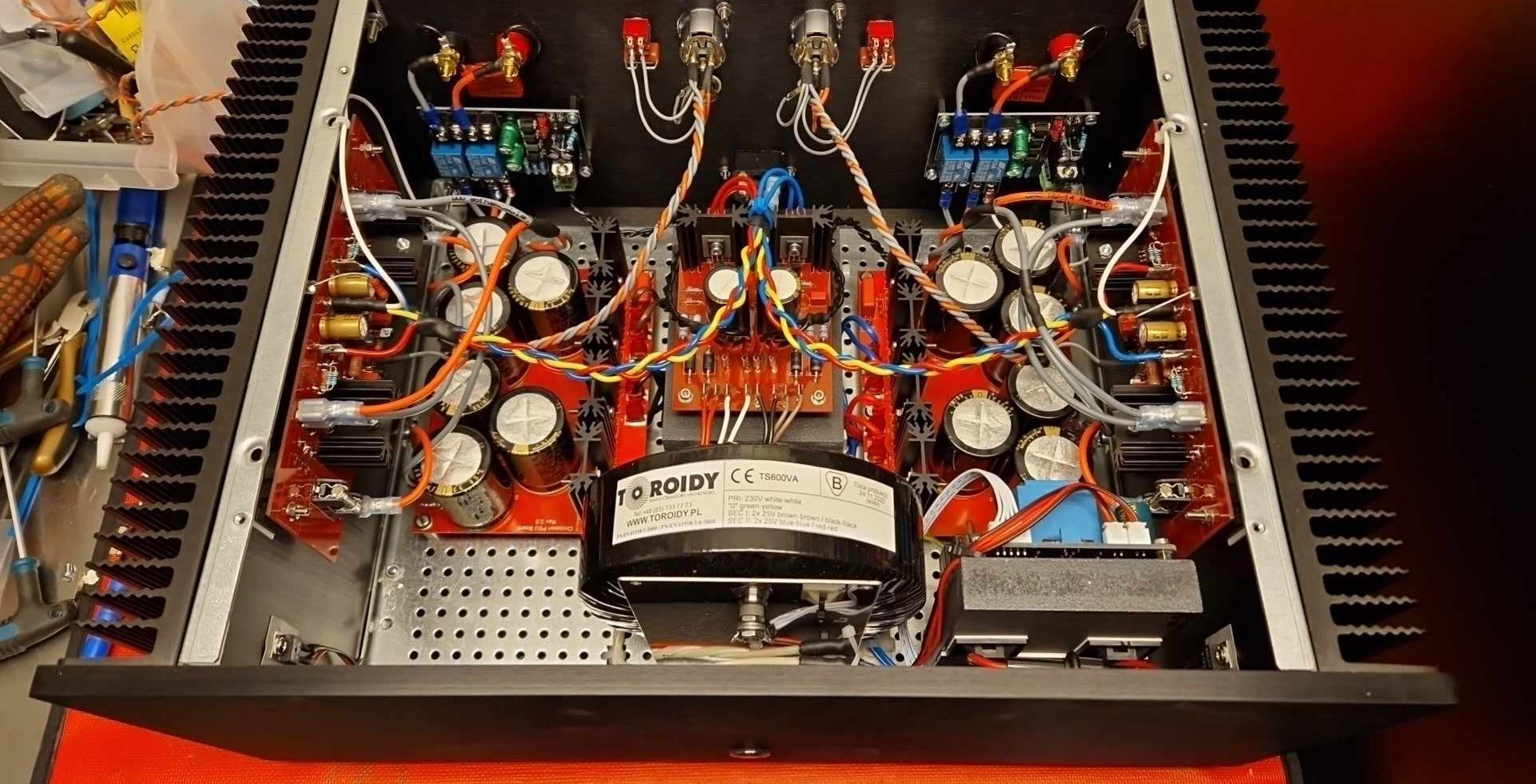

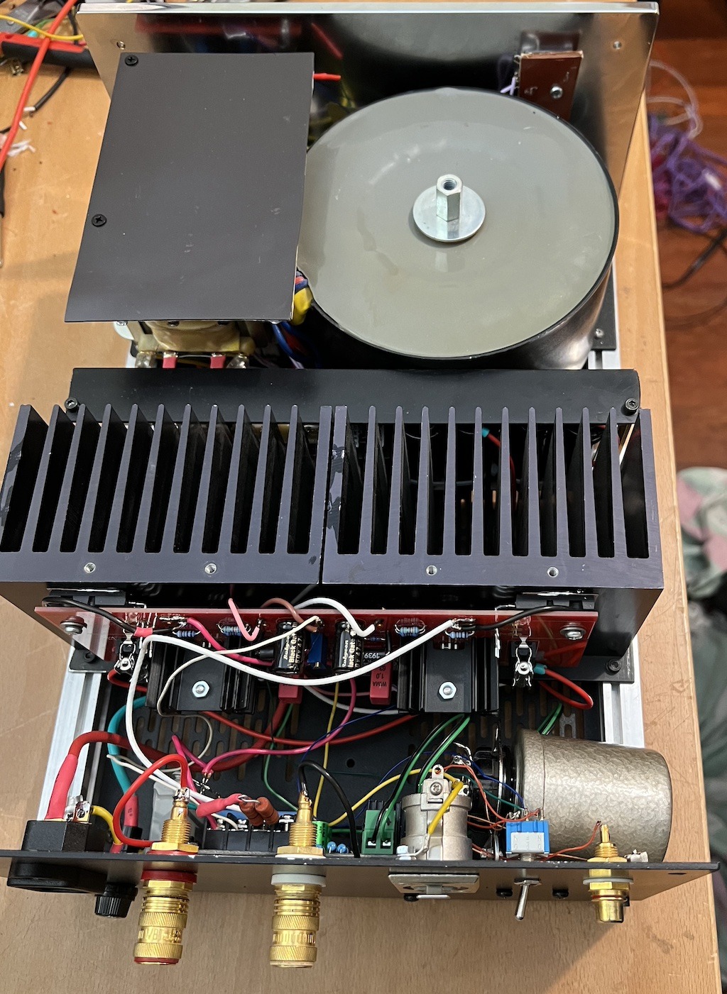

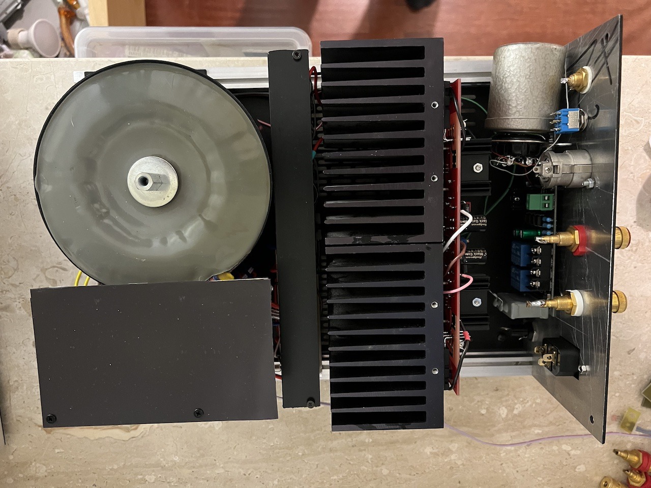

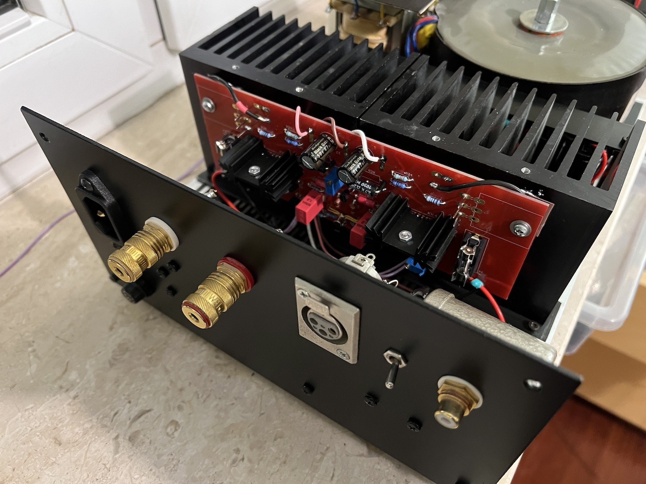

My build:
pair of monobloks, transformer on unbalanced input, LSK389 instead of pair of J113, the rest similar to the original design including soft start and DC protection. Lower voltage on end-stage, +/- 28,5 Volt.
Ugly cabling near rear panel, I know.

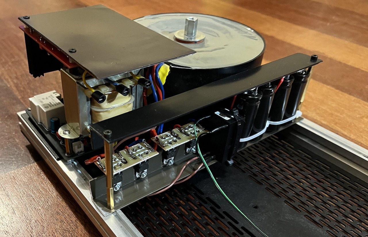

I have installed new PSU-boards with the MBR40250 Schottky diodes and 60.000uF per channel. See picture above.
Compared to my original build using traditional silicon recitifier bridges this verison with the schottkys sounds a lot smoother, more musical and there is no harshness whatsoever. This matches my system well since it is very neutral overall.
The main benefit using the rectifier bridges was the bass resolution and control. The bass performance with this configuration is probably the best I have ever heard in my life. If your system is overly smooth and forgiving this might be a very good choice.
