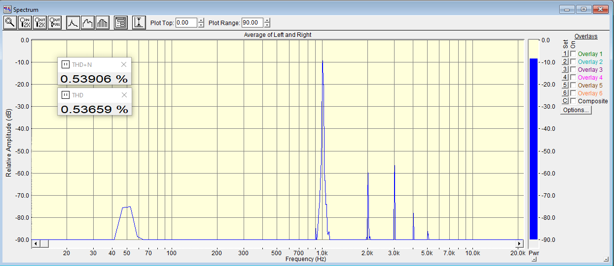

All those measurements with barely 60-70 dB dynamic range are pointless, they show absolutely nothing. All we know is that you have high distortion, we do not know if you have high order distortion components and we do not know if you have mains related hum components. The plots you show are in accordance with marketing plots in audio magazines.
Here the plot of thd at 18Vrms on 8ohm with -90dB
I agree...... I would say that if the majority of the THD is comprised of H2+H3+H4 (all musical) then the objectionable harmonics, H5 and beyond, are very, very small and therefore the amp should sound pretty good. The graph at #23 indicates that H5 and beyond are all below -77dB and the dominant harmonics are H2 and H3. They will mask the H5+H6+H7+..........+H20.

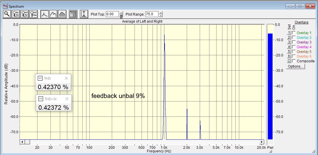

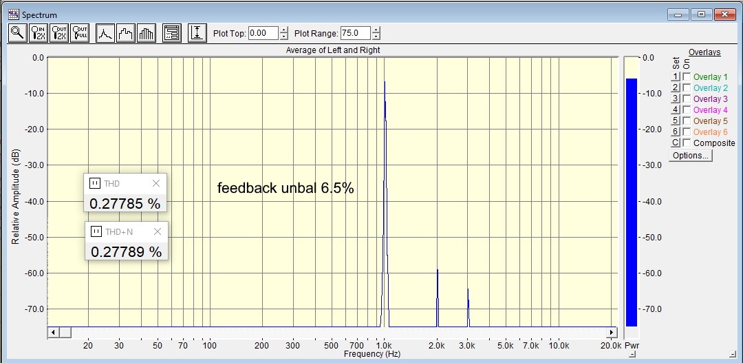

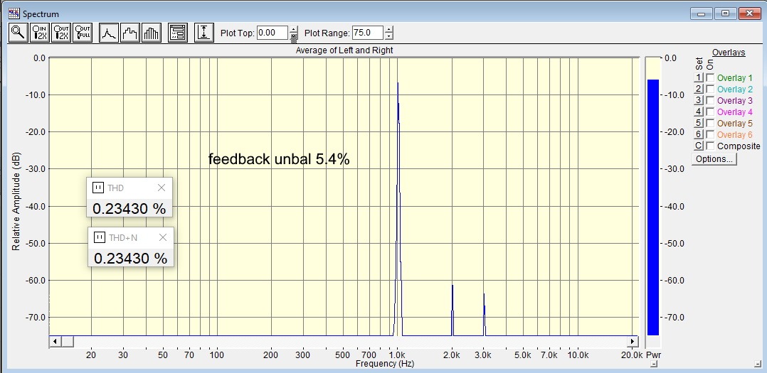

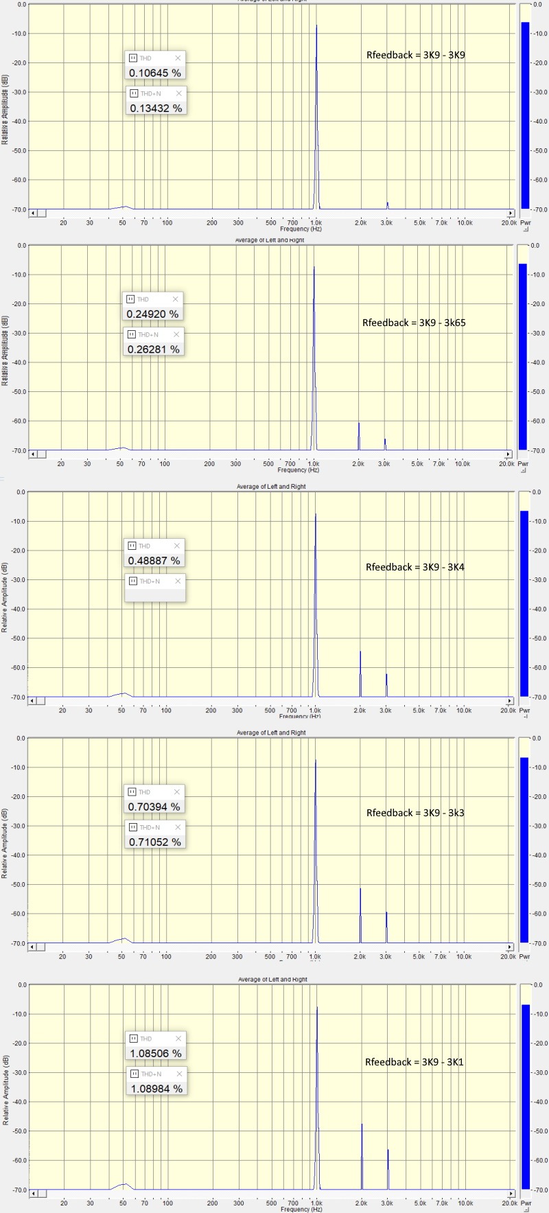

After the summer break I restarted the experiments on this amplifier and the listening tests with my friends.

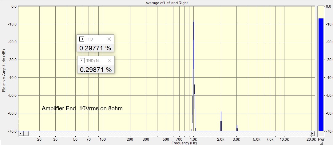

In a direct comparison with my Amplifier End which uses a tube as a voltage amplifier, an interstage transformer and the same output mosfets, the sound of this solid state amplifier remains more fatiguing.

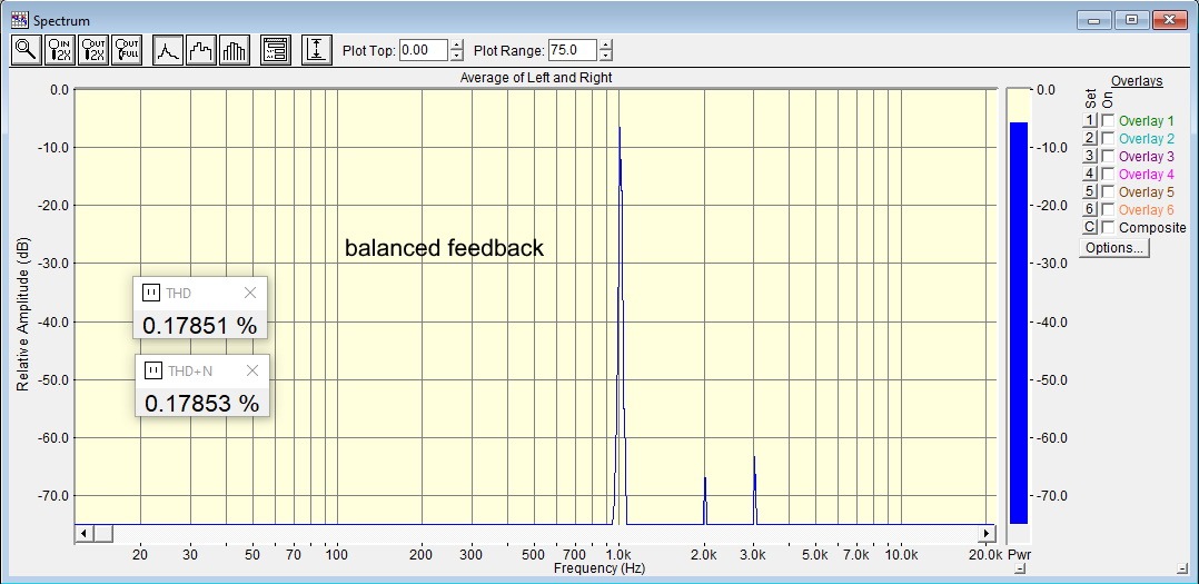

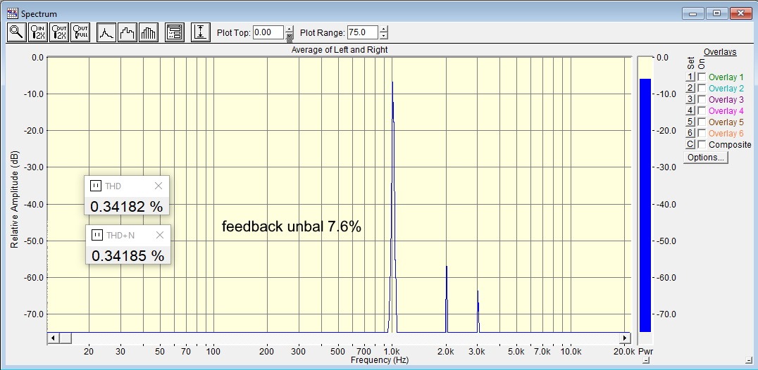

This sensation was not present in the prototype which did not have the selected fet but had a higher distortion so I tried to unbalance the 2 feedback resistors and I obtained the desired effect by increasing the second harmonic.
Follows the measurements with various values where it is verified that a small variation is enough by adding 56K in parallel to 3k9 (result 3K65) on the negative line and we obtain the same harmonic decay of the amplifer end and another listening pleasure.

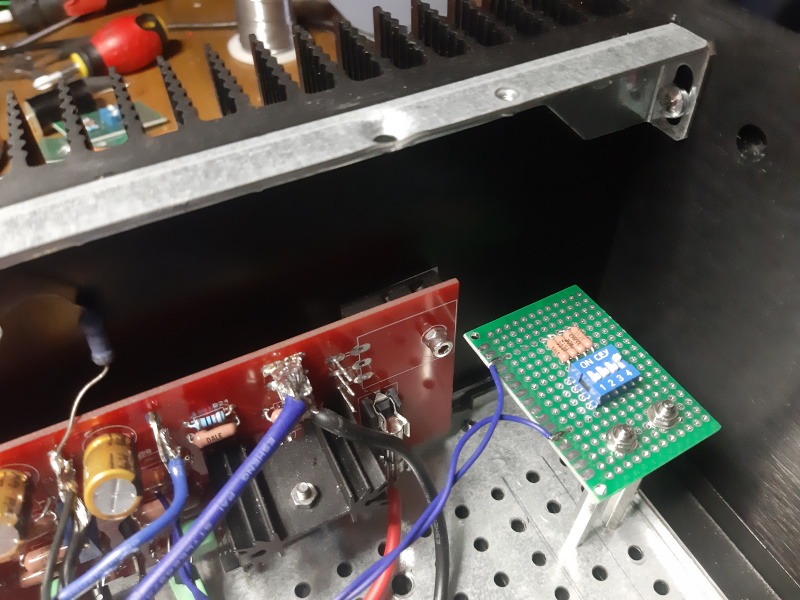

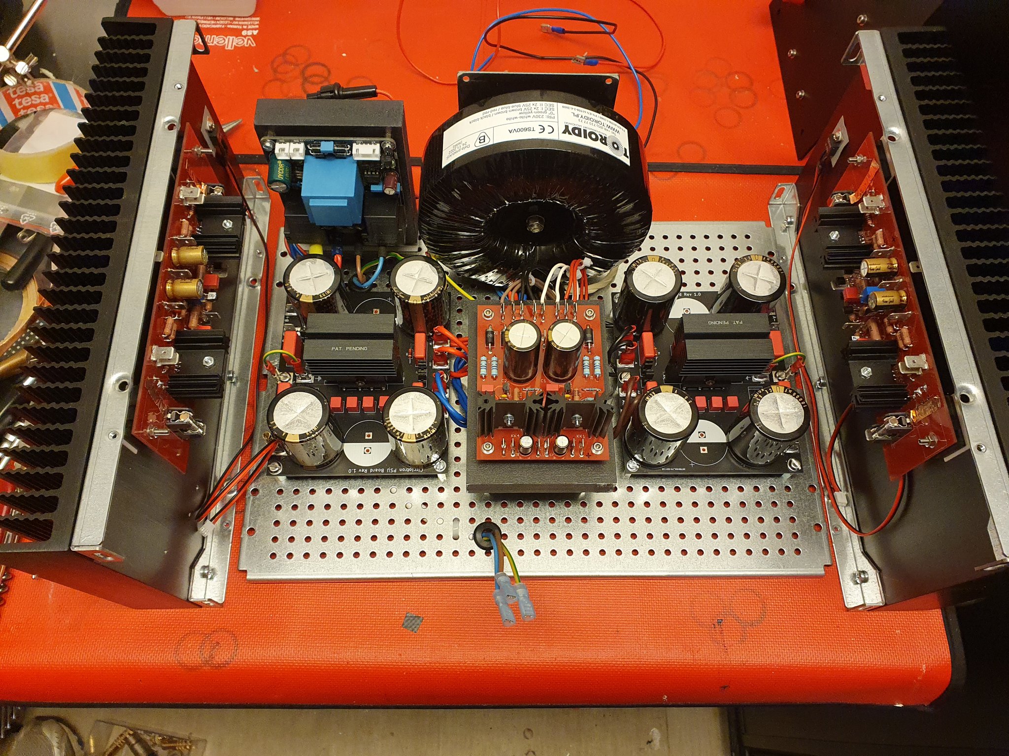

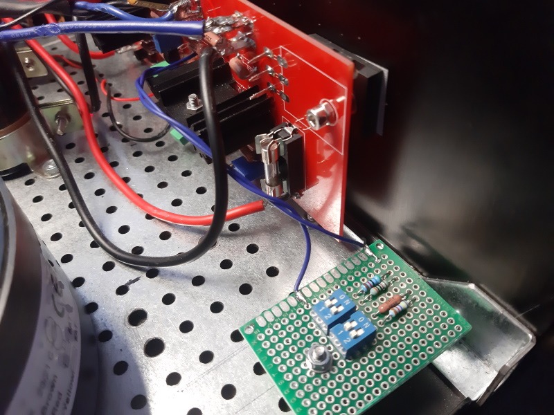

Hi guys,
I have come quite a long way with my build. All boards are tested OK. It is time for the final assembly phase. A friend of mine works as a senior PCB CAB engineer. He was kind enough to design a board for the output stage power supply. I could not source the schottky diodes needed for rectification so I choose to use a low voltage drop rectifier bridge from Vishay along with some snubber caps.
/Dominic
