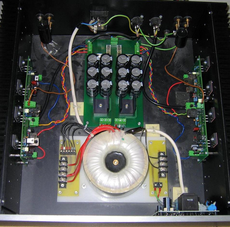

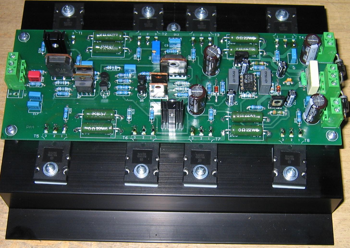

This is the functional sample built:
Pavel,
very nice!
Tell me is it possible to buy these cases, especially the top cover is very nice with lot of hole for air convection, that one would be very expensive if ordered from some company(?).
100 W trannies for M1, 2 was unexpected..
Cheers Michael
very nice!
Cheers Michael
of course they would, but not many specify a 100W FET for a VAS stage.They would withstand 100mA without any problem,,
I am referring to a more normal 5W to 7W BJT for the VAS stage, and said as much in my reply. That cannot pass 100mA bias and withstand +-50Vdc supply rails.

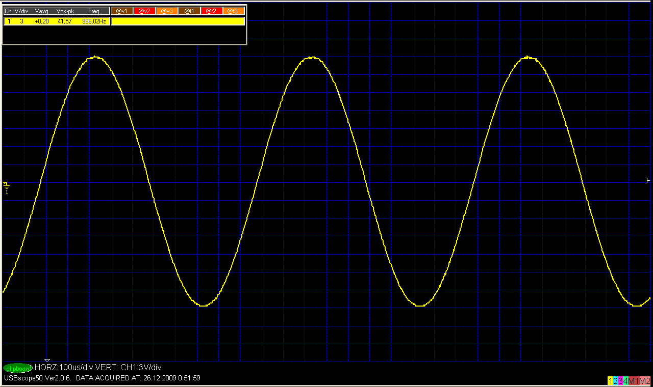

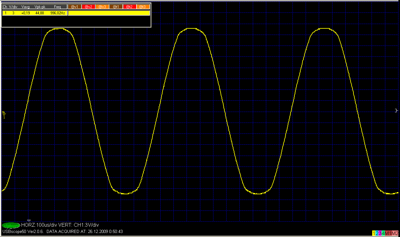

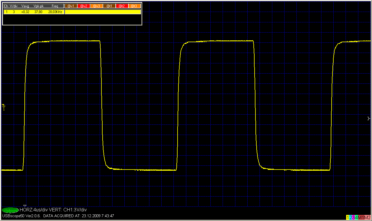

It might be interesting to show how the amplifier works under clipping conditions. The amp is supplied by 2 x 27.5V PSU and loaded by 4ohm. 1st screenshot shows undistorted output swing, and the second shows clipping. One may see that the clipping is soft, and if it happens, it does not create the typical harsh clipping sound.
The clipping behaviour is doubted by some as unimportant. This may be true when they listen to highly compressed music.

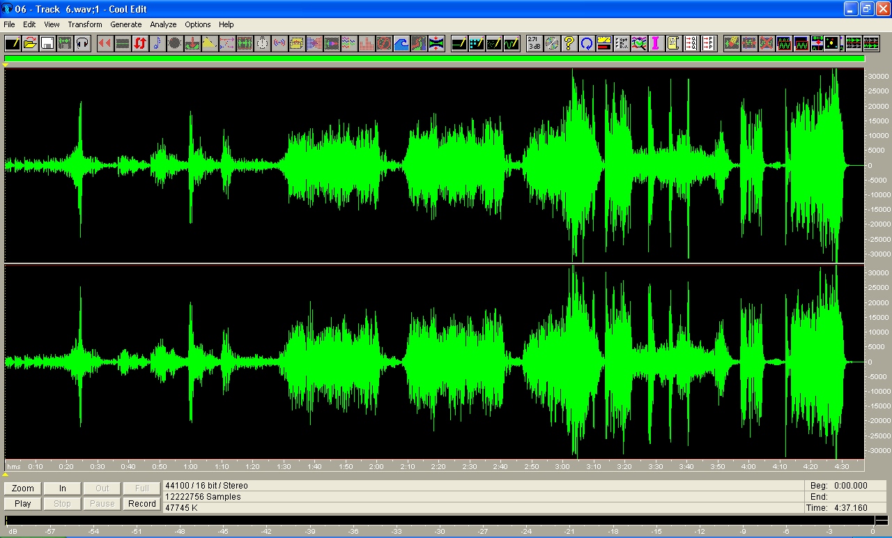

Excellent recordings of classical music, like Telarc e.g., have often very high dynamic range, long silent parts followed by dynamic booms. In this case, amplifier may very easily get clipped, especially with less sensitive speakers. Example of such recording is Telarc CD-80271, Berlioz - Symphonie Fantastique, Marche to the Scaffold - have a look at the image.
I know exactly what you mean... I listen exclusively to Classical (haven't that recording version though) and it's surprising when you scope across speakers just what the peaks can be.
Have you ever tried... for listening of course, not specifications... adding a series output resistor in the 0.22 to 0.47 range.
I used to use Celestion SL6's (82db 1watt) and getting 40 volts or so peak across the speaker was easily achieved on classical even though the average power was far far lower. Since use larger floorstanders at around 92db/watt... folk don't understand speaker efficiency makes far more of a difference than changing from a 20 or 30 watt amp to a 100 watt.
I have Mozart piano sonatas (Andras Shiff... old London Label) on CD with some real "infra bass" on it... very surprising.
