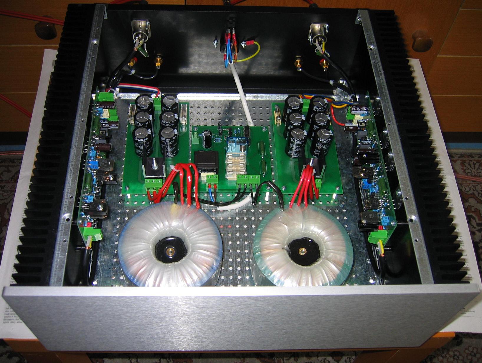

Current status - I get 180W/8R and 300W/4R from this amp with 4pairs ouf output devices.

Bobodioulasso - this has been a prototype evaluation (just measurements). I am going to build the amplifier in a 4U, 440 x 400 mm box, as a dual mono. I hope to have finished this in about 2 months, and then I can say more about audible differences between smaller and bigger version.

I know that designing a beautiful layout like yours can take 40-50 hours or more of intensive work at the CAD program. It requires great commitment and for many is dull work. You are unusual in that you have such strong technical insights but you do a beautiful, almost aesthetic layout job. I have a crazy notion that such care does improve the sound, but I could well be wrong.
Why such a tall box, 176mm is REALLY tall, would not 3U offer sufficient radiating area?

Regarding 4U box, distance (height) between top and bottom edge of power transistors is more than 125mm. This might just fit into 3U, but ....
Supply voltage is 2 x 59V at idle, falling to some 2 x 55V at full load and power. There are 4 pairs of output devices, each biased at 25mV Re (0R22) voltage drop, i.e. 114mA / 1pair. The idle current per one channel is about 450mA. This, at 118V supply, results in 53W of idle power dissipation per channel, so large and efficient heatsinks are required.

I also had quite some thermal issues to deal with - 5 pairs also at 25mV/0.22 Re. You need a big heatsink (I am using Fischer 4U case - same one I asked you about Pavel)

Idle current is more than 0,5A, so I dissipate more than 60W per channel at idle. Due to large heatsinks, it makes no problem. Also, a longterm test at 30% and 50% of rated power is possible, thanks to the construction and large heatsinks. The output power I spoke about is not only a short time power.
