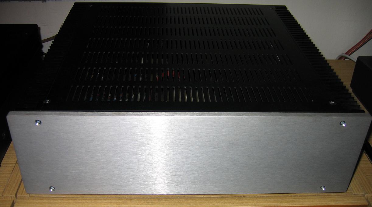

Andrew,
you would find the VAS transistors used here:
PA2 power amplifier
They would withstand 100mA without any problem, just small heatsink needed.
PA2 power amplifier
