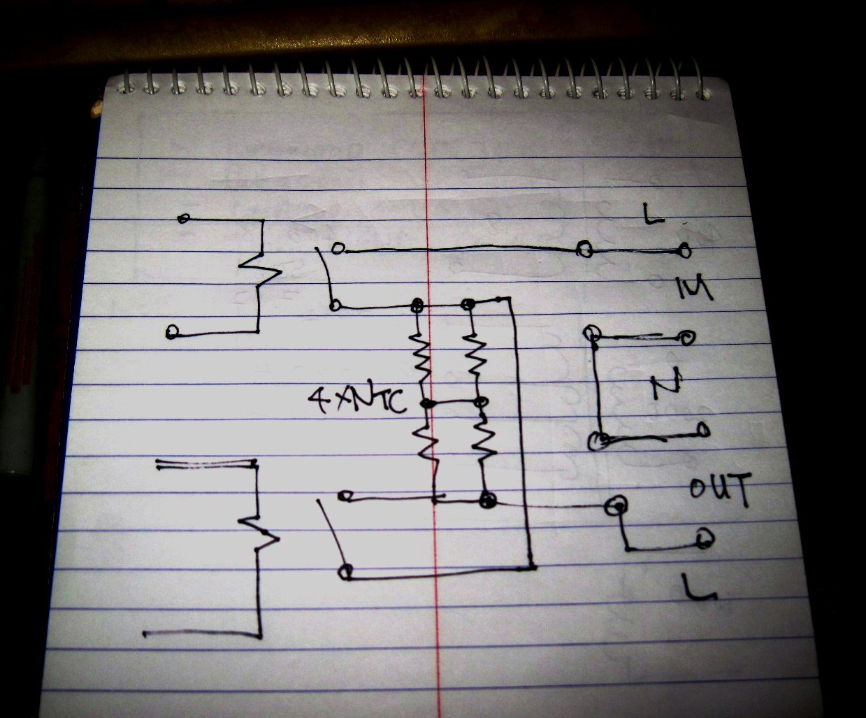

in your ebay board one relay shorts out a bank of NTC's
while another relay opens the circuit in case of thermal overload,
this is the reason for two relays...2 heat sensors one for each channel
sink....
so one relay is operated normally open while the other is normally closed
found this in the net.....the difference is there is a delay from the time you push the switch, about a second, to the closing of the normally open relay....almost instantaneous.....
the unit is wired this way.....

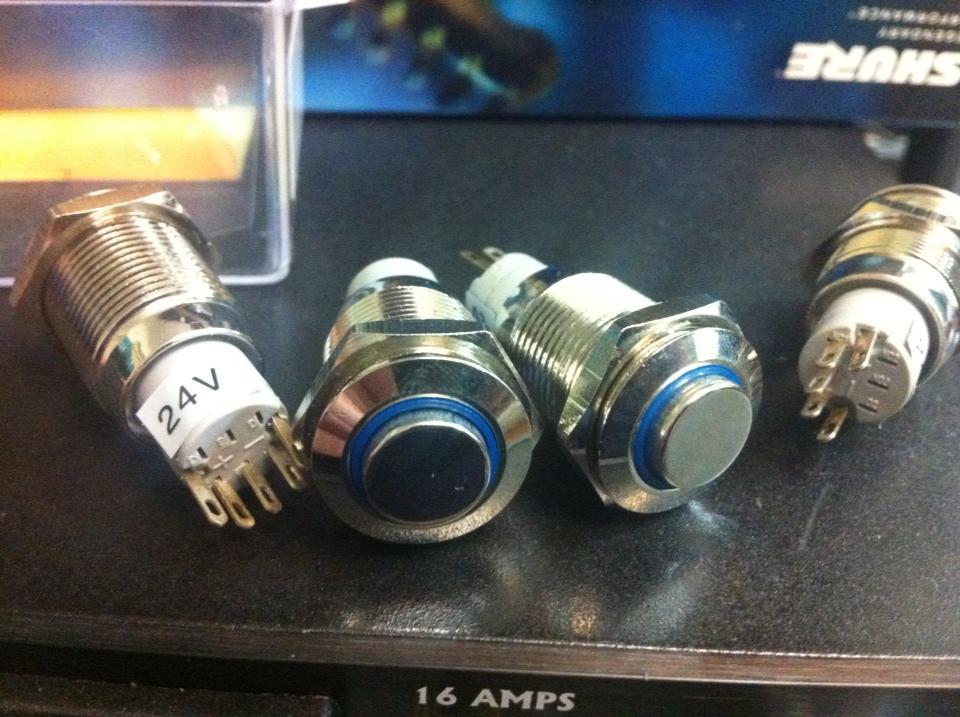

I would also as a safety precaution make sure that the momentary contacts are isolated from the mains. Is that a mains transformer in the middle powering it all ?
with isolation transformer used, the momentary, normally open switch is in no danger of causing shocks......i have some....
Its a while since I posted that 🙂
I seem to recall just needing to be sure the OP's board was fully isolated with there being no circuit diagram shown. Those are quite good switches, officially anti vandal proof I think 😀 The illuminated ones are great.

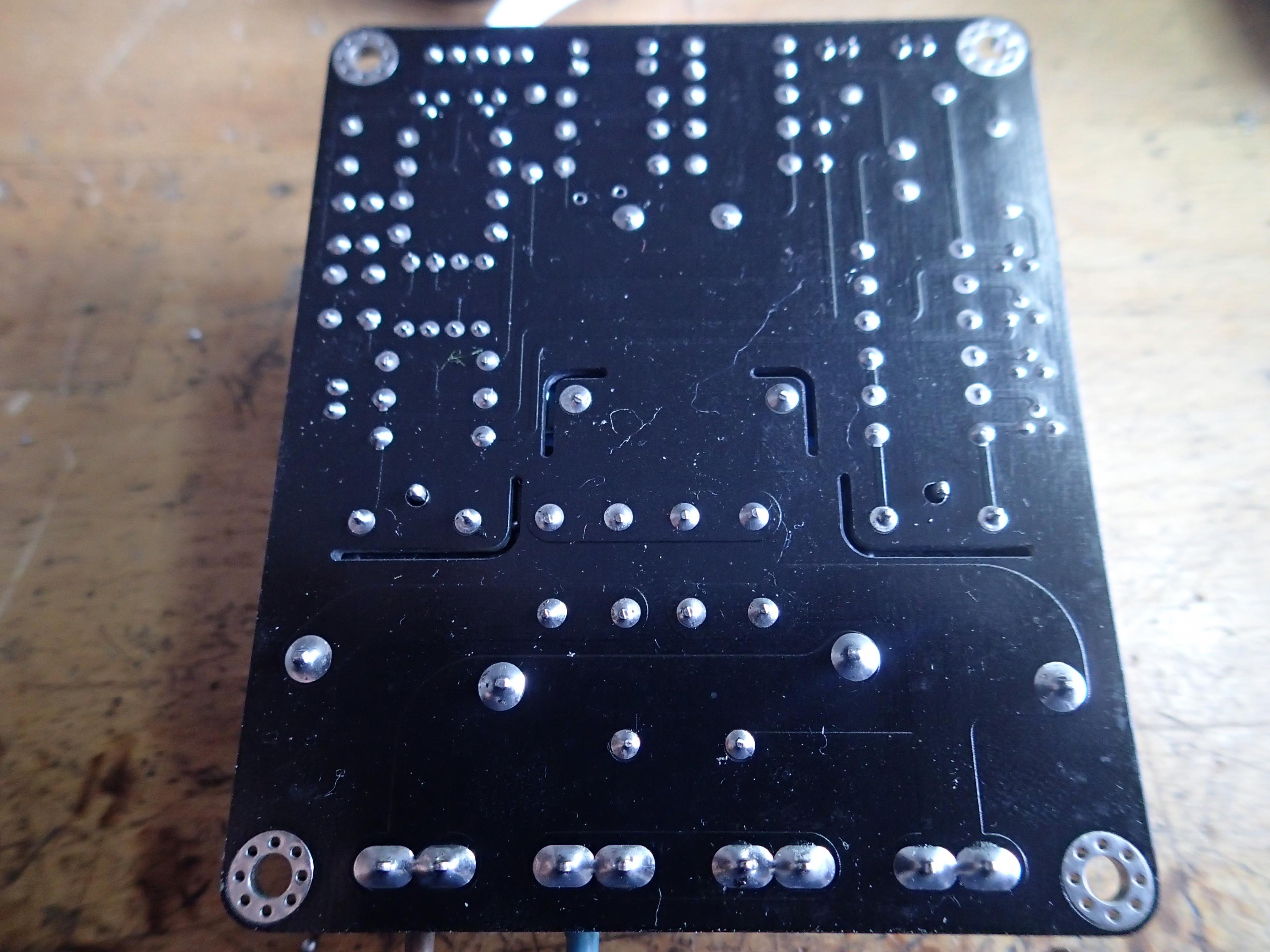

That means the connections are wrong, or that the added resistances have failed to zero ohms, or the bypassing relay is welded closed.
You will have to look under the PCB and see where the Live traces go. They should pass through the added resistances.

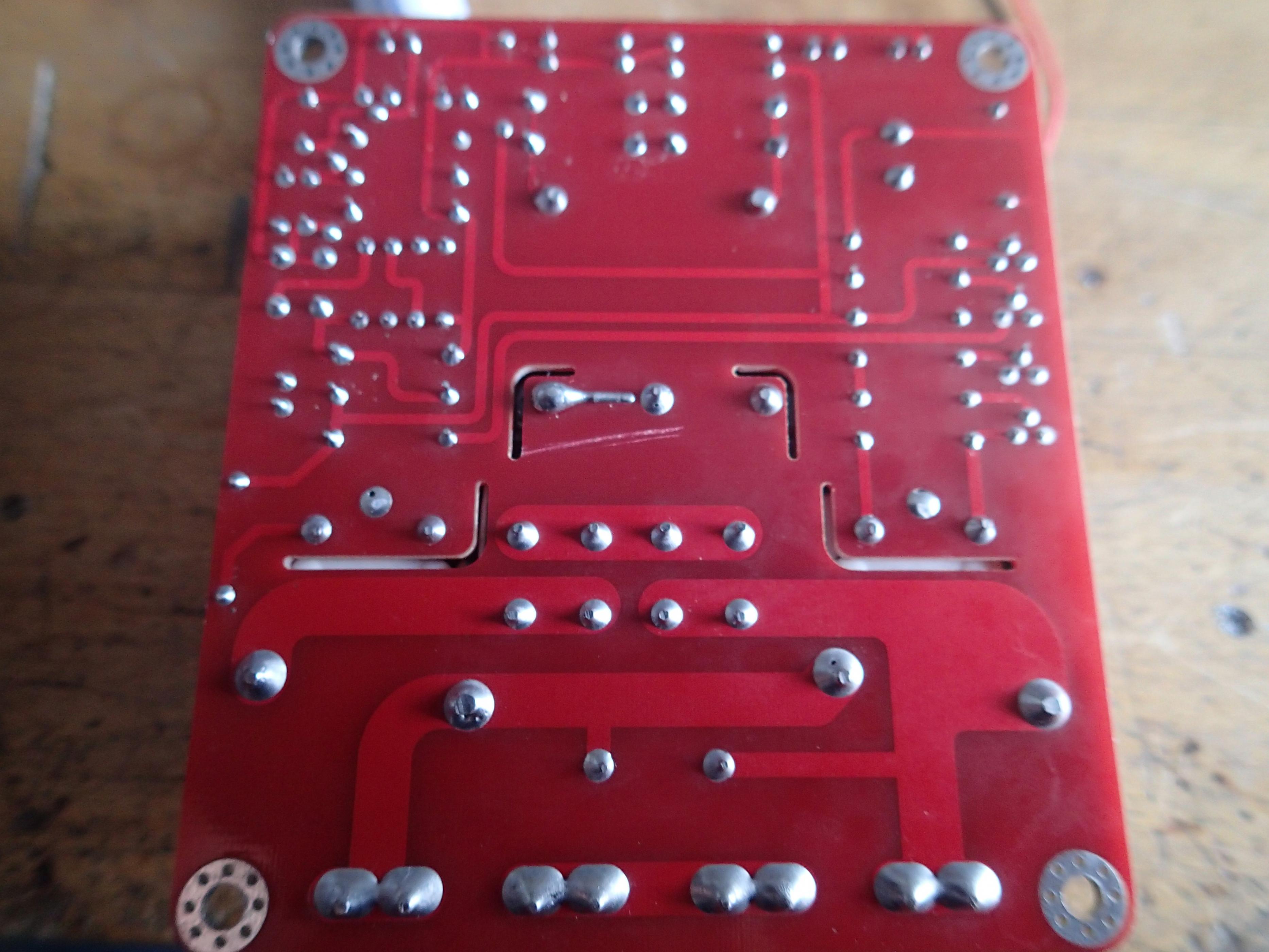

The first photo is from the copperside of the "first" unit identical to the photo brought in the first post in this thread. Why this unit stopped to function after beeing connected to the transformer/powerbank of V3(Aleph J), I have no idea.
The second and third photo is the "newer version" taken from both sides. All measurement I brought in post 24 is taken from this unit(black).
The reason that resistance between the two L terminals = 0 ohm, is that they are connected to the same pad on the PCB

Have you studied the photos of the copper side. Did the photos "clear up" how this slow start work?
I have worked with other other soft starts before, but they cut 230V AC when the main switch is OFF,but with this unit 230 V AC can be measured on both 220V in and out all the time.

Yes, I use a momentary swicth exactly like those you show in your picture.

this is the power line side arrangement in your board,
it will show you how soft start is implemented....
so two relays operate in sequence,
when powering up, one after the other....
but when powering down, they turn off at the same time,
same with thermal cut-off, when preset temp is
detected, the 555 timer is toggled off...
two relays are de-energized....
