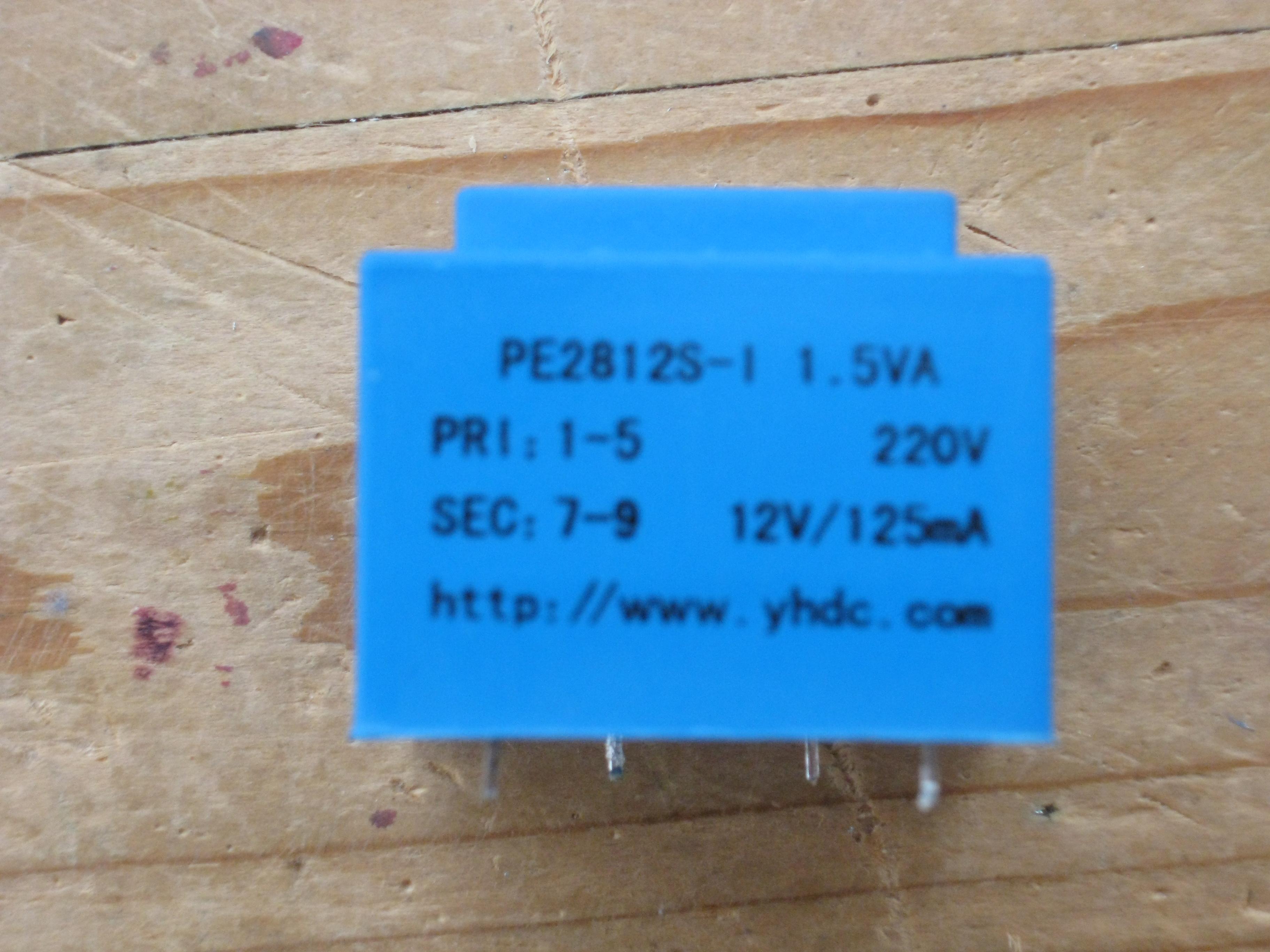

I have one of these boards, I saw this thread and finally got around to trying mine. I think there is a problem.
As with the black board Liliya was asking about;
With all IO disconnected and testing between the two outer (relay switched) 220V neutral IO terminals = O.L (open circuit). Then testing between the inner two 220V Live IO terminals = 0.01 ohms, they are directly connected. Finally testing between each of the neutral and live terminals = O.L (open circuit).
With power off, the 220V in and the LED-low voltage switch connected I see the same results as with all IO disconnected.
With power on, the 220V in and LED-low voltage switch connected and low voltage switch deactivated I got 238V on both the high voltage input and output. Then power on, 220V in, LED-low voltage switch connected, and with low voltage switch activated I also got 238V on both the high voltage input and output.
However, with power on, 220V input and output connected to a toroidal transformer, the LED-low voltage switch connected but deactivated the output dropped to 108V.
Finally, the same configuration, this time with the low voltage switch activated I got 238V on both the high voltage input and output.
It looks like the relay switching thermistor circuit is working but when the unit is switched off there is still a circuit between the 220V IOs which shows as 238V but drops to 108V when there is a load on the output.

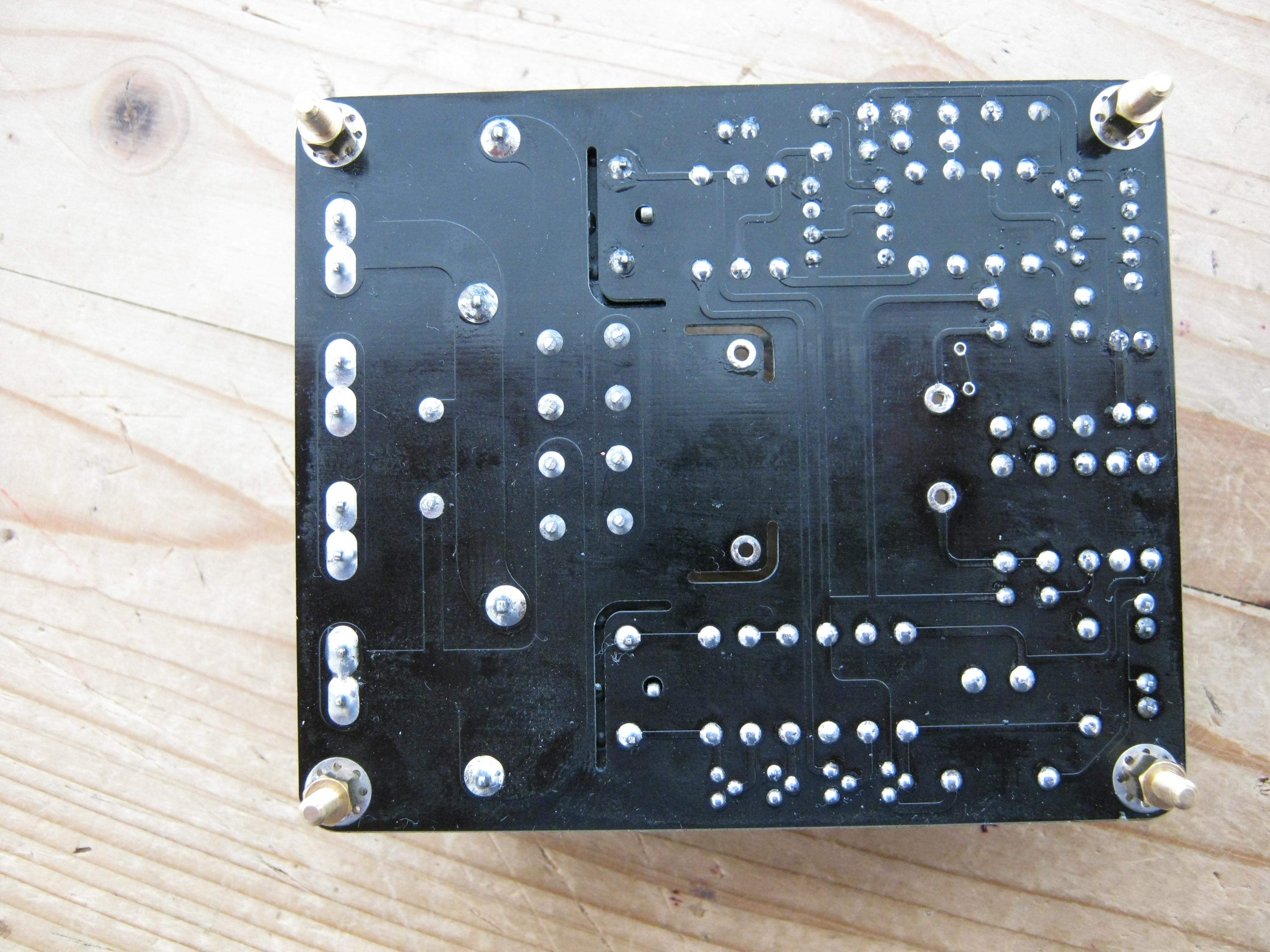

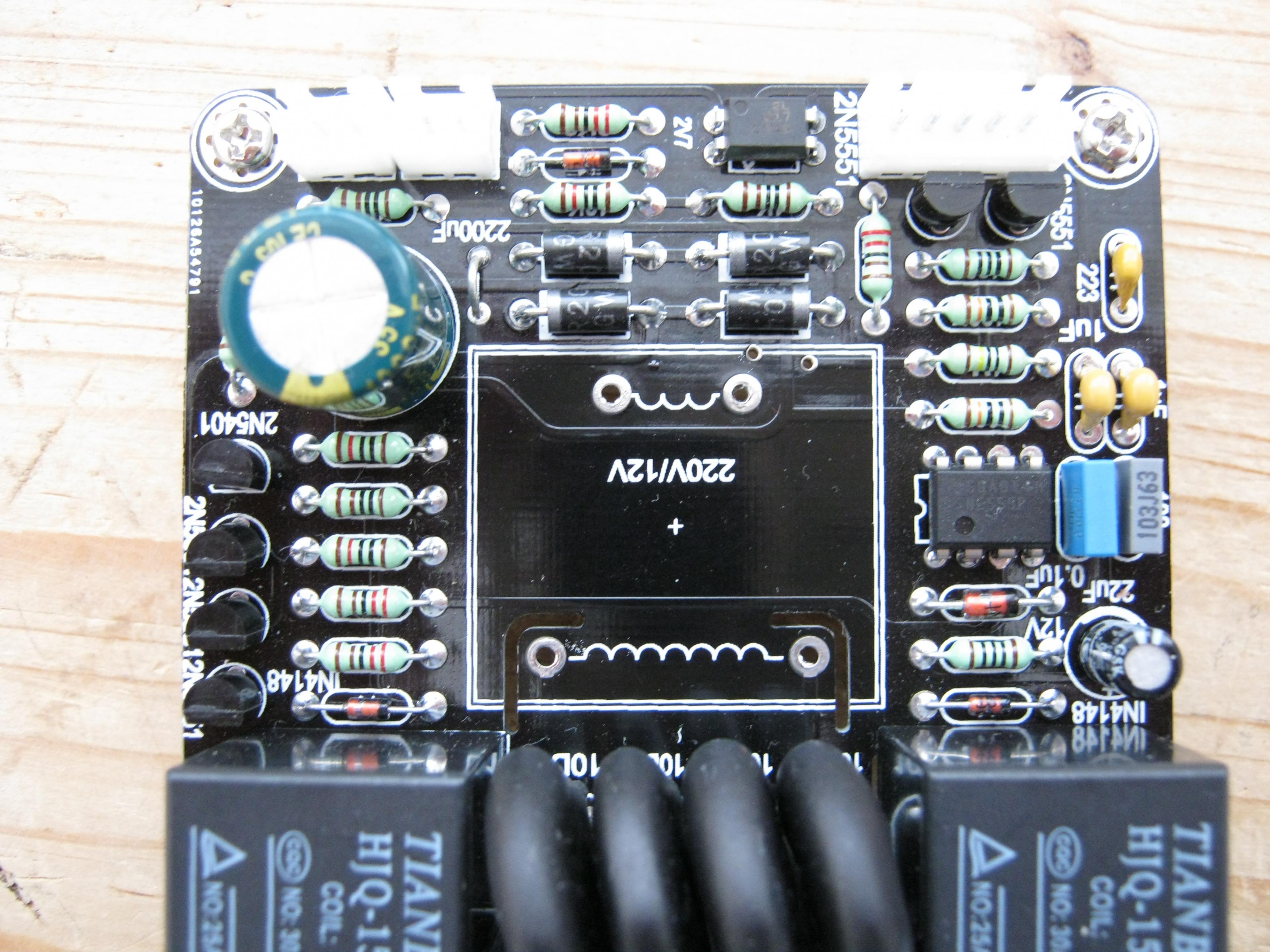

As far as I can tell the relay-thermistor circuit looks correct. However, looking at the pcb I can only find 2 other ways power could flow from the input to the output when the relays are deactivated. The first are the transformer 220V + - traces, I took the transformer off and checked the traces, all appears to be good.

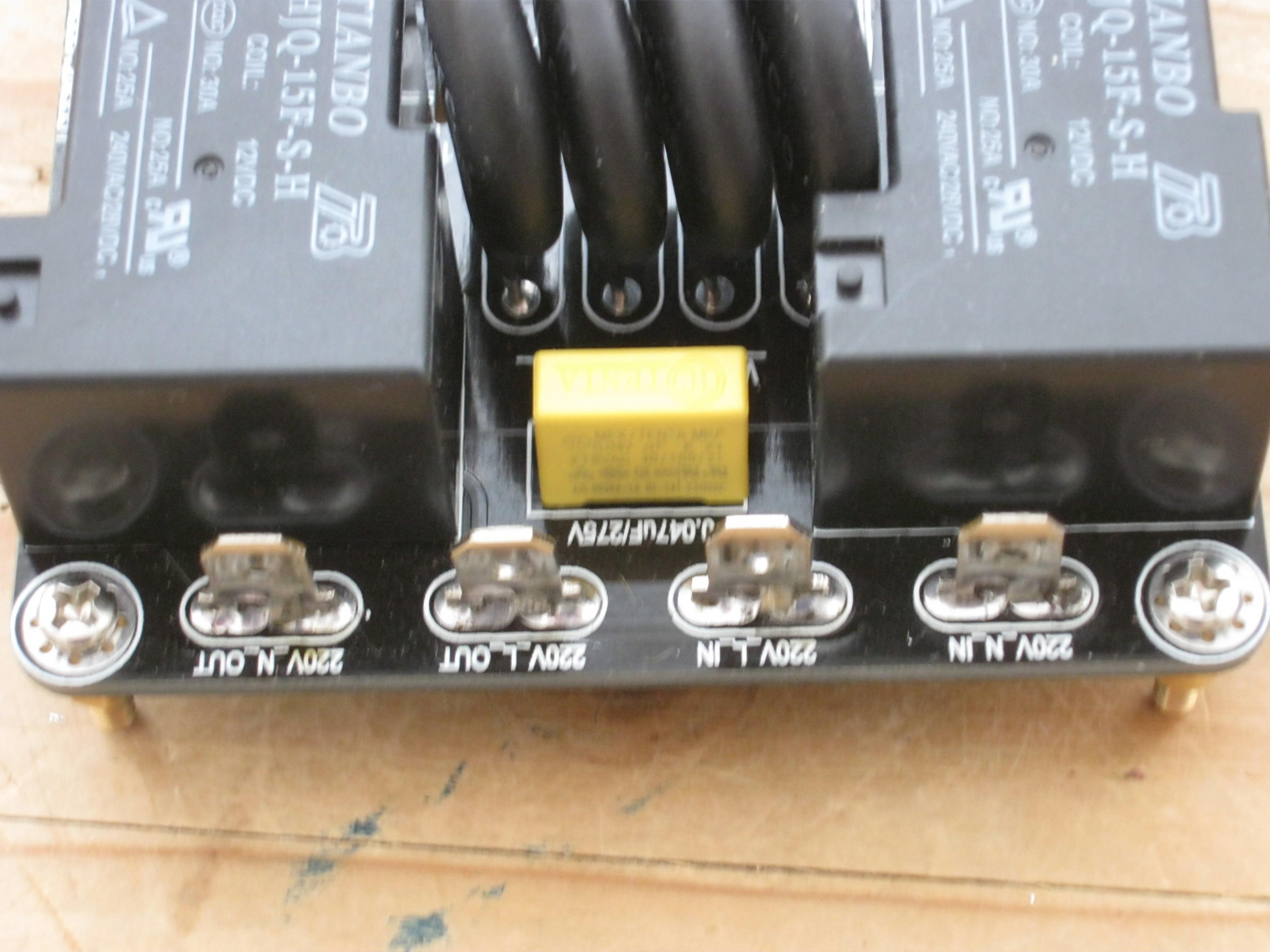

The second is the small yellow capacitor situated between the relays on the 220v IO end of the board. It is a MKP X2 0.047uF 275V ac cap and is positioned across the (relay switched) 220V neutral in and out terminals. MKP X2 capacitor 0.047uF/275VAC, View X2 0.047uF, TENTA (TC) Product Details from TENTA ELECTRIC INDUSTRIAL CO., LTD. on Alibaba.com
I figured the cap would be for noise reduction/filtering so I removed the cap and tested (with inline bulb tester), the problem is gone, there no voltage on the 220V out terminals when the unit is turned off.
Am I on the correct path here? If so, I would appreciate some ideas about how this is happening and how to resolve it.

not strange at all......
with that yellow cap shunting the thermistors in there,
it is but natural to measure voltage at the output side....
removing that cap will not hurt anything either...
that cap serves as spark suppressors to help prolong the
life of relay contacts...a 0.001ufd 1 or 2kV disk ceramic cap is better imo...

That capacitor is why you read unexpected voltages. Its impedance at 50/60Hz is much lower than your DMM's input impedance, so the DMM sees almost a full mains voltage when there are no other loads. Yet it is not low enough to pass the full voltage when some load is attached.

What did you have on the secondary side of the power trans when you had the "110v-ish" reading? If the secondary was open circuit then the only load was the iron loss of the power trans, which is quite a light load that can explain the "brown-out" voltage you saw.
The purpose of that capacitor is to suppress the sparks at the instance the relay contact opens to break a large current for a prolonged life of the relay. If you're concerned about the residue voltage from the capacitance you can use a ceramic one with high voltage rating, 0.01uF/1KV or 2KV, as mentioned in other posts before. The reduced capacitance (1/5) can make the brown-out 5 times "darker"🙂

There are 5-pin and 4-pin varieties of that popular 30A relay, the PCB was designed to suit both. The un-soldered 5th pin on your board is supposed to have a slot around it to suffice the creepage distance towards the secondary side of the circuit, as it is permanently connected to the mains circuit inside the relay package.
I designed a similar soft-starter PCB that uses the 4-pin package relay only just to avoid the trouble of cut a slot. Pics Here
By the way, I don't like they parallel up the NTC thermistors, as it encourages current hogging -- the one heats up faster conducts most all the current. Two of them would end up doing most of the work while the other two stay cool and do little to nothing.
