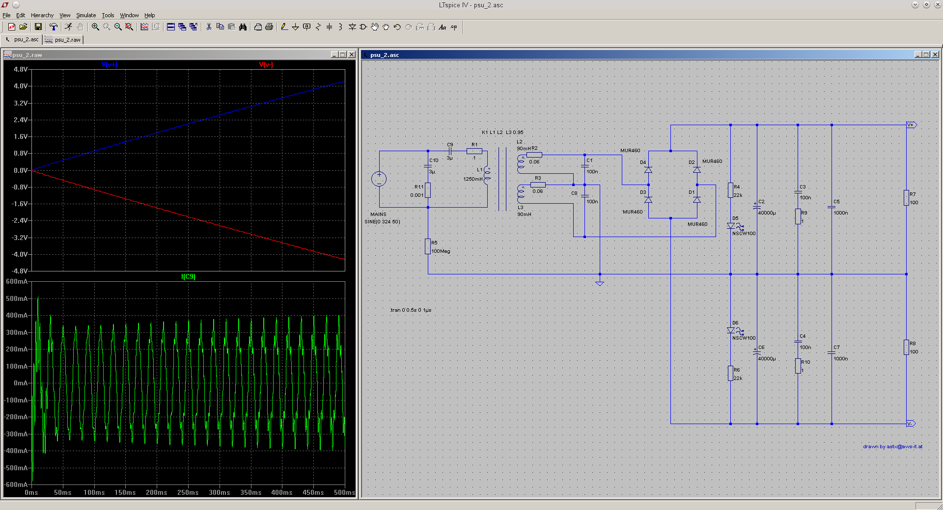

Attached you can find a simulation of a 650VA Transformer using a 3µ cap. What we can not simulate is the inrush current phenomenon but we can get some information about capacitor load.
Don't know if this ~300 mA current helps here to premagnetize the core to avoid the big inrush current. Maybe you are able to test this (wearing safety glasses)?
(R1, R2, R3 is the dc resistance of the windings.)
BR, Toni
Don't know if this ~300 mA current helps here to premagnetize the core to avoid the big inrush current. Maybe you are able to test this...
Thanks for the simulation. The transformer inductances are determined from measurements or what information?
12uF for 2 seconds should put the rails near 50V. About what I expected and should be OK.
