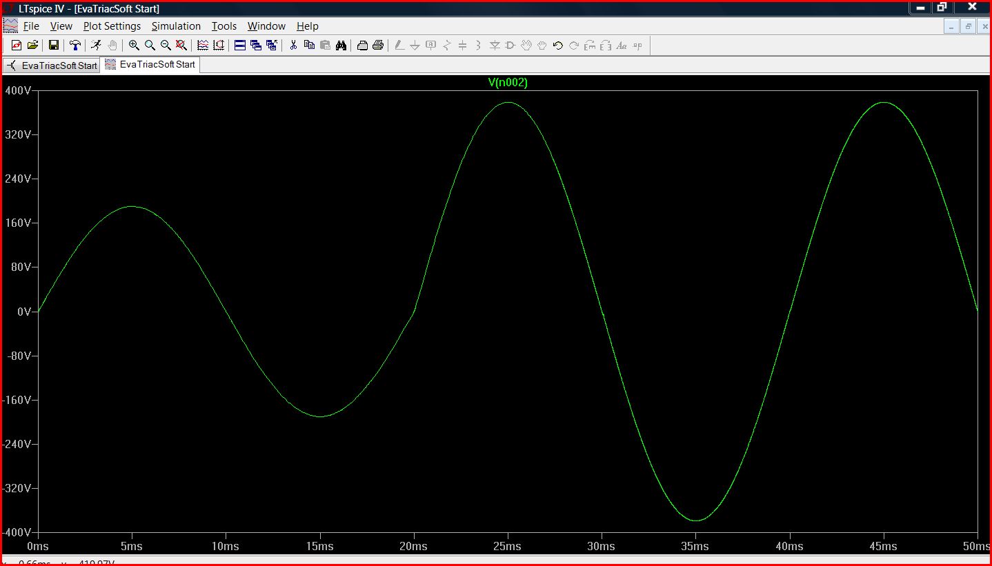

Burst fire the triac with HF from a gated oscillator set to be enabled after the required delay 😀
I claim zero credit for the idea... Eva demonstrated it about 6 or 7 years ago with what I thought was a truly inspired and simple circuit. Getting it to work in simulation was a right royal $*"!+&^$% though. I built a low voltage (as in running off a 30 volt transformer) breadboarded circuit feeding a dummy load resistor and it worked well. Also tried using a CMOS oscillator, and while that worked I just couldn't get it to run in LTspice... thats my fault though.
