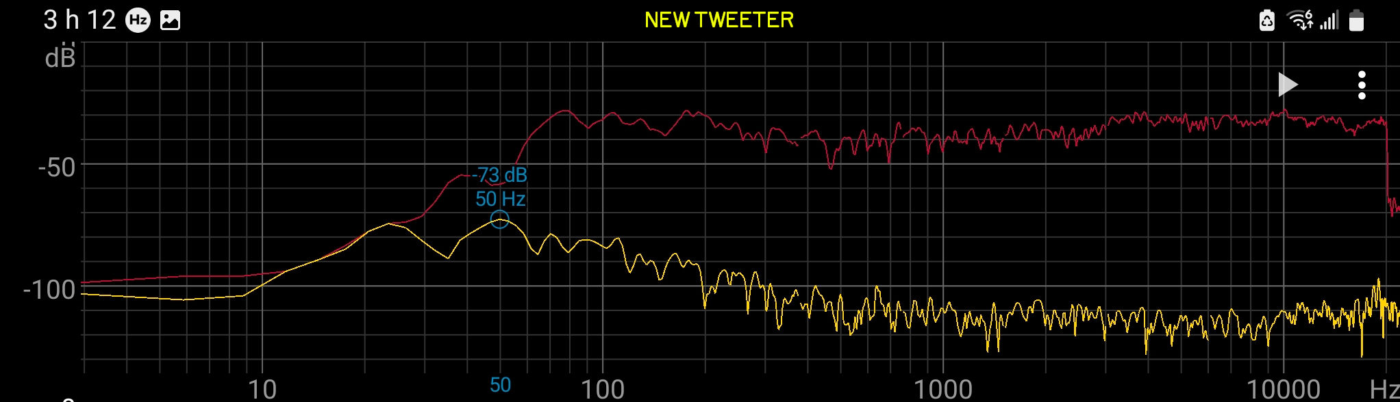

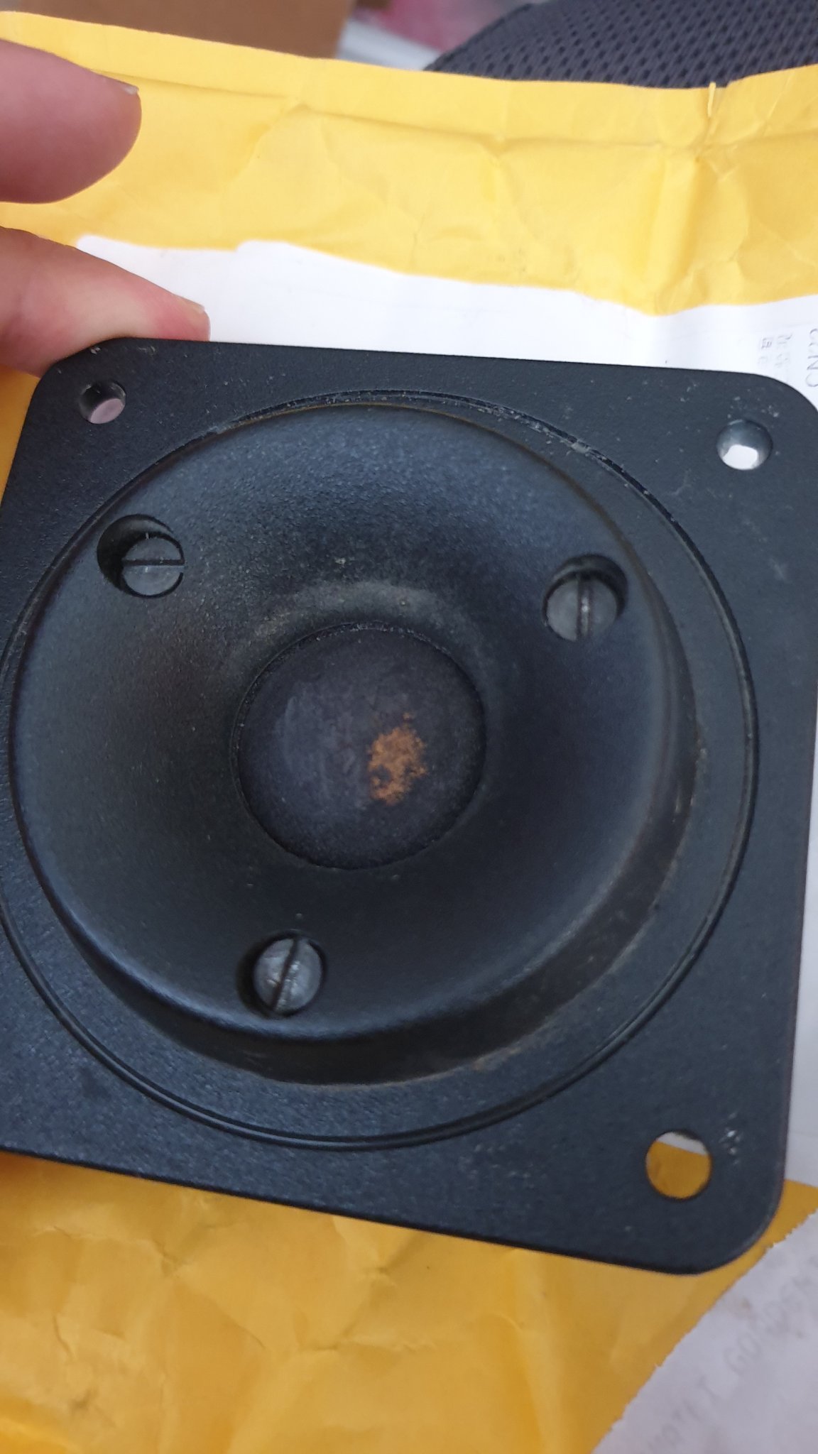

I have a question related indirectly to this topic. I recently replaced the silk dome diaphragm of a Celestion Ditton 22 tweeter. The one I used came from China and the fabric is very soft compared to the original that seems coated with some kind of varnish. I'm wondering if every tweeter needs coating?
It sounds definitely more "fatiguing" however it shows a more linear response than the original on the other speaker.

-most of your problem is linearity.
You currently have about a 5db rise in response above the average starting at around 2.6 kHz with the new tweeter.

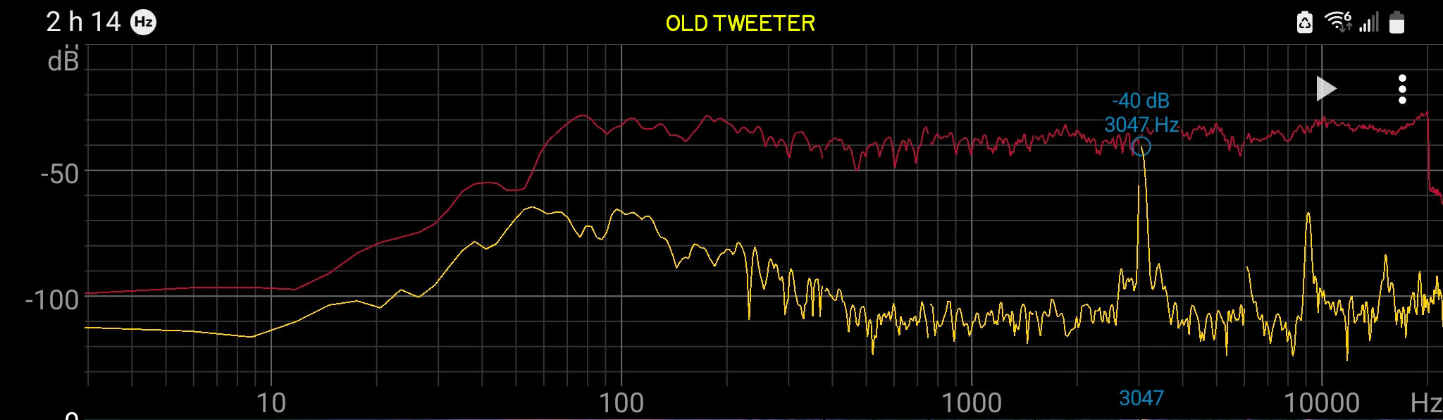

Don’t get me wrong though, the old tweeter isn’t good.
Also (generally) you should replace both tweeters at the same time and should do so with a tweeter that is almost the same sensitivity with extremely similar Impedances (to integrate properly into the existing crossover).
What is the old tweeter’s nominal impedance? Also, can you sweep just the old tweeter’s response at 2.83v at 1 meter? (to get an idea of eff..)

Thank you ScottG. Yes, I wanted to change both but before destroying the old working one I needed to know if my replacement was valid. My question was about coating and stiffness but you responded to it indirectly. The twitter nominal impedance is 4 Ohms. And DC resistance of old is 4.1 ohms while the one with new diaphragm is 3.9 ohms. If you don't think the coating will change much the result, I will be glad to open another thread to discuss this as I don't want to hijack this thread.
It won’t change the response much at all unless you apply (many) multiple coats, and it will likely end-up worse.
