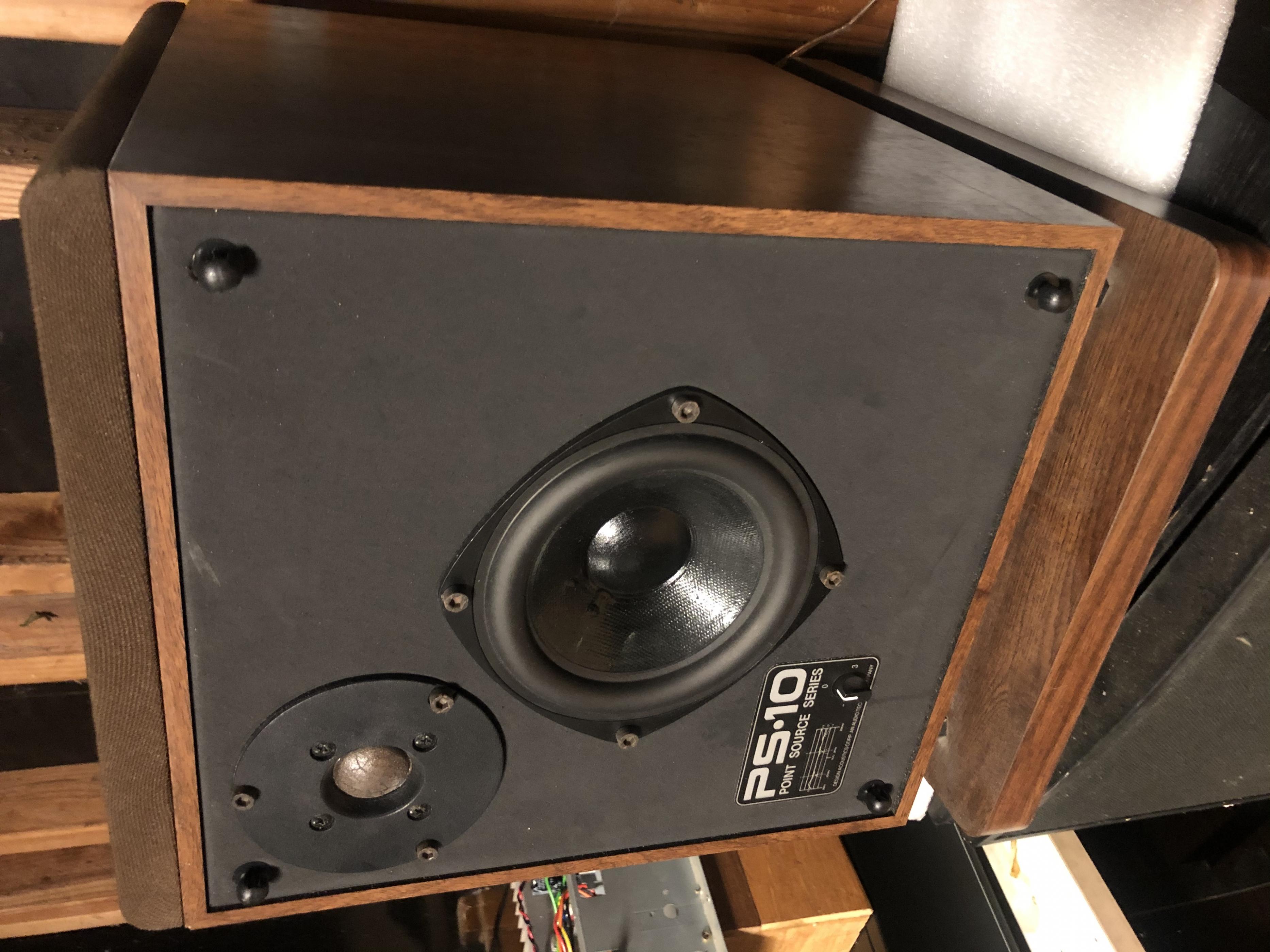

So I see only a few real answers here, my tweeters work but the surface is cracked, lots of light shines right through it. As far as this thread we have opanol and elmer’s glue (maybe mixed with some graphite powder?) come on weather you call it doping recoating or whatever are these all the answers? How about thinned vulcanized rubber? Clear coat? These are silk dome 8 ohm 90dB and I can experiment. I do kinda like the school glue and graphite idea I hear it’s a mess. I guess paint on is my preferred method, ideas? Even crazy ones?
Seems there are many sort of silk impregnation : sticky or not, more or less light and hard.
So you can not use impregnation anymore or the result will not be the same everywhere. According to your dome was known about its style of coating (light, sticky) your best bet is a long iteration by using the lighter varnish possible (aqua, petrol, vegetal based, ?) in order of evaporation of the diluent keeps the less heavy deposit.... on both side of the dome ! All the rubber based imo are too much heavy for a dome for a refurbishing option - or it changes too much the former measures.
Your best bet is to know the brand and if possible purchase the dome voice coil spare part to adaptt on your model knowing centering is a difficult thing... on the opposit the refurbishing ask many try and error so is a long process : measurement and hearing test... and to a limit a destructive process when it's dry and you have missed the level of the formergenuine trade off.

I've had good results with diluted silicone on soft domes. It dampens well and adds little mass, plus is long term stable if applied properly. It also doesn't remain sticky like PVA type coatings so it wont accumulate and retain a bunch of dust particles.
I have a set of newer TW034XO tweeters that I coated with measured amounts of thinned silicone. The stuff I use comes in a tube which I weigh before and after to verify an exact amount, so the coating ends up even between a pair or batch of tweeters. I thin out the silicone with hexane at a ratio of 1 part silicone to 3 parts hexane. The hexane completely evaporates so all you're left with is the silicone. You have to work quickly, especially in warmer temps, so the coating ends up smooth and even. The coating should be applied with a fine brush and not sprayed, mainly because brushing pushes the coating more into the crevices of the fabric from the friction of the brush, while spraying just makes it sit on the top. Using an old modified turntable set to 16 rpm makes it easier to apply and get a nice even coat on the dome and surround. I start the coating by putting the full weighed portion of the mixture on the tip of the dome and work it down the sides, spreading it outwards. The brush needs to remain wet all the time and is first wetted with pure hexane just before starting the coating process.This is what I found to be the only way of getting a consistent coating that looks like it was factory applied.
The main effect i can measure is reduced top end beakup modes that many manufacturers use to create a rising response towards the upper frequencies. This makes the tweeter sound more "euphoric", giving the illusion of space and wider sound stage. The reality of this is increased distortion, which hurts imaging and accuracy. The proper amount of coating reduces the breakup while not overly weighing down the dome and overly reducing top end frequency response. The moving mass on a TW034XO is 500 mg and you dont want to add more than 50 - 75 mg of mass, otherwise it ends up sounding to dark. You'll need a very accurate scale to measure this. I derived this from cutting out an older and newer TW034 dome and weighing them both. The difference bewteen them is roughly 75 mg with the older one being heavier.
Thanks for all the reply’s, varnish seems safe, but if I can get a good result with silicone that would be great. If I don’t get a good result they are easy enough to replace. I’ve got a .01 gram scale that should do it
