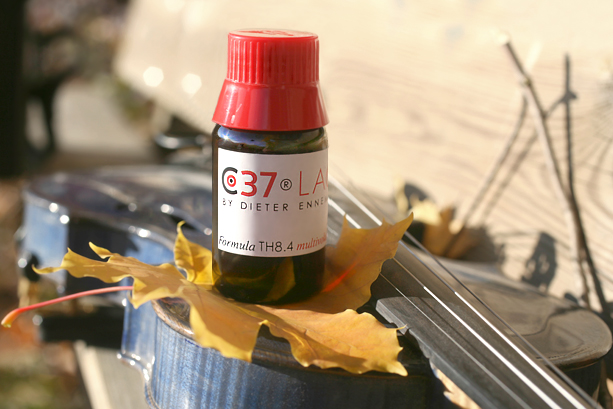

So the legendary C-37 would not suit tweeters? Has anyone tried?
C37 Acoustics Dieter Ennemoser - Violin Maker & Acoustic Researcher
