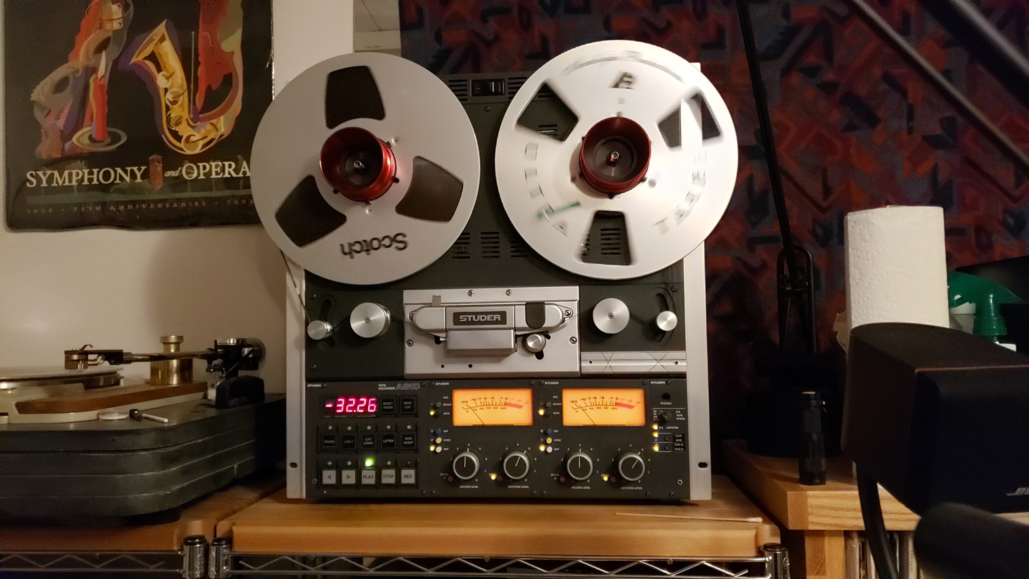

In other news I have moved on to a new world, the Otari is a nice entry level deck, but not a stellar performer. I came to this conclusion after purchasing a number of commercial releases on 15ips tape and being very disappointed in their sound quality which did not match the glowing reviews nor what I had heard in two other instances.
Yup, I bought a recently overhauled and fully serviced Studer A810. And yes the differences in performance between an A810 and an MX-50 are not small. The price differential in the day wasn't small either. The Otari was expensive, the Studer insanely expensive. (The version of the A810 I have retailed for about 7X what the MX-50 did in the mid/late 1980s.) Today the delta is if anything in practical terms even larger. Otaris are cheap comparatively despite the asking prices on eBay and the Studer isn't.

Congrats on your new Studer A810! They are FINE machines! I have one as well, and it's superb!! I believe they were about $10,000 when new, so I'll guess you probably had to pay 4 or 5 grand for one---eh?
Kevin: I'm kinda impressed you bought something that didn't need total restoration! But do you now have more R2R decks than tapes...
Actually I have a significant number of very, very expensive transfers which is why I purchased the A810. I plan to add more in the coming years. (No more than a couple of year unless I hit the motherlode.. LOL)

Add 40% to 150% to your estimate of what a new A810 cost in the mid 1980s, apparently by the end of the run in the early 1990s the dollar had strengthened considerably against the Swiss franc and demand was dropping which drove it down. (Best numbers I have got so far.) There were a lot of options. Mine is a standard A810 2/2 VU HS which would have been nearer the top of the price range than the bottom. I have the transformer coupled output cards rather than the direct drive - the direct drive output cards are considered a bit more transparent, but are rare and expensive. The console versions were the most expensive variants, but happy to have a chassis model because they take up a lot less space. Great if you like lifting 70lb tape machines.
I do plan on the wood sides and handles off of eBay at some point to make it easier to move around when I need to work on it. (Not an immediate concern admittedly)
Any plans to mod the Studer A810? As you probably know, Fencer over at tapeheads thinks their playback amplifiers are abominable; he HUGELY prefers fire bottles to opamps for tape playback. However, I don't agree with him that all opamps are terrible.

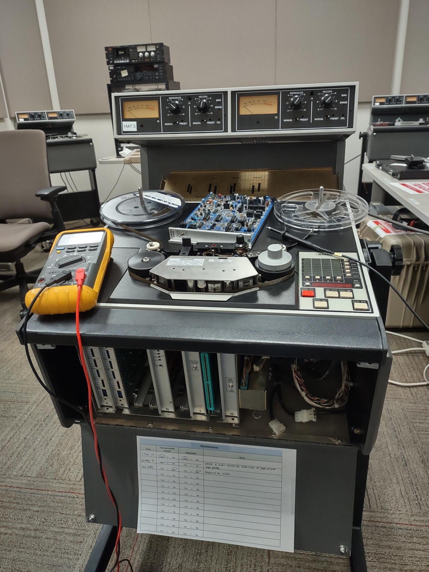

The ATR 102 is an excellent machine and in another league altogether from the MX-5050. The Otaris are OK the ATR102 and A810 are great. The A810 cost about 5 - 6x what an MX-5050 did in the day so that's not really surprising.

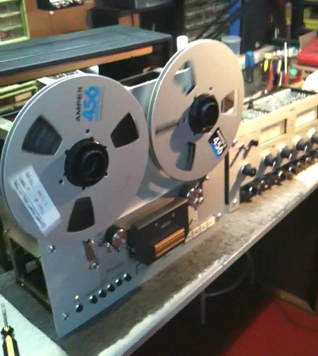

The MX-5050 that's been sitting on my basement shop is finally gone, thank god.
My neighbor finally came and got it.
I told him to use it for a "parts" machine" for the other MX-5050 that I restored for him two years back.
Plus, he's also got the Technics RS1500 that I did for him last year.
In my opinion a better machine.
The machine was loaded with issues..
Capstan motor seized, needing a $300+S/H rebuild at Athan in Cali.
Servo board was sloppily inserted, hanging down.... lord knows the condition.
Heads needing realignment due to some DIY joker poking a screwdriver around.
Dented bottom cover due to dropping it.
Etc etc.
I won't waste my time on such things..... I draw the line.
