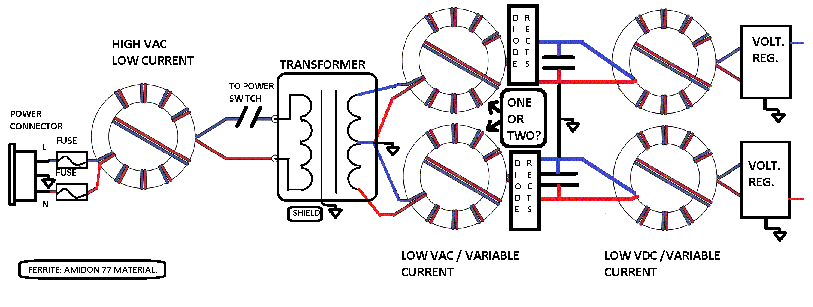

Hi Guys,
You Know I LOVE You All, so I must update my post (with polemic topics) about my Otari MX5050 mods....
* I also replaced all JFETs in signal path and FB circuit for 2SK170; mind the pinout sense for the Common-Gate fets arrangement...
* I replaced the Pinch-Roller for a new one: rather expensive But very worthy...
* Latelly, I've been testing an upgrade that our technical brothers say It cannot possibly work: adding Bifilar Reisert (current) Baluns to the dedicated Repro Amp PS, first on the Transformer's Secondaries paths for the PS and then between that PS Caps and the Regulators.
I attach some files to show ferrites with more desirable qualities probably than those that I am using, whose specs are un-known since they come from discarded PC Power Supplies. I also attach a diagram for the current state of the dedicated PS. Please neglect the Balun on the primaries because the Moderators do not like when one messes with that...
This mod is So important that I am now on the final stages of upgrading one of my beloved DAC's PS, both on the digital and on the analog side...Niquist was right, guys, hehe.
I always forget to mention that when I started using Baluns, 15 or 20 years ago, I purchased 3 rings whose specs said they worked even on tens of KHz (30KHz I seem to recall) made form other material than ferrite...amorphous something; I've lost the file....those baluns are still in operation on some of my digital sources...
* On the output XLR, I disconnected the Ground cables and connected Pin1 to chassis.
I won't extend in the audiophile's description of the improvements: suffice to say that the noise floor is significantly lower now, I got rid of hum/buzz which is only faintly audible when I put my head "inside" my big Beyma coaxials (98/105db/W/m sens.), and dynamic contrasts are more marked, which is one of the reasons we listen to tape in the first place.
https://fair-rite.com/43-material-data-sheet/
https://fair-rite.com/77-material-data-sheet/
Best Wishes to All...
M.

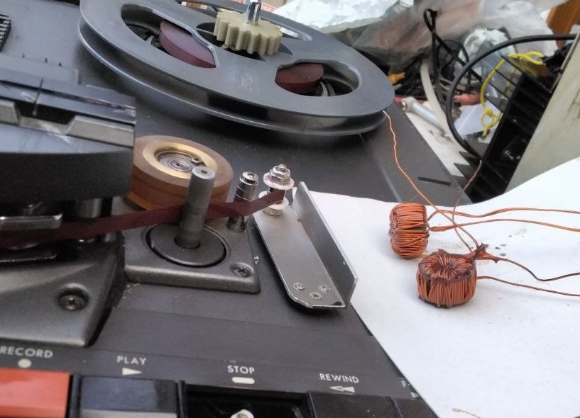

Hi guys and thanks for your inputs...better late than never...
I have some Shotgun Amobeads that can be bifilarly-wired to make baluns for low level signal...great little products. I will search the file.
About the FETs, I took out a pair, looked at the specs and forgot about them (probably on a box somewhere) and I have a big bag of 170's bought from a reputable seller two decades ago or so, so I use them a lot. Time ago I did measure some samples and they measured according to what is to be expected...I don't remember the value from memory.
I did compare the "old" opamps, the 2134, a short try of the 4562 but my preference is clearly the 2604. I am still waiting to swap the IC501....
Better VRegs will give even better results. I have some Shuntregs that I would love to try but they would hardly fit-in...
About the "Baluned PS" (sorry to insist) it is quite a remarcable discovery of yours truly, hehe, and now I have competing my OTARI with two of my DACs which are also "baluned" and the results are consistent. Quite astonishing is the fact that, due to improved noise floor and dynamics, the sound presentation is "louder", not-"your-neighbors-Boom-Box" louder but "the-orchestra-just-got-their-pay-check-plus-a-bonus" louder, hehe. The un-modded digital sources sound "harmless" but the modded ones sound "dangerous", truly scarry.
I've been studying some articles and I seem to get how these amazing little things work. Appart the known facts about CMRR and balancing the lines between them, it seems that they also "balance" the currents inside them, meaning they treat the skin effect and probably improve "group delay"; maybe that explains why the system sounds more powerfull, with punchy bass/midbass and drums that "jump" outside. Apart that is the effect on "reactive currents" which I have to study further. See, the filter works both ways: they isolate the unit from the rest of the power grid and also inside between sections....that is what I understand until now...
I attach a pic of the pinch-roller, the DIY tensions arm and of little Baluns, dipped in varnish. Those ring measure +/-17mmOD and 10mmH and they give an L of 10mH (each winding) and a C of 334pF. Given that the N° of turns is less than 100, the AL number is bigger than 1000, for what it is worth. I really have to ask some clever guys like Jimmy Neutron and Wintermute.....
Anyway, now I have to buy rings with different materials and try to source enameled OCC Copper (mono-crystal) to make even better quality units.
M.

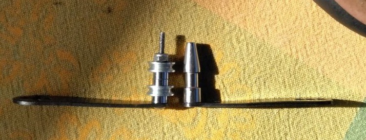

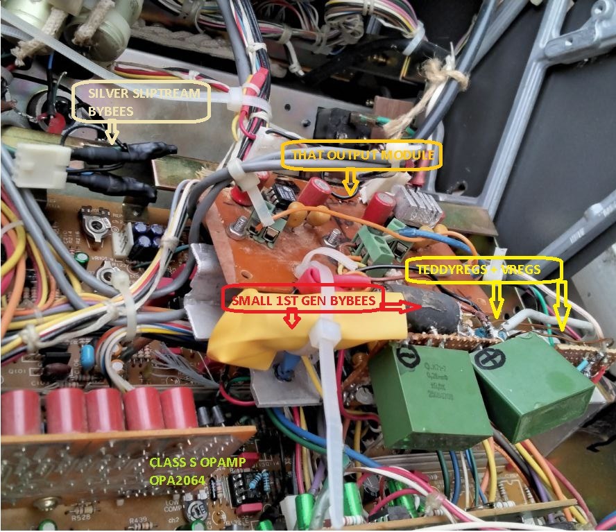

Hi guys,
The following mods and pictures are NOT for the faint of heart...
Following with my mods for the Beloved OTARI MX5050 and since the "Baluned Power Supply" produces a beast like dynamics and weight, I decide to use some Bybees (previously used in I2S tasks on several DACs; very low power tasks) to give more elegance and refinement to the beast. I installed First Generation Small Bybees After the Voltage Regulators, TeddyRegs in my case. As expected, perceived frequency extension and detail increased BUT a hardness in sound presented itself, which almost made me give-up. After 10 to 14 days the sound softened again, retaining the "seeing inside the music" effect of these. I asume the First Gen Bybees had to burn-in in this new task. Once used to the new sound presentation I decide to instal bybees direct from the Tape-Head signal, being this one the lowest power in the chain and arguably more prone to 1/f noise. Unfortunatelly I only have one SIlver Slipstream....well, you know me, I cutted in half the unit ending with two Half-Silver Bybees, which are the latest and more refined units, more than enough for the very low current signal. I installed them and was in awe at the effect.........listening to my 4Track Opera Collection (london) is the nearest to a Time-Space Travel....I won't go into the audiophile details because I know you hate them....suffise to say that it is exrtemelly detailed, elegant and refined soundwise.
And guys, don't even bother to criticize my use of the Bybees: IF you don't hear a difference with them or never used them it is NOT MY PROBLEM.....
I attach a picture of Mods (Warning again) and a small video about the tension arm mods. I inform that I purchased a lot of different bearings ( shipped) to test the best and most recommended possible Tension Arm Mod, which experiments I will initiate as soon as the units arrive. This superb OTARI machine deserves the best transport....
M.
PS: Joy-full 12:12 Portal!
PS: there is a little mistake on the pick; it should read "Class A opamp".

The tension arm can be improved further.
Here I show one alternative with bearings. There are many sorts of suitable bearings from which to choose and experiment. I believe that all of them will perform better than whatever washers are available....

PS: image is for illustration purpose only. My tension arm is made from an "L" shaped Al, taken from a "structural" type of Al piece....
You can search as : "skateboard bearings" or "V groove bearings"-"U groove"...etc.
M.
