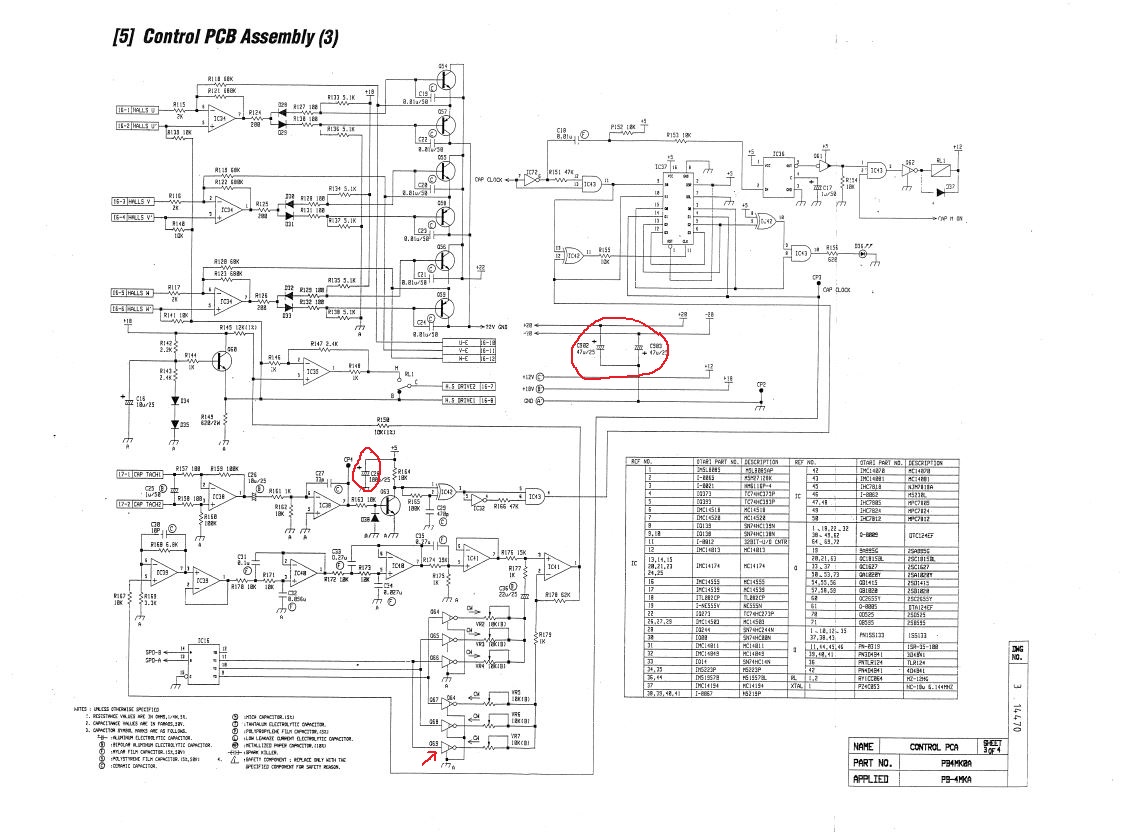

MX-50N Capstan Motor Woes
Now fixed, but apparently MX-50, MX-55 and MX-5050BIII share the same capstan motor and servo electronics design.
A common complaint seems to be that the highest speed (usually 15ips) on these decks malfunctions - the motor runs backwards at high speed.
I replaced 3 electrolytics I missed, at least one of which was in a place where its failure resulted in a large increase in noise on the supply rail.
I also found a cold solder joint on the switch transistor that selects the pot that sets the servo gain at 15ips.
I checked all of the logic - all OK.
Replaced the caps, and resoldered the transistor.
Fired it up and everything worked as expected.
Performed the adjustment procedure outlined in the service manual, touched up the 15ips servo gain and the master clock, none of the multitude of other adjustments needed to be touched. The scope shot is the 15ips servo adjustment result which is ~50% duty cycle at 4800Hz.
Interestingly the motor now runs much more quietly, it was particularly noisy (buzzing) at 7.5ips. I have observed this in several other MX-50 including the N II and thought it was very strange. I now know it is not normal. I am sure replacing those caps is what fixed that issue. (It may also have fixed the speed issue as well.)
