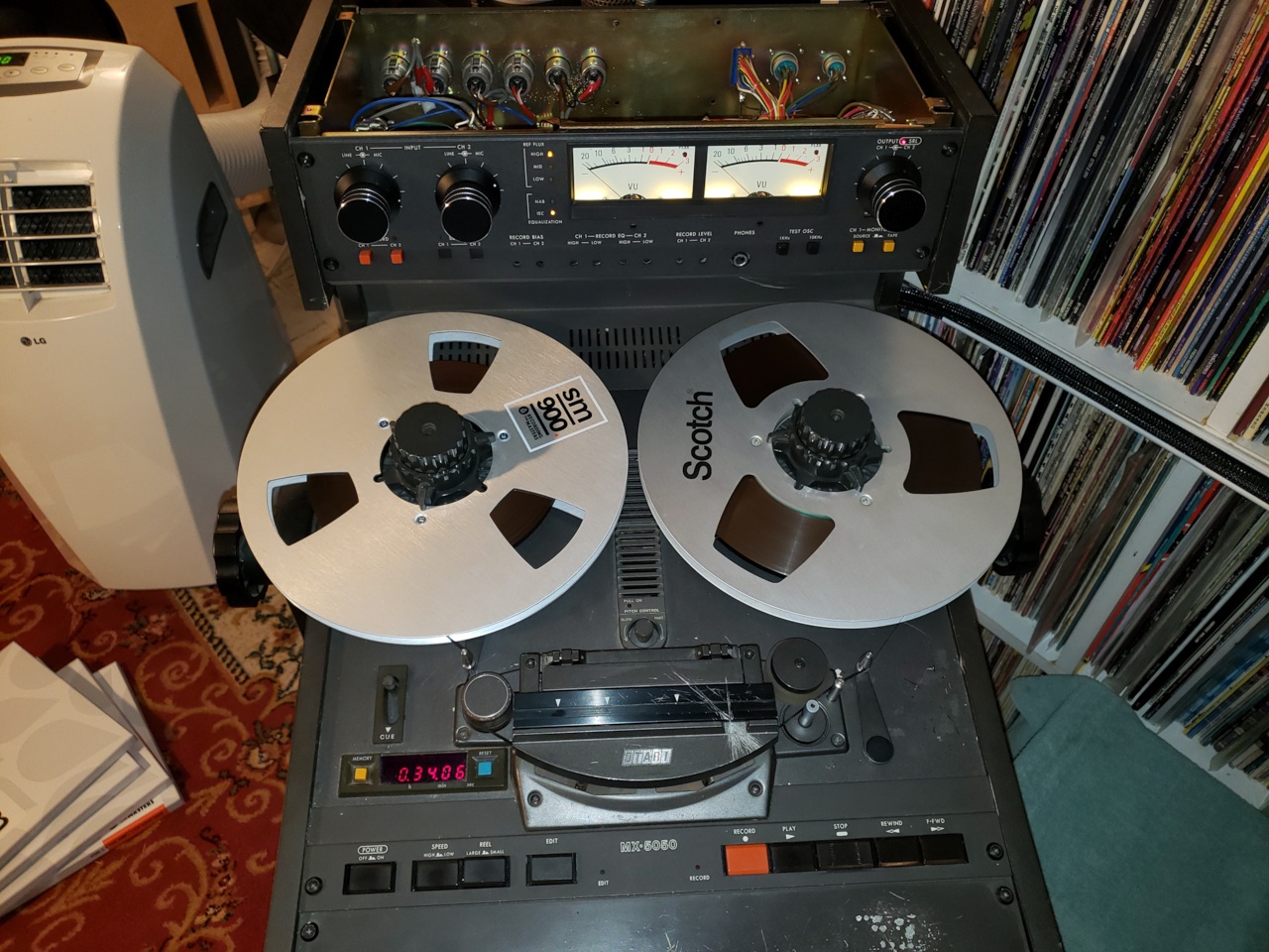

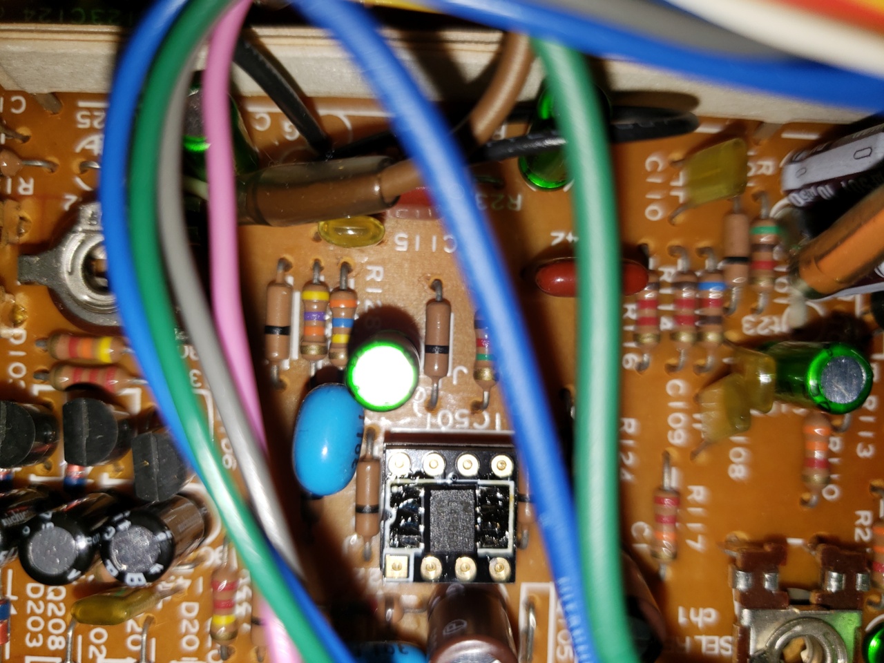

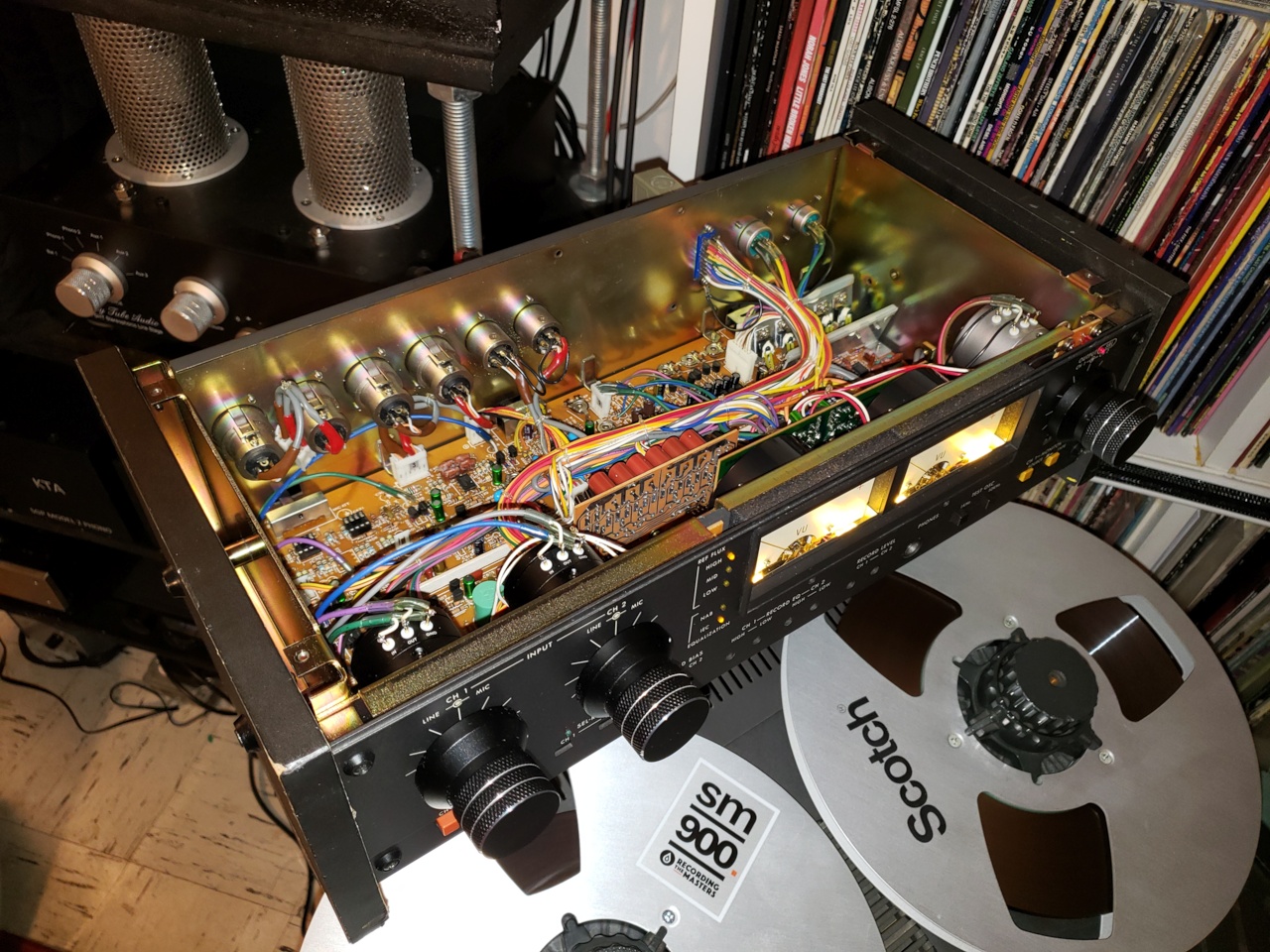

Tentative OpAmp Report
I'm lazy, I won't lie.. So tonight I soldered an LME49860 to an adapter and plugged it into the tape pre-amp op-amp socket in my MX-5050MKIII-2. I did verify very briefly with my scope that it was not oscillating.
No measurements of any kind because in addition to be lazy I got home from work at 8PM tonight and I am rather tired, but... curious.
I guess it's that 30dB or so of extra OLG over the NJM2043 or perhaps a slew rate that is about 5X faster, but despite my initial pronounced skepticism I do notice the highs are a bit a cleaner sounding so perhaps upgrading at least the op-amps in the high gain positions might be worthwhile.
The sole one installed in the MKIII does run quite hot on the +/-18V supplies so I suspect in the MX-50 they will run hotter still with the +/-20V supplies. I am planning on little heat sinks for this devices. I would estimate case temperature at > 60°C so the die is probably toasty.
I am still not convinced that I should change them all, it strikes me that the most critical ones would be those that are running at significant closed loop gains.

Hmmmm.....interesting....thanks for reporting your findings! From the data sheets I have, it appears to me that the 49860 is ~3.5 x faster than the 2043, and ~5 x quieter. Distortion specs are impossible to compare, because New Japan Radio does NOT provide THD stats of any kind on this device that I can find. The 49860 is ~-130db and I would guess that the 2043 is quite a bit (20-30db) WORSE than this, based on other NJM products that I have found specs on. Whether or not that THD difference is audible or not, I can't say. The noise difference, if detectable at all, would ONLY be relevant in the first repro head preamp. I would think that the speed and distortion differences would be cumulative in the remainder of the circuitry; once the signal is slew-limited and/or distorted by one stage it remains so; therefore one 2043 in the path would taint the rest. But again, this is tape and these differences may not be audible at all. I am surprised at the 49860s running hot, as they cannot be drawing much current at all!I'm lazy, I won't lie.. So tonight I soldered an LME49860 to an adapter and plugged it into the tape pre-amp op-amp socket in my MX-5050MKIII-2. I did verify very briefly with my scope that it was not oscillating. I guess it's that 30dB or so of extra OLG over the NJM2043 or perhaps a slew rate that is about 5X faster, but despite my initial pronounced skepticism I do notice the highs are a bit a cleaner sounding so perhaps upgrading at least the op-amps in the high gain positions might be worthwhile.
<snip>I am surprised at the 49860s running hot, as they cannot be drawing much current at all!
It's dissipating 140mW at idle due to the supply voltage and that package is really, really small.
