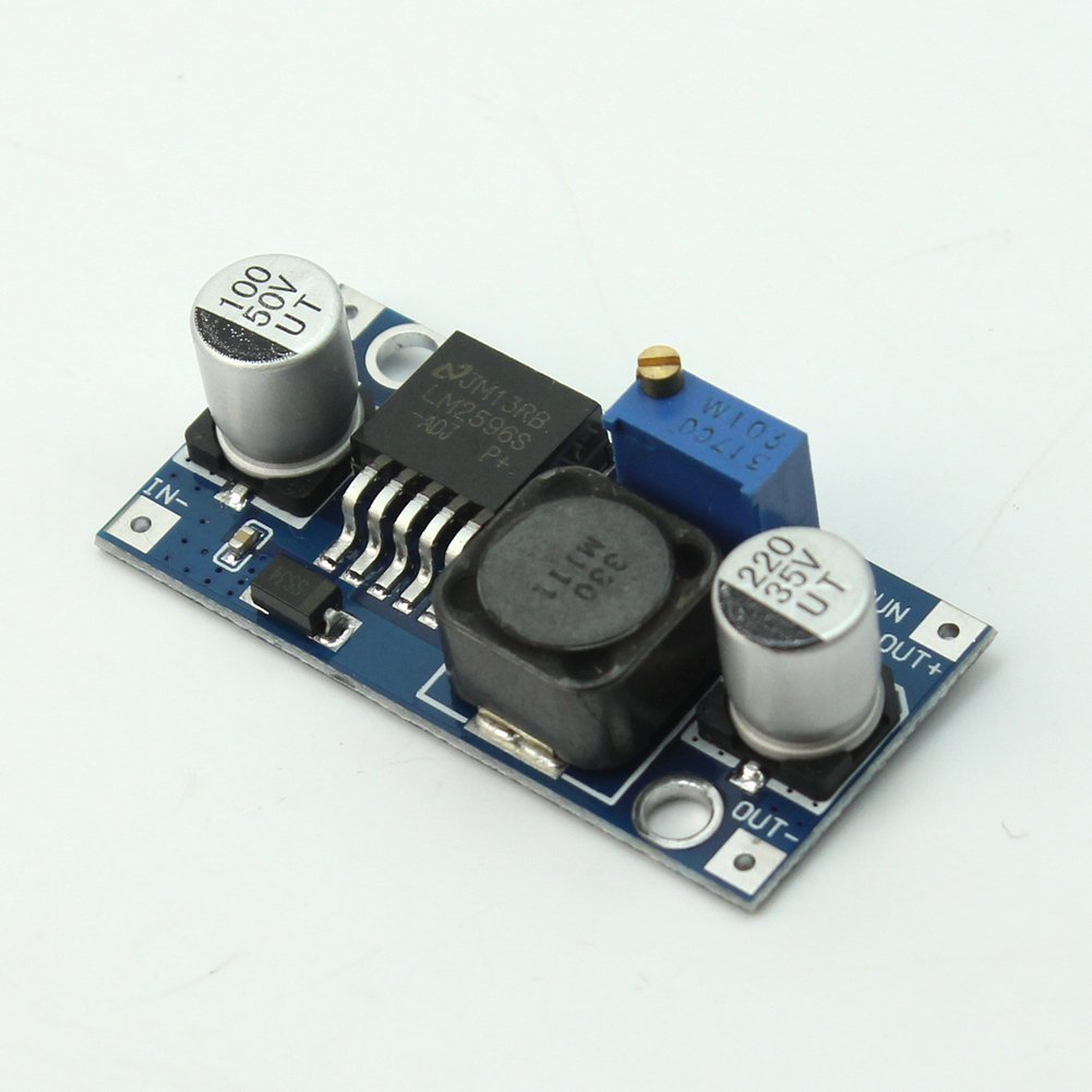

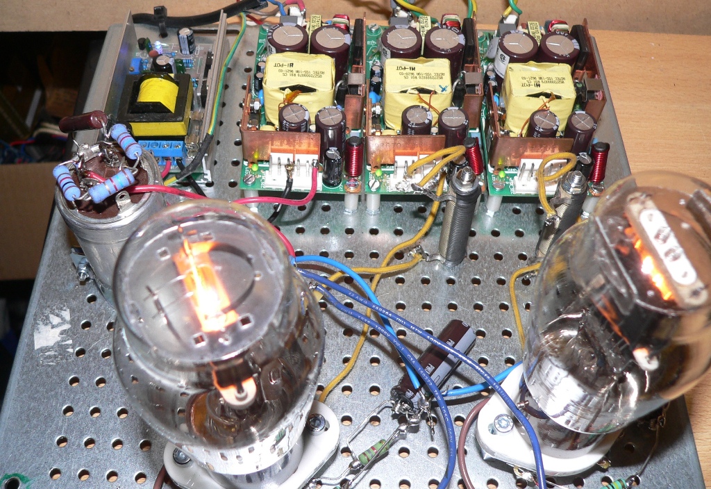

I've just lit up my first valve. Hussar! I thought I'd try it on the cheap (without all the - what you call iron).

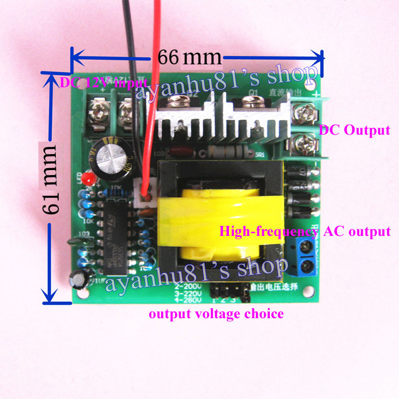

You might recognise the little blue rectangular board. They're very popular and simply generate 6.3V from a wall wart power brick. LM2596 SMPS controller chip. The square green board is a true kwality piece of kit. No output smoothing capacitors AT ALL. You have to supply your own. At least it uses a proper KA3525 chip so there's less chance of it exploding than a home brew device. I have mine set to produce about 235V B+.
A couple of issues that concern me though...
- When I turn on the whole thing from cold, my valve heater flashes fairly brightly for a 1/4 second, then settles down. Probably dodge regulation and I don't know what the long term effect of this might be. I suspect though that my wallet will find out.
- There is a very annoying 7.5KHz tone that appears at the output of the valve. It's +30dBV about the background level. That's right, I wrote thirty dBV. You can hear it as a whine. What could it be? I don't think that the B+ supply switches at that low a frequency, and harmonics only get higher than the fundamental, rather than lower.
At least the valve works. Small moves, Ellie. Small moves.

This is common with some early type valves, its because the resistance of the heater wire is low when cold and only rises to it operating value when hot.When I turn on the whole thing from cold, my valve heater flashes fairly brightly for a 1/4 second, then settles down. Probably dodge regulation and I don't know what the long term effect of this might be. I suspect though that my wallet will find out.
Shoog
This is common with some early type valves...
Mine are CV4014s. Are you implying that this does not happen with all valves? I thought that it was a fundamental property of metal filaments to have inrush from a cold start. I take it that I should include a resistor to prevent premature burn out?

I am not certain how, but this is designed out in later valves. My current main amp has some Telefunken valves and they all do this.Mine are CV4014s. Are you implying that this does not happen with all valves? I thought that it was a fundamental property of metal filaments to have inrush from a cold start. I take it that I should include a resistor to prevent premature burn out?
There is no need to be concerned and no special precautions are necessary. If you want to avoid it then applying a Constant Current heater supply is the only solution.
There is a little part of the filament that is outside of the cathode, hence can heats up faster. Since most of the filament heats up slower, showing low resistance, the outside part can be overheated by the not limited excess current. A series resistance and higher voltage may help.
+30dBV is 31.6V. Are you sure you wanted to wrote this? Isn't it "+30 dB above the background"? (That is about 100 nW of acoustic power in a typical quiet environment.)
The switching freq is probably high enough not to be perceptible, but Pulse Width (Duty Cycle) is modulated trough the control loop. This control loop can be unstable, and may generate audible noise in PW.
