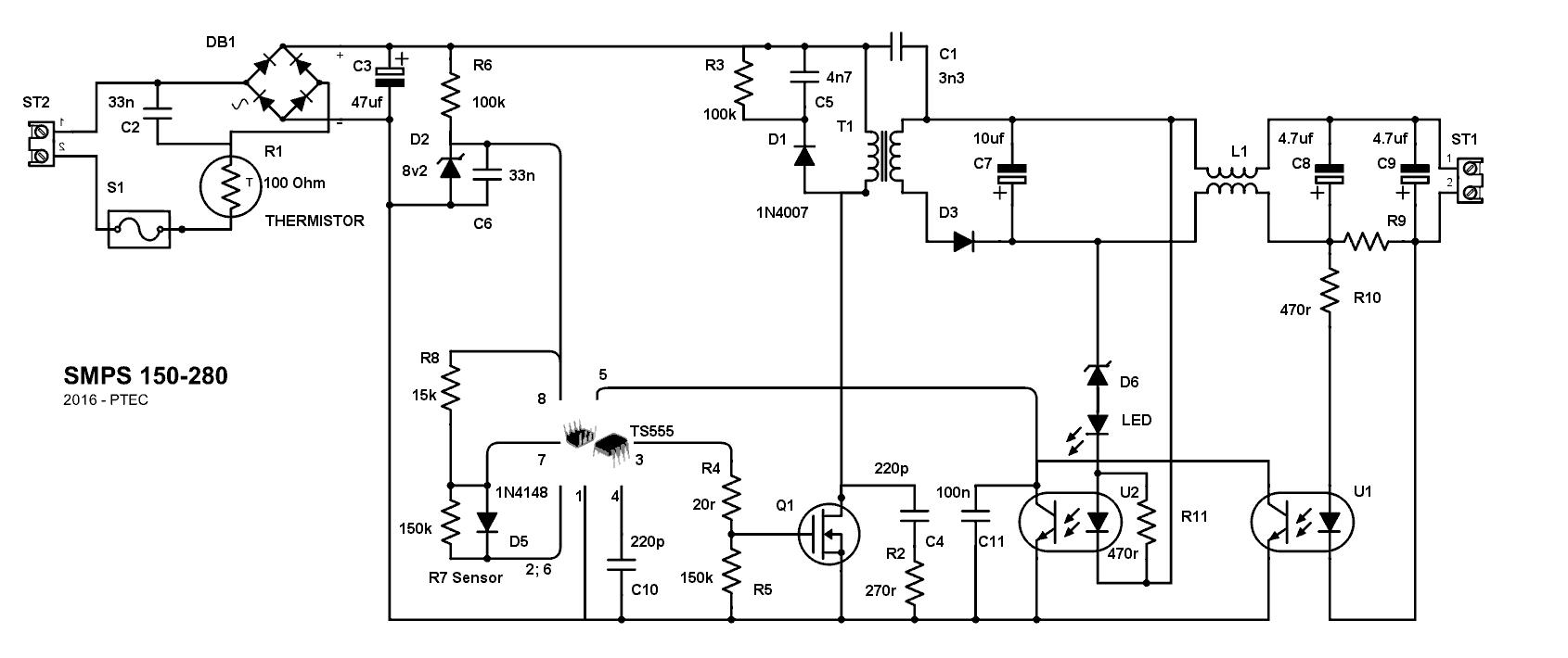

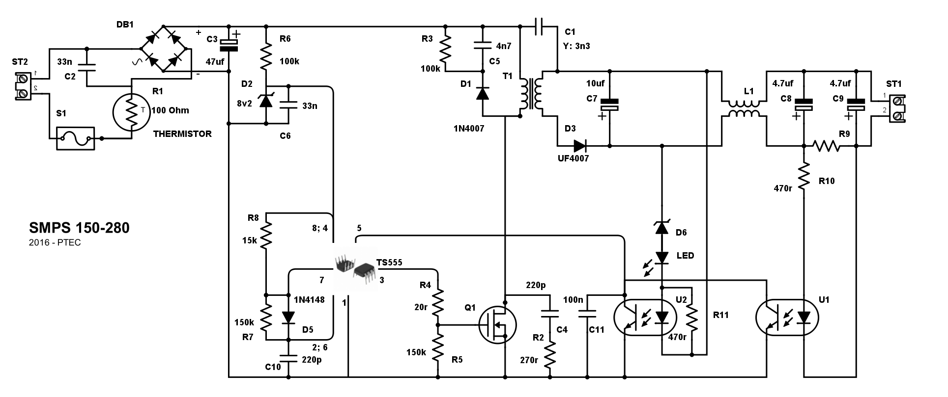

Isn't there a capacitor missing ? 😱A tested flyback solution in attachment:
For D1 better an UF4007 (faster)
Mona
Try to do away with C1, it's coupled to the mains rectifiers circuits which is not going to pass serious safety tests, eg. what if they break down?? It's considered a critical component.
Not quite, C1 may be required to meet EMI standard, for more please see: switch mode power supply - What does the Y capacitor in a SMPS do? - Electrical Engineering Stack Exchange
I agree, but to suppress EMI is necessary to put a capacitor between the input and output side of the power supply with a capacitance substantially higher than the capacitance in the flyback transformer.
To prevent hazards to the user, the capacitors must be designed so that short circuit failure is very unlikely, a "Y" capacitor is used for this purpose.
You are correct, C1 in the above schematic, is often referred to as the Y-capacitor in flyback SMPS datasheets.

FYI, high voltage SMPSs tend to have worse issues with EMC.
While this might not directly affect the performance of a tube amp (which doesn't strongly rectify RF, as bipolar discrete and op-amp circuits do), the conducted and radiated emissions will very likely interfere with attached equipment in your signal chain, not to mention neighbors (some of whom might be using very important services, like shortwave aircraft navigation and emergency channels..).
As for design tips:
Any design that does not use current mode operation is doomed to failure. Sure, a voltage-mode converter can operate under lucky conditions, for decades, without happening to hit the one combination of source and load states that makes it fail. Or it can just hiccup and explode one day. Pretty dumb to leave such a liability unpatched. While hacks can be applied, the best solution is very simple: current mode feedback.
Do not use a 555. It cannot produce the range of PWM needed, without adding many components. You need two 555s (or a 556, same thing) to do that, and you still need a pair of op-amps to handle current and voltage feedback.
Better to use a discrete circuit like this, which implements current feedback:
(I wouldn't recommend it for mains input: the voltage startup circuitry will take more transistors to solve, at which point you're more than better off using a UC3842.)
Or use a proper current mode circuit, based on UC3842 or similar controllers. Or if you need more power, a TL494 (or similar) controller, but then you need an aux supply, and forward converters require even more overhead in the rectifier, due to leakage inductance and parasitic capacitance.
