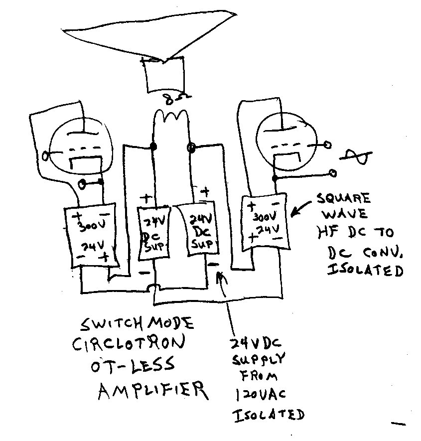

The biggest issue for SMPC is the line isolation. If you go a step further (simpler actually), one can avoid that complex issue all together and reduce ALL major expenses. See attached diagram below. A VERY simple square wave LV DC to HV DC inverter (no V regulation even, but isolated ferrite xfmr) provides B+ power AND impedance conversion for the tube(s). The LV DC can come from off the shelf (Ebay cheap) converters.
The input side of the LV to HV converter just looks like a high current tube (cathode to plate) that can run speakers directly. The tube is still driven by the usual grid to cathode signal. The DC conversion ratio is just like the turns ratio for an OT.
