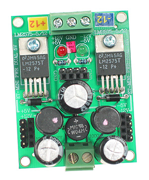

I wonder if any one of you have tried this?;
Dual 12V Power Supply Mini Board
Part Code: MINIPOWERDUAL12V
Features
Incorporates the High Efficiency LM2575T Switching Regulator
Suitable for 14-24VDC input with PCB Terminals
Power LED for both Positive and Negative Outputs
Multiple +12V Output Termination Points
Suitable for use where dual polarity supplies are needed
Board Dimensions: 45 x 55 mm

the trouble with AC-DC sw mode converters that they are based on the flyback principle. the transformers need a tight coupling between primary and secondary, resulting in capacitive coupling between primary and secondary with a strong noise source pumping noise into your system ground. try to connect your laptop headphone out while powered to a sound system. that is pump out noise..
Calvin,
You are right. But chinese crap SMPSs are only indicators showing the problem exists. In a good SMPS the problem is lower, but still there, and measurable. 1000...10000 times higher freq means 1000..10000 times higher capacitive coupling between primary and secondary (common mode current!) And also 1000..10000 times higher di/dt (magnetic coupling). This high attenuation of the noises is very, very hard to achieve. Typically it requires several nF Y capacitor between mains side and output. And this is not a good news for a Class II audio system connected to it.
BTW: can you design a decent SMPS, and willing to share the design here, or can you show a commercially (or DIY) available one that is at least as good and as cheap as a decent transformer based PSU? Because if not, then you make a comparison between an available and an unavailable option.
(I'm working on an SMPS especially designed for audio that overcome the high frequency noise issue without high capacitance, but it will not be as cheap as a traditional PSU, and it is not a public project, and I don't know any other design with the same characteristics.)
