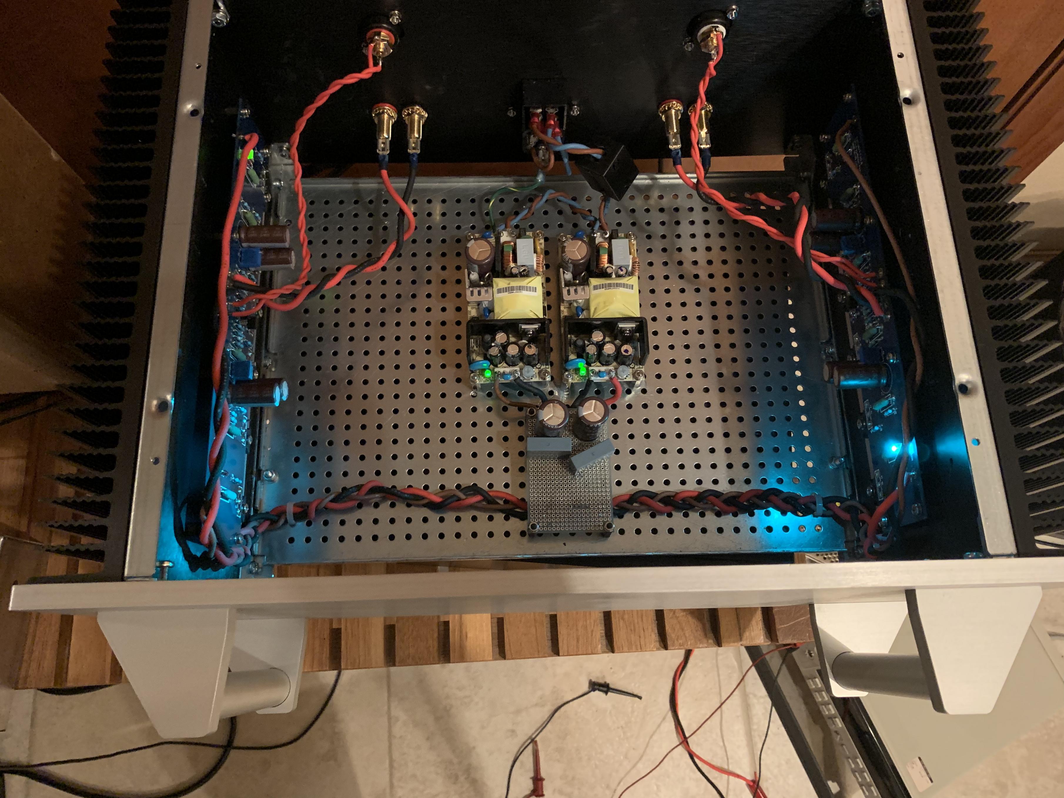

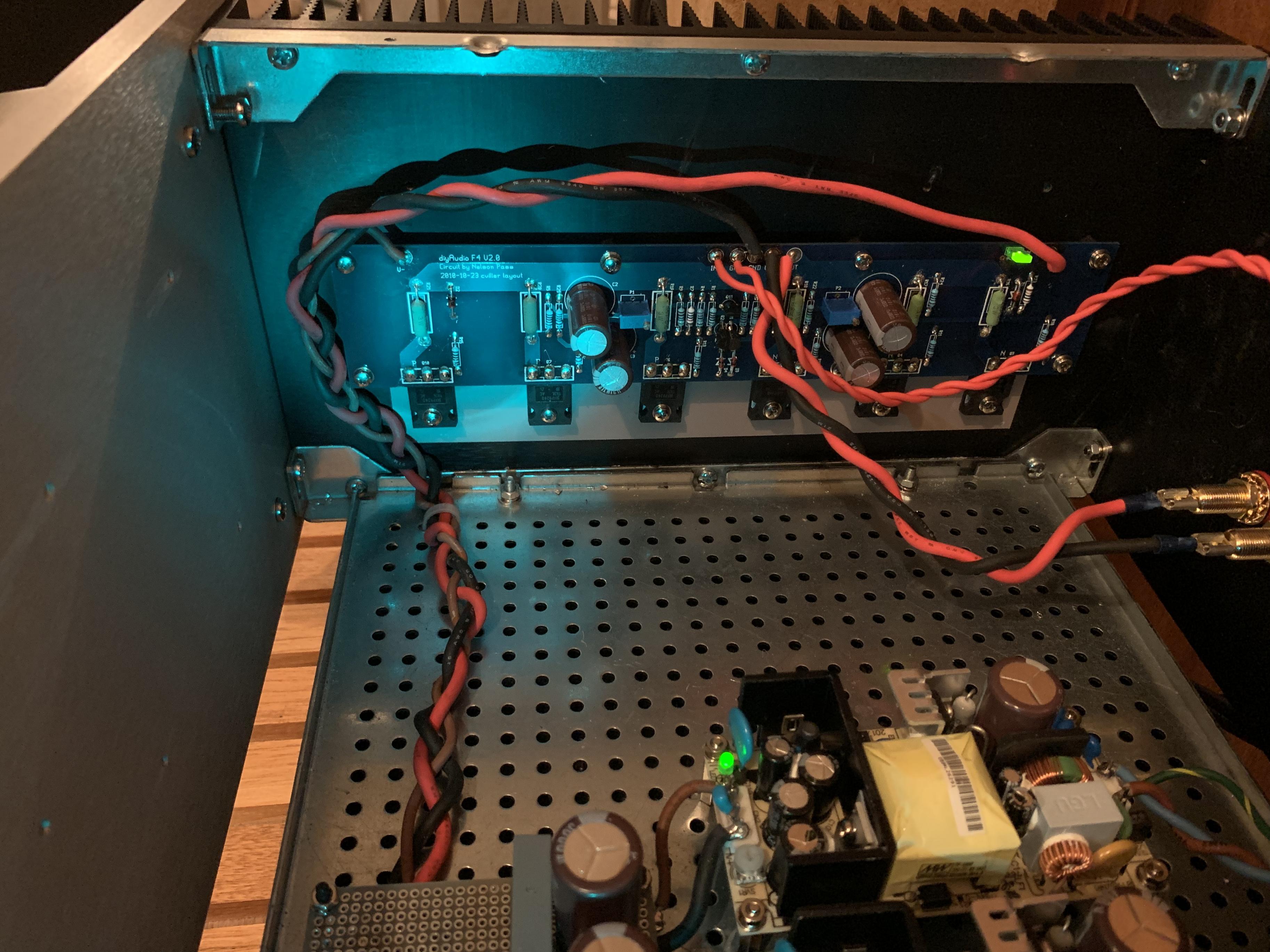

I am using two Mean Well EPS-65-24 SMPS for my Pass F4. There are three (in the picture) types of capacitors being used on the output of each module. A ceramic 22uF/50Vdc (RDEC71H226MWK1H03B) cap is soldered directly to the pins of the unit. Following that is a 5600uF/35Vdc electrolytic (EKYB350ELL562MMP1S) and a lower voltage film cap that I had left over from building passive crossovers (I don't remember the exact value or part number). Since the pictures I have added two (one on each rail) Panasonic 1200uF (EEU-FM1V122L) caps and the sound quality has appeared improved (no measurements yet). Some SMPS manufacturers will list the max capacitance load their units can handle, but Mean Well did not so I am starting small. A capacitance multiplier should be a great in this application!
