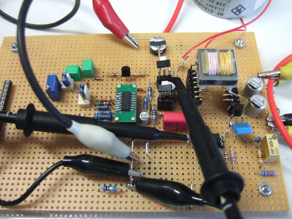

You asked for some information about my LLC-proceedings
Until now I built 15W LLC converters with 24 or 40V dc input.
These could be adapted, i.e. redesigned to 230V ac input.
Admittedly this project waits for some finalisation😀
Attached is a working circuit diagramm and a pic of an early stage breadboard showing the size of transformer.
This discussion shows a range of different design goals - so let me explain mine
- lowest EM emission
- lowest leakage current
- lowest component stress for long life
- highest efficiency
- as simple as possible, i.e. unregulated
This type of converter is a direct replacement for an unregulated linear transformer supply, including its 100Hz ripple.
Extreme low output ripple is not the goal, this can be achieved with additional LDO.
At this time, I do not have a 230V/15W Version done, but it is in my pipeline.
