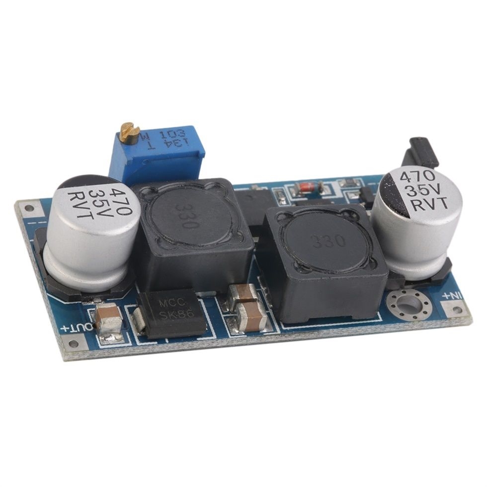

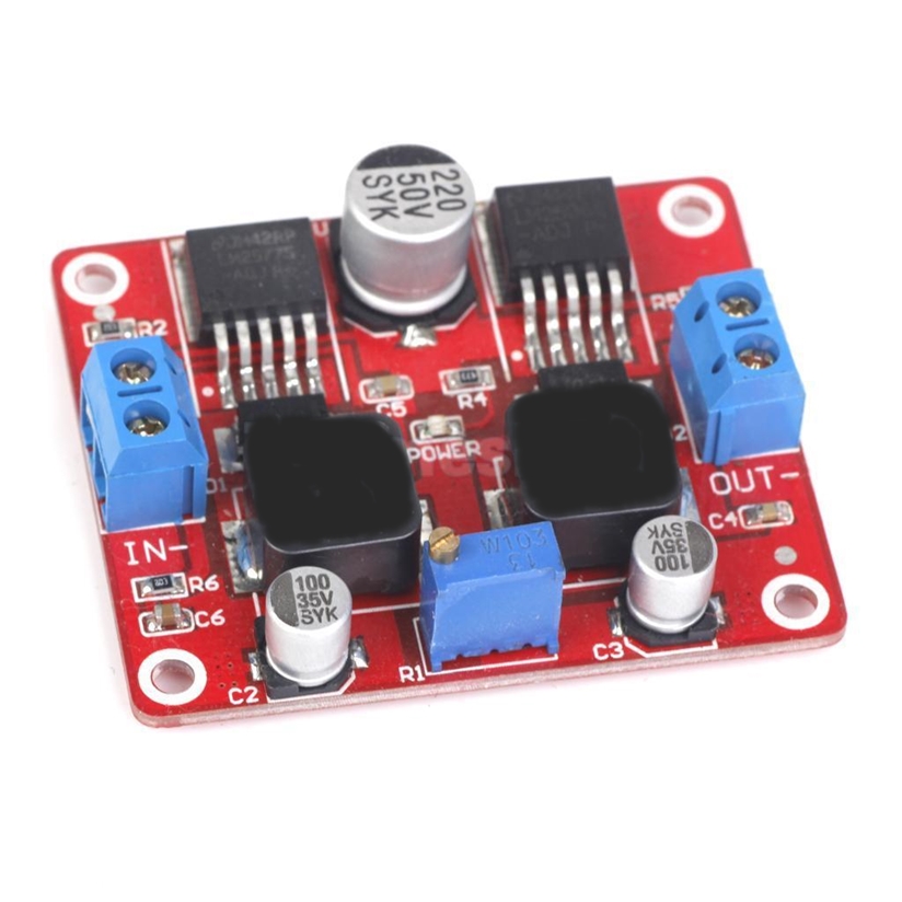

Buck booster;
Red module: 3.5-28V to 1.25-26V $ 3.95 + free shipping
Blue module : input 3V -30V Output: 0.5-30V/3A(MAX)module :$ 1.08 + free shipping too!
