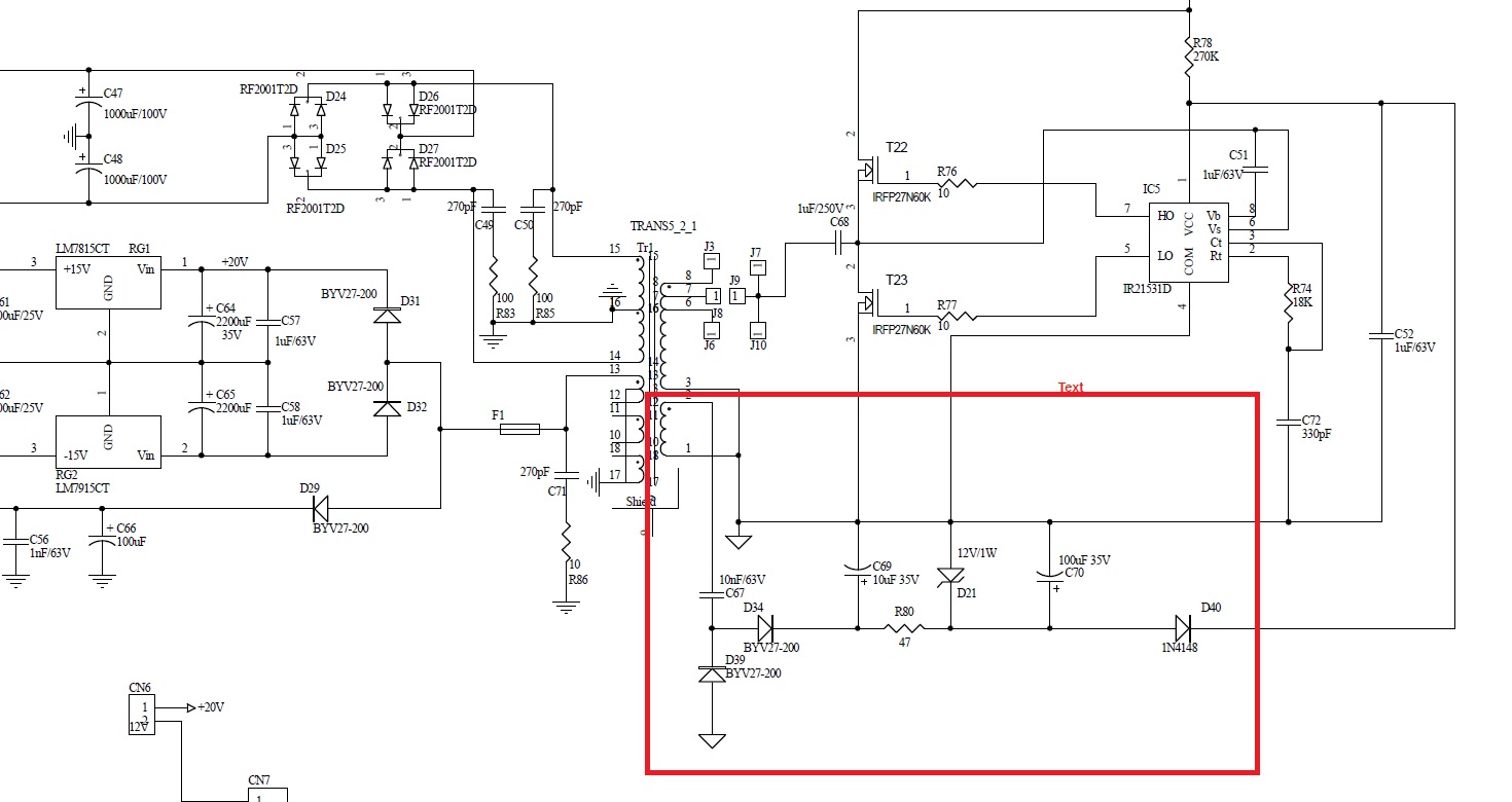

If you look at the schematic attached in the 3rd post of this topic, there is a pot (R2), from which the maximum output current is set. All that circuit - VT1, VT2, VD1, VD2 will shutdown IR2153 when the limit is reached (you can read about CT pin, in the driver datasheet).
I think that some fuses on the 80V rails would be redundant, at least.
In this diagram there is another method for limiting the current, also very efficient: a current transformer winding that will pull the driver voltage Vcc under 10V (so the driver stops) when the current rises above a certain limit.
I would recommend you to check the parts inside the red square.

All those parts have been checked OK 🙂
The question regarding the missing protection raised by f0m3 and I'm interested in are referring to the scenario described by Steve Smith, which is exactly what happened to the amp I've repaired. A faulty cabinet blew 2 output transistors and then the 2 power supply transistors. They were the 4 only parts I've diagnosed faulty and replaced.
The amp is working again 🙂
I wonder if there is a way to prevent the 2 expensive PSU MOSFETs from shorting in case it would happen again.
