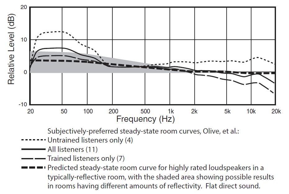

The EBU curve sounds to be quite close to the room curve preferred by trained listeners, from Olive's study (attached). Looks like a good next step
wow, havent saw that again, but yeah, it seems that the EBU curve is very alike the olive study.

Per the Toole paper and the attachment I just posted, non trained listeners preferred a room response that's tilted up in the high end, trained listeners tilted down in the high end. Olive proposed something in the middle to try and suit both.
It's a mistake to read too much into this though. Who knows what the room responses were in the control environments for the recordings used by the Olive study, for example?
If those recordings were made on a system with flat on average room responses per the Genelecs, it would indicate Olive's trained listeners like sound less hot than the recording pros that made those recordings. But without that reference: what was the in room response of the recordings used to create these targets, it's really hard to interpret any of these house curves recommendations

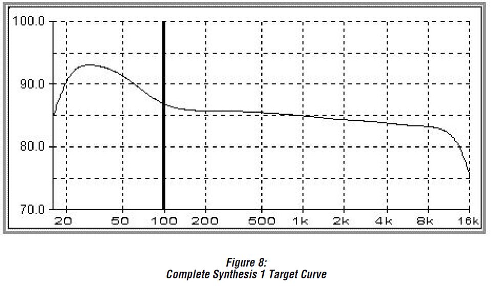

Ive been reading all week about house curve, subwoofer integration, target curves. The bass is ALWAYS boosted.
Every explanation I've read from Harmon and other industry sources is that the average home system has some bass boost because of the way average speakers and room are set up, so they recommend the same slight bass boost in the recording environment, then by extension, speaker designs should target this response in room as well (as far as they're concerned).
Looking at the responses of highly regarded high end speakers from NRC measurements, they follow this trend as well.
For home theater, its even more aggressive. Attached is JBL's recommended starting point for the room curve for home theater
