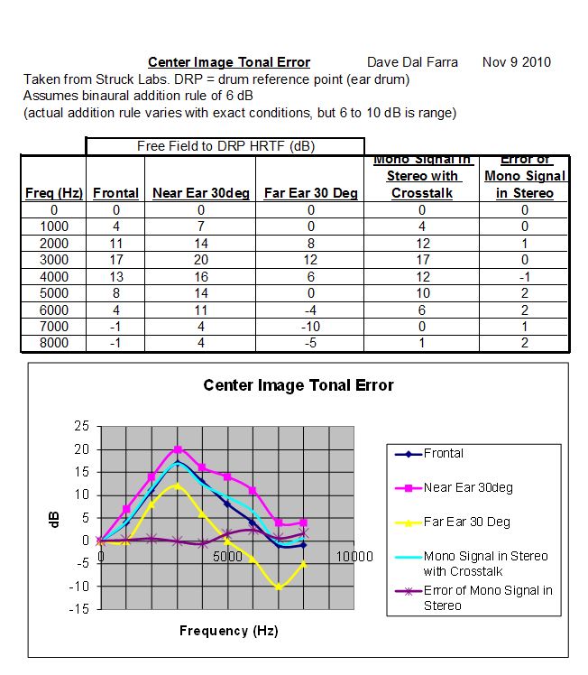

I investigated this myself a number of years back: what tonal error is introduced in stereo due to the HRTF for a central image (probably the worst case)?
Here it is attached. Either this gets "fixed in the mix" or speakers designs should modify their responses away from flat to try and strike a balance between correct tonal balance for the center image vs that for panned full left or right by applying "HRTFEQ". Given so much of the image clusters in the center, I think best bet is provide about 2/3 equalization.
I think this is one reason why so many speakers "flat" on axis sound harsh on a lot of recordings.
I hope people benefit from this information in their own designs!

Thanks Dave. Good info. I have a thread about the phantom center image tonality with a link to some useful info.
But I don't think it matters about one speaker or two for overall tonal balance. The microphone does not hear the way we do. We have two "mics" separated by a head. That changes the tonal balance of whatever we hear, compared to a single point. At least above about 1200-1500 Hz, it does.
The sum from 1 speaker or two ends up about the same.
Hi Pano. Very true that a mic will pick up a very different reverberant field than your ears will, so this is where its left to the craft of a good recording engineer to get the tonal balance right. But I think that doesn't invalidate this effect and I think the tonal balance question presents a different answer with one vs two speakers, especially for close mic'ed recordings
I certainly hear a different tonal balance with one vs two. It's a related issue, but not the same I think. Even with a single speaker what we hear is the sum of on axis and off axis ears. That summed response falls in the upper end. With two speakers things get even trickier. The upper midrange dip in the phantom center is one artifact. It's caused by comb filtering.
