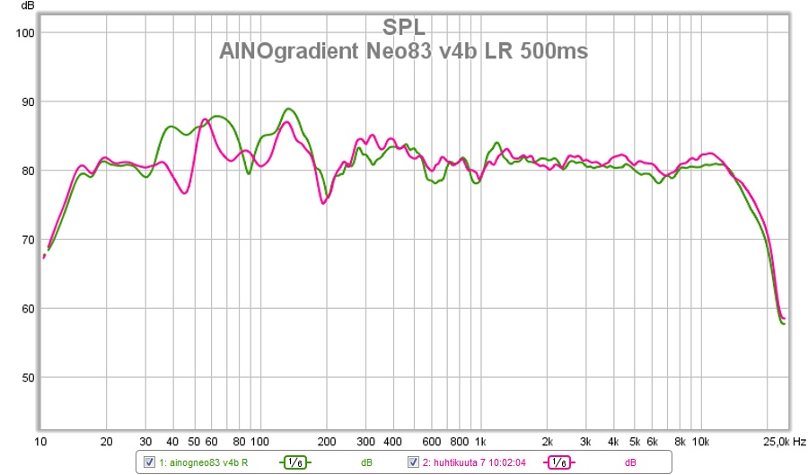

And this is my room response of a single diy-speaker, L/R (REW sweep 500ms). Pleasant, musical and natural - a verdict given by visitors

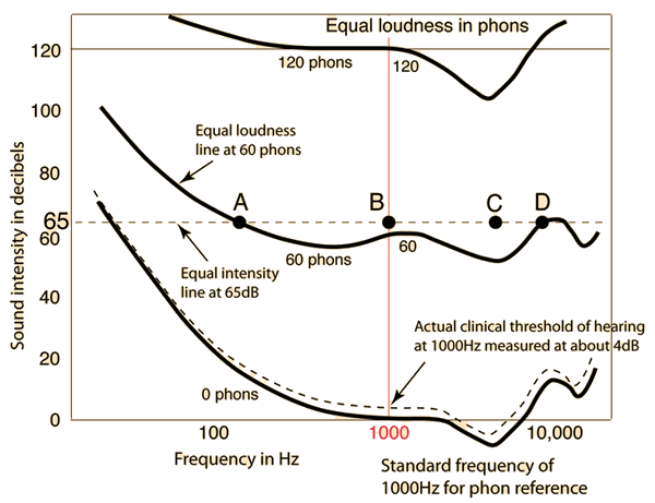

Other factors are ear/brain's loudness contour, at least I listen to much lower than live/recording studio sound levels.

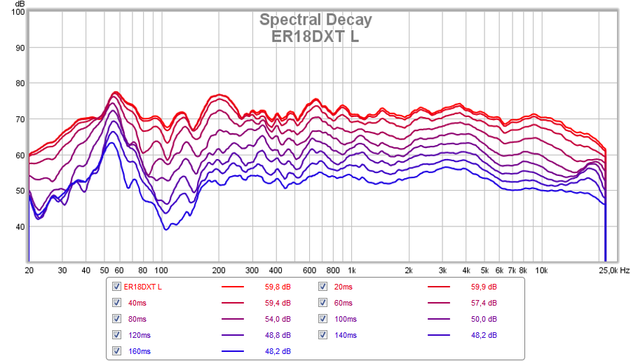

Here is decay of a bass-reflex two-way in my room (L)

I used to be in the lean is best camp, but not any more. I've been attending many more concerts in the last 10 years and they all have more bass impact and level than I was accounting for. Some of this is the Fletcher Munson effect (concerts are louder), but not all of it. eg, I try and catch 4 or 5 symphonic events yearly at Southam Hall in Ottawa. The front row lower balcony is positively bloated and so warm that an audio junkie would plug their nose at this balance in the home.

There are control room specs on the decay times as mentioned in the ITU, EBU 3276 (see Fig 1 Tolerance limits for reverb time),and other specs, but basically they say the same thing. The rule of thumb is to keep the decay rates/reverb time as even across frequency as possible, with special attention to the very low frequencies as most environments will have too much low frequency decay. Employing bass traps and/or high passing the speakers with a filter at 20 Hz will assist in controlling the low frequency build up.
Here is an example of relatively even decay for both left and right speakers measured at the listening position:
I prefer REW's waterfall display. REW, Acourate and other tools also can correlate decay/reverb time over the entire frequency range. While I have a fairly even decay at low frequencies, my room is a bit on the bright side in the midrange as can be seen with this reverb calculation:
My preference being trying to hear as much of the recording, for as long as possible before the room has it's way and masks the recording.
