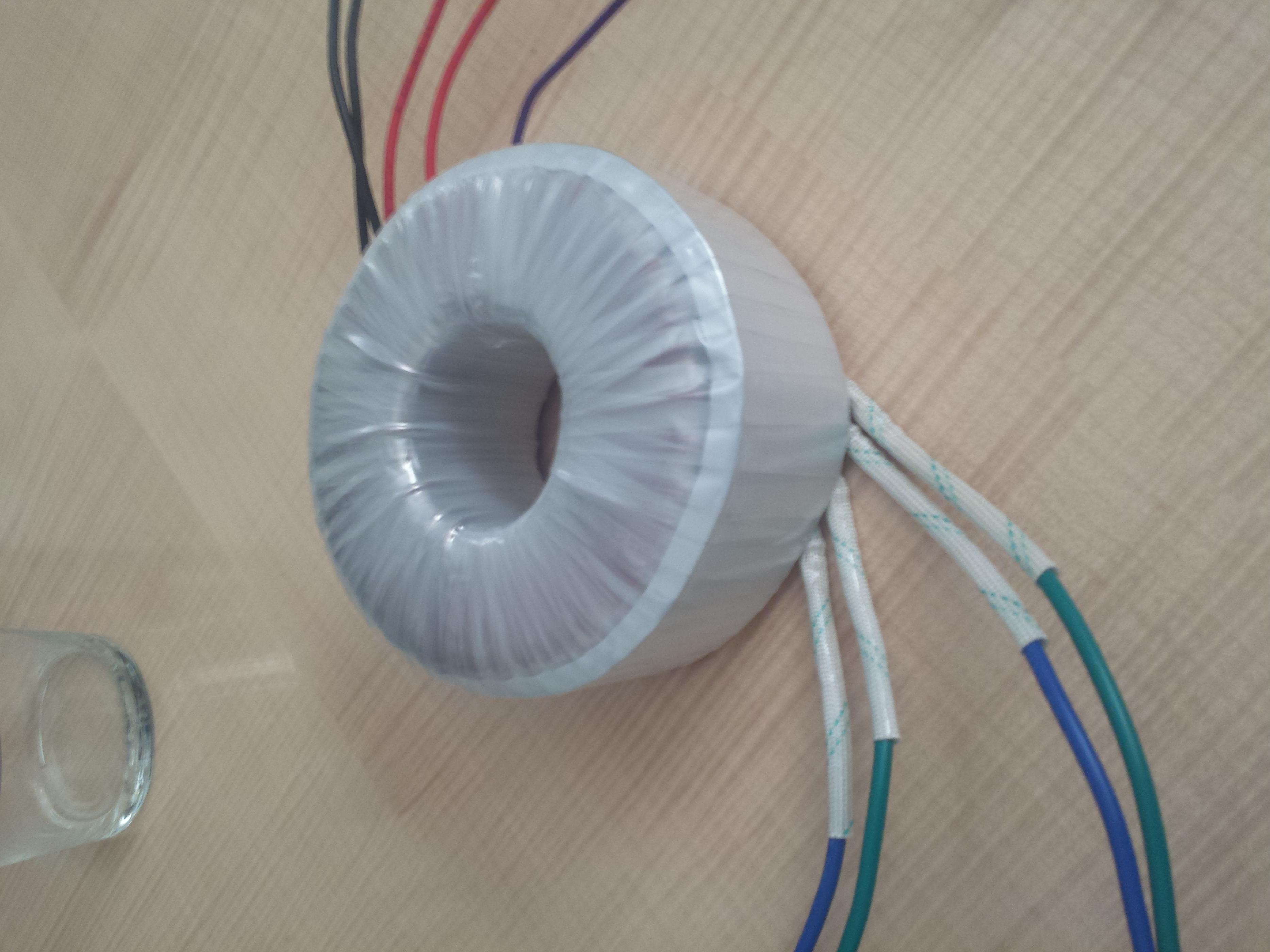

I would suggest that you have got the secondary wiring confused.
I hope it's that simple.
I posted pics of the way I hooked it up. Nobody has said it's wrong but it certainly could be.

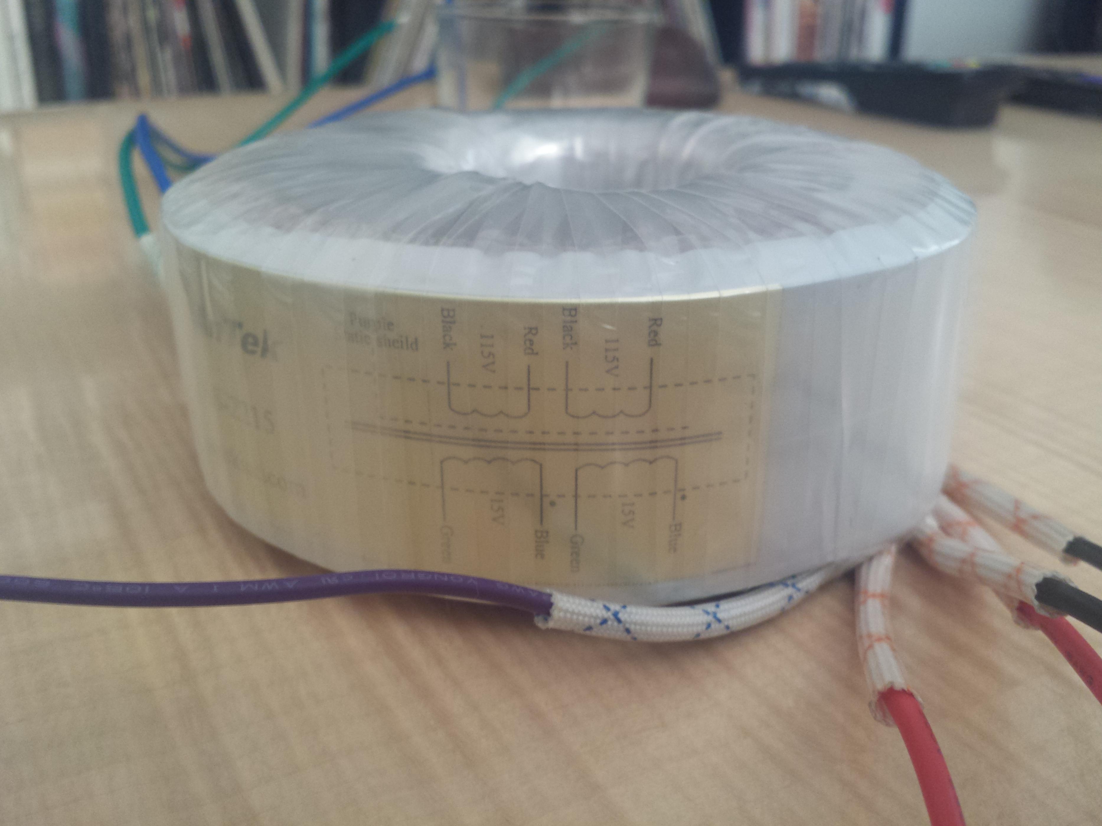

Attached is a pic of the other circuit I made a pcb for that behaved exactly like the Twisted Pear psu [this is why I don't doubt it's something I'm doing wrong]. You can see how I wired ths 2nd's if you look at the transformer pic.
On power up D4 popped and all the input traces got damaged.
If anybody sees anything wrong PLEASE let me know. Thanks!
Geez Solving a Rubix cube is easier than solving this.
As the PCB circuit in the first pic states it should be wired up as Blue Green Green Blue.
Wiring it up as Blue Green Blue Green will act like a short circuit between the two bridges.

As you've posted here.. The wiring appears to be correct.
So this is invalid:
The mystery continues!
And.. The primary can't be wired up wrong, being an American the OP is running 120v not 240v. Wait a minute.... If the OP has the primary wiring wrong then that means there is half the voltage going through the secondary, so therefore there is twice the amount of amperage going through the secondary... So, OP, have you got the primary windings wired correctly?

I get 16v off both sets of 2nd's when I keep them paired as in my last post.
12.5 and 13v if I mix the 2nd's
This leads me to believe it is important to keep them paired, but, would it cause the rectifiers to blow if they are mixed?

I believe the primarys are correct.
The two reds are twisted together and attached to Neutral
The two blacks are twisted and attached to Load.
I get 16v between each set of 2nd's

You should be getting 15-16vAC on each secondary winding.
That's what I have. If I measure between blue and green I get 16v
Right. So the problem is/was in the caps/voltage regulators.

You said that D4 popped when power it is applied meaning that you have a shorted around D3 cathode to ground. If D3 cathode it is grounded that will applied the AC thru D4 to ground. Check the solder around D3 cathode for solder bridge or check resistance between D3 cathode and ground. Low resistance means you have a short.

I think the wiring to the secondaries should be B-G-B-G and NOT as marked on the board.
I think the error is that the transformer wiring colours do not match the board markings.

BINGO!! D3 cathode is shorted to ground. Good call!
Still not sure what happened with the other board but I'll get some new bridges for that one and see what I can get.
Thanks for all the help!
Correct!
http://www.diyaudio.com/forums/twisted-pear/264381-smoking-bridges-2.html#post4112232
Brian's wiring is correct.
This is what happened to the other board.
So to proceed from this, all you need to do is check the traces of the PCB and renew them if necessary, and replace the bridge rectifiers. And wire them up as Brian has done.
I was wrong twice! wow.
OK! Second mystery solved. I just wired the Twisted Pear board wrong. 😱
Its ok I would've made the exact same mistake. This should be a lesson to everyone that Color coding is never trustworthy.
