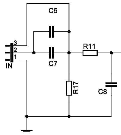

AndrewT said:
input high pass RC = Zin * (series DC blocking caps from source & amplifier)
Andrew,
Assuming zero source capacitance for the Leach Amp input (as attached image taken from Jen's schematic) when the signal input is via pins 1/2:
input high pass RC = R17 * (0 + C6||C7)
John L. Males
Willowdale, Ontario
Canada
15 December 2006 02:41

Hi Andrew,
I assume the other 1/2 I did not post was the PSU, but that was straight forward.
I chose to ask the question without knowing the source C just to make the question simple while at same time letting you know I made that assumption.
I am not sure off had with the three preamps I have off hand what their output C are. I have two SS preamps and one tube - all commercial units. I hope to build a couple preamps myself later, but preamps are not as important as starting with the amps first for my needs. The quick research I had done of pre-amps had as many varied output C as amps input C. Hence for the purpose of the real question at hand I noted I would assume the source C to be Zero.
I do have a variation on the input RC calculation due to the different input configurations. One of those variations is where the R17 like resistor is on the same side of as C8 like capacitor. With R11 like resistor between C6||C7 like capacitor(s) and C8 would R11 need to be factored into the input RC calculation? If so, how would the equation need to be adjusted?

Hi K,
I understand the logic in keeping the question simple. There are times I wish I could emulate that.
Let's take an example, and again I shall try to keep it simple and assume there are no intervening caps nor resistors between the pre output and the Leach input. This allows simple single pole analysis.
Leach input is 2u2Fand 22k giving RC=48.4mS and F-3db=3.3Hz, when fed from Rs=0ohm
Add in 1uF to the Rs and the effective series capacitance becomes 0.69uF changing the RC to 15mS and F-3db to 10.5Hz.

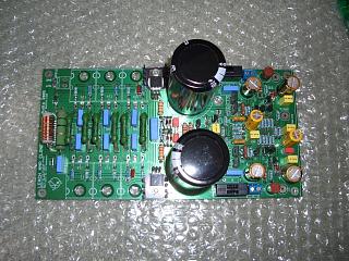

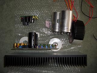

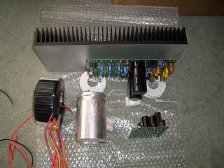

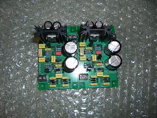

Hi all of you. Here are some pictures of where I am up to, (Yes I know I am way behind some of you) but getting parts etc is just a mission I under estimated when I started this.
Anyway the pictures show how I intend to lay out one channel and the other is mirrored on the other side. I was trying to get the input as close to the chassis and as short a run as possible and the transformer, rectifier and caps as far away. (within the cabinet of course)
I haven't bought the bridge rectifiers yet so any recomendations will be welcome.
Perhaps some of you mite like to post some more pictures of the completed amp and feild any comments on how it is sounding etc.
One last thing is that I have read most of the posts (some of which are just going over my head technically) but can we still confirm that the amp will work fine as designed by Jen's etc.
I would hate to have gone through this whole exercise to find out it wasn't going to be up to my expectations.
Regards Ian

Ian,
I have no direct experience with rectifiers as yet, but have done a fair bit of reading about them. You find two basic camps fast and normal speed and to or not to place small caps across the rectifier terminals to dampen diode ringing. My suggestion to you is to buy quality rectifiers and build a good basic PSU. It would be good to buy a rectifier if at least 600 PIV and 35 amps if you are using one rectifier to supply both sides of the rail and two modules. Also buy a rectifier that has the lugs and metal case or plate that allows you to mount the rectifier to the chasis. Chassis mount acts as heatsink for the rectifier. Although normally the rectifier will not get warm, it is costs no more and give one more level of thermal safety in the whole project "food chain" and for the possible odd exception the rectifier would heat up if it was not thermally mounted. The key is amps rating as the capacitors can strain the rectifier on start up even with a 300VA transformer. If you use a torid that adds additional strain to the rectifier evan at 300VA. Many say you need to use a start start circuit for 300VA and above. Personally I think you may need a soft start before 300VA depending on the amount of capactance in the PSU.
I am focused on a MOSFET design as most of the transistor devices for the BiPolar designs I cannot purchase locally. Obviously I will not have any pics to post.
Jens does solid design work. That said the Leach Amplifier is a proven design. Jens made great effort to update the design in terms of moden parts available. Even Professor Leach has postedf on his site alternate parts as the design age has resulted in many of the original design parts not being available or very hard or expensive to obtain. This means you are building a proven design. A design I would build as so well proven and the unsurpassed quality of Jen's PCB and design skills. You have a set of Jen's PCBs. The time, effort and quality of the board Jen's creates is one example of ensureiong your success, but the dedication of Jens. Also Jens built a 6 or seven channel HT like amplifier of this design. So rest assure you are building one excellent design with PCBs that are hard to surpass in quality and design though/experience.
As to expectactions, only you know what your expectations are. You seem to be enlightened and take the time to read the thread which is excellent and can help be aware of any important tips or experiences of others building this version of the Leach Amplifier. You mentioned some of the inforamtion was technically over your head. That is ok, just be sure you understadn what you need to to allow you o complete the build. Like a car you do not need to udnerstand all the engineering, theory and sceince to select, test and decide on a car. The same applies to the amplifiers you are building. You do not need to understand for example all the ins/outs of the PCB design and decisions made. You are doing a careful and excellent job populating and sodering the parts to the board. Clearly the extra effort you have experienced in sourcing the parts. That happens to many of us. Just be sure you are clear on all the options and their importance for you in building the project. Be very aware of the preflight tests and how you are to set up the modules. Wear safety glasses and a face shield while you work on the amp as even a small innocent device can blow right into your eye. Such cases are rare, but can happen and not be due to your assemply and preflight checking missing something. Devices can be defective and thereby cause that part or related to defective part to fail.
Lastly, just be aware you may need to play the amps for a few weeks or couple months for them to "settle in". There are many on both sides of this burn in tiem camp. Suffice to say some parts may need initial curing and depending on the type and make/model of part may take some time. PErsonally I think I have experienced this "settle in" time. Just be aware you may swear the amp is changing quality over time and may even bounce about wildly for while until it settles in. Again there is a very passionate camp on both side of this matter. I do not wish to open up a discussion about this on this thread. There are threads here that discuss this specifically where you can do more reading later to understand why this may be or why it cannot be.
Keep doing things as carefullly and with reading the thread and maybe making some copy/paste notes in file that are important in your mind. If you do nto udnerstand something then ask. I am sure what you would ask is more to allow you to complete the project and not to understand the deep theory behind. There are people here that can explain to the level you need and in a manner you need to be able to understand. I am sure you will end up with amplifiers you will enjoy your interst in music such that the amplifier is not noticed in the music you play.
missed that one.
The two alternatives do require different analysis.
The Jen's/Leach version loads up the LTP bases differently.
I prefer your alternative simply because it puts almost exactly the same loading on the two sides of the LTP, thus ensuring balance. The alternative also gives slightly less gain since the resistor ladder removes the +1 from the gain equation Rnfb/Rlower +1 giving just Rnfb/Rlower.
The input impedance of Leach/Jens is R17//[R11+C8], whereas alternative Zin = R11 + [R17//C8] and the R11 + R17 is inserted into the filter equation.
