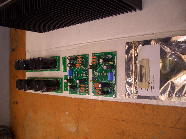

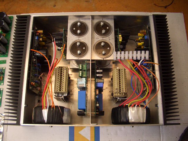

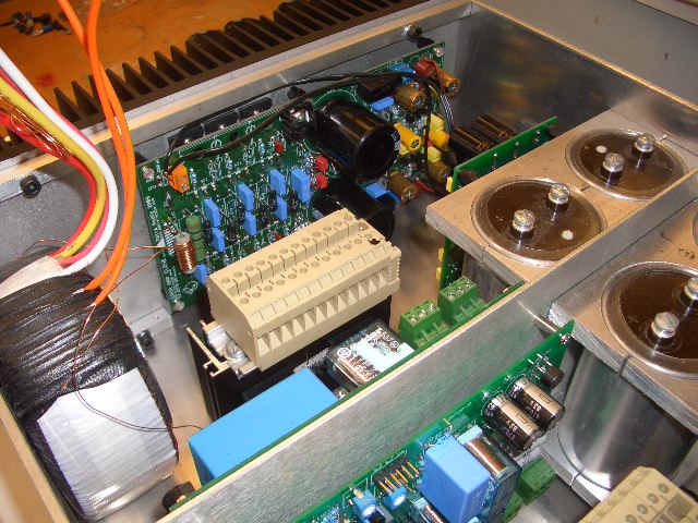

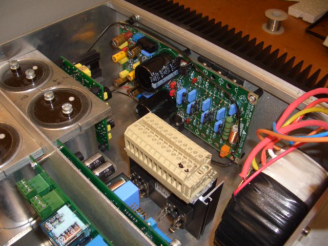

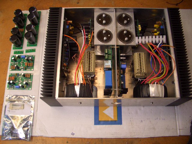

Leach Amp progress.
Hi Luke here is the photo's of progress so far. Hopefully it spurs you and others into action so I have someone to bounce questions off when it comes to switch on etc.
P.S. you might notice that there is my other project to the LHS. I am calling this the purest side of my thinking. i.e. Zen9, symetrical B1, rear loaded horns and TT!!!
Hope you enjoy.

Thats a really nice amp, what is the reg your using and I assume its for the front end? Im thinkink I will use LM317,337 for the frontend. How much to get a pair of those Conrads landed in NZ? Whats the white connector blocks for?
Hi Luke,
Hopefully it will live up to my expectations and by all accounts it should be a good one. (I will have to build some new speakers to go with it though).
The regulator is the one from Jens and Bob Ellis. It is intended as a +/- 15volt supply but with some alterations will go to 75 volts.
I am trying to upload the schematic but the file is too big so I am having dificulties.
The heat sinks were not that exspensive if I remember correctly. But I will add that as someone commented on the new thread these are not cheap amps to build. (Especially in NZ) I would have spent up to 1k on this one (mostly freight I mite add). And this has probably added to the length of time it has taken also.
But it is a hobby remember!!!!! (I keep telling myself)
Ian

Fantastic Loboone.
Yes - Hobby or obsession 🙂
Would be interesting to have someone do a writeup of their subjective opinion of the difference between regulated and non regulated frontend.

Loboone - I see Mosfet outputs in your picture but the circuit was designed for bipolars. Did you change the Vbe multiplier and gate stoppers? I have a set of boards stuffed but not tested for IRFP outputs, using a ZVN3310 in the Vgs multiplier to get the required bias voltage and swapped in 221R for the gate stoppers as the 3.3R or 10R used for bipolars won't help much.
Just trying to help keep the magic smoke in the packages, in case someone inexperienced sees your pictures and tries mosfet outputs without making changes.

Im finding that anything complex in design is not cheap and higher power levels need more outputs bigger transformers etc.
So is this using mosfets on the output, Ive never heard of this configuration on a leach.

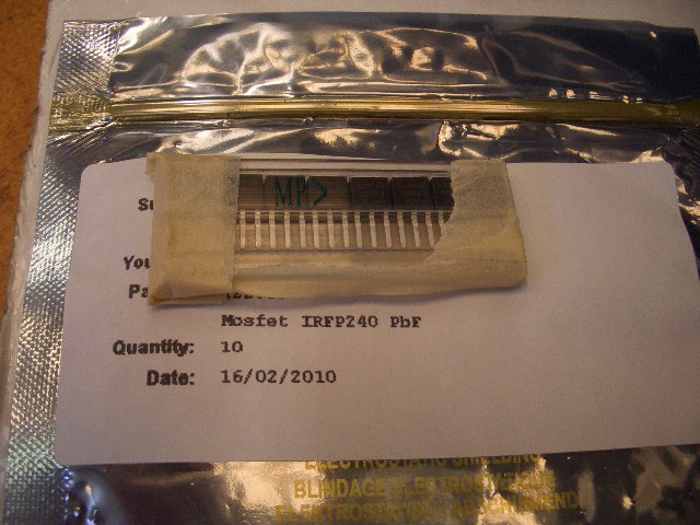

Hi all,
Sorry for the confusion but the mosfets etc to the left of the Leach are for my other (some may say dark side) of my hobby. Parts and boards for ZEN9 amp and symetrical supply B1 pre-amp.
I was just trying to show off the fact that I have some Power J-Fet LU1014
as I believe they are somewhat hard to come by!!
So if you all are thinking that I am even close to the level of expertise that you good people are you are sadly mistaken. I am I true believer in if it aint broken (or works perfectly well) why try and re invent the wheel. So the Leach will be as per plans accept for the regulated front end.
Thankyou all for the nice comments though. I would be more happy to answer any questions with regards to the amp etc.
I'll keep you all updated.

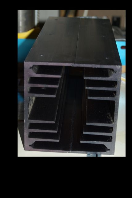

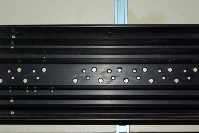

I am just getting around to the Small Leach build from 5 years ago and need some advice to proceed further. The pcb is stuffed except for the output transistors. Bob Ellis and AndrewT have helped with building a regulated power supply. Now the project is to the point of connecting the pieces together for testing, but before that occurs, some advice is needed for the enclosure. I am a woodworker so I was leaning towards a wood enclosure.
The heatsinks were obtained from ApexJr a few years ago--a pair of sinks 2.3 x 4.6 x 12.5 inches which can form a tunnel 4.6 x 4.6 as shown in the photos below. The mounting plane of the sink is 4.5mm or .175 inches thick. I have no idea of the exact cooling capacity of the sinks or even if an estimate of their cooling capacity is possible.
The enclosure, if built with the tunnel, would be too high at 12.5 inches. Would anyone hazard an opinion if the sinks would be adequate to cool the unit if they were to be cut down to about 8.5 inches. The tunnel would be oriented vertically. A muffin fan is available in the tunnel size if 12 VDC can be obtained to feed it to help augment the heatsink cooling. But whether a fan is advisable or not is another question.
The output transistors positionally mount on top of the heavier and deeper fins of the sink. If you see any obvious problems with the pcb feel free to comment as well.

Another project for you - find a temperature sensitive fan controller circuit. Rod elliot has one and there are a few here, including a two speed controller. Mount the sinks horizontally and have a fan kick on only if they get too warm. Burying the fan inside a wooden case will help keep it quieter, although it probably would be slightly more efficient sucking air through the sinks.
I have four channels of Leach amp (V4.5 on Leach boards) on those sinks mounted horizontally running at ~100 mA bias each for 45W. The amp gets warm but not hot in normal use. Although I haven't really driven it hard I hadn't connected without a fan until recently. I'm using a 10W 120VAC fan - I don't remember its flow rating, but I cranked the bias up to 750 mA/channel (~330W) and the output end of the sink gets to about 50C (after an hour I can put my fingers on it for more than 10 seconds, but it is hot). The amp is doing double duty, making music and giving my bhut jalokia and other hot pepper seedlings nice warm days in my indoor hot house. Another month or so I'll turn the bias back down when it warms up enough to move the plants outside.
The challenge would be to balance the size of heatsink with optimal bias vs temperature. With the thermal compensation diode feeding a fan controller circuit from ESP site that could make this automatic is definitely worth the look. This would be used to control fan speed.
Vertical sink tunnels are best. They need the least power assistance to achieve a certain cooling ability.
Blowing the sink is more efficient than sucking.
Blowing also exposes the fan motor to cooler temperature.
An early Pass had blown vertical sinks. Was it the *40?
Three temp switches on the sink would be great. all off = fan off.
first on = slow fan. Second on = fast(er) fan. Third = power down.
or use a variable as Bob suggests, but still fit a power down switch, or at least a loud/bright alarm.

The heatsink tunnel is more efficient vertically but fan-driven horizontal orientation is just fine especiallyif Bob can run 4 channels off these sinks instead of the 2 that I`m using. I don`t have a greenhouse to heat either.
