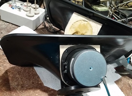

BTW, I think I never got around to mentioning it, but the "Durham's Rock Hard Water Putty" worked very well for filling the volume between the driver and the waveguide. "Rock Hard", they aren't kidding, it's like a piece of ceramic.
The only down sides are that it takes adjusting to get the consistency right (add water -- too much!, so add more powder -- too much! so add more water....repeat...). And that it is kind of messy. The stuff is yellow and leaks down inside the waveguide, so you have to make sure to clean there with a wet rag before it hardens (which happens before long). After it hardened, I took a black felt-tip marker to blacken any of the yellow that showed through the midrange ports.
