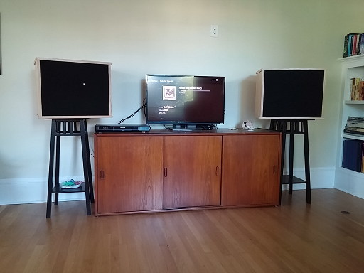

Thanks, Eldam! I'm pretty sure the wife likes the smaller ones better (big surprise, right?). But that's ok, the not-as-small ones sound better in my downstairs listening area, there's a room peak upstairs that I could EQ out, but haven't got that far yet.
Don't like the stands? (They're IKEA plant stands...). My wife picked them out, so I'll go with what she wants. I wanted to make some natural oak stands to match the cabinets, but will probably only do that for the downstairs system.

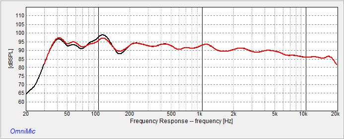

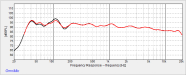

Hi Damian,
I did a measurement (about 3ft from the baffle) today so I could work up an FIR phase eq for it. Here is the response, with (red) and without (black, no EQ) some mild PEQ I added for in-room bumps. Sorry, I only saved 1/6th octave curves, since that is what I was adjusting the FIR EQ with. The bump near 100Hz is from the speaker itself (interaction between crossover and the driver impedance), the dip is floor bounce.
I'm very happy with the sound, though it makes me even more bummed about the tweeter being discontinued. I haven't gone outside to do polar measurements, but the on-axis is very close to the same as the sealed version, as is the sound (except for more powerful sounding bass). I did tweak the crossover a little (the same should probably be done on the sealed version). C3 and R1 change a little. Not sure if it can be heard, but the midrange gets a little flatter, at least with the particular instances of drivers I used.
If you're going to use a DSP EQ (so you can apply a Linkwitz Transform), then I'd just go ahead with the sealed version -- I can give you a configuration file for the MiniDSP 2x4HD (including FIR EQ for linear phase on either the sealed or the shelf ported).
