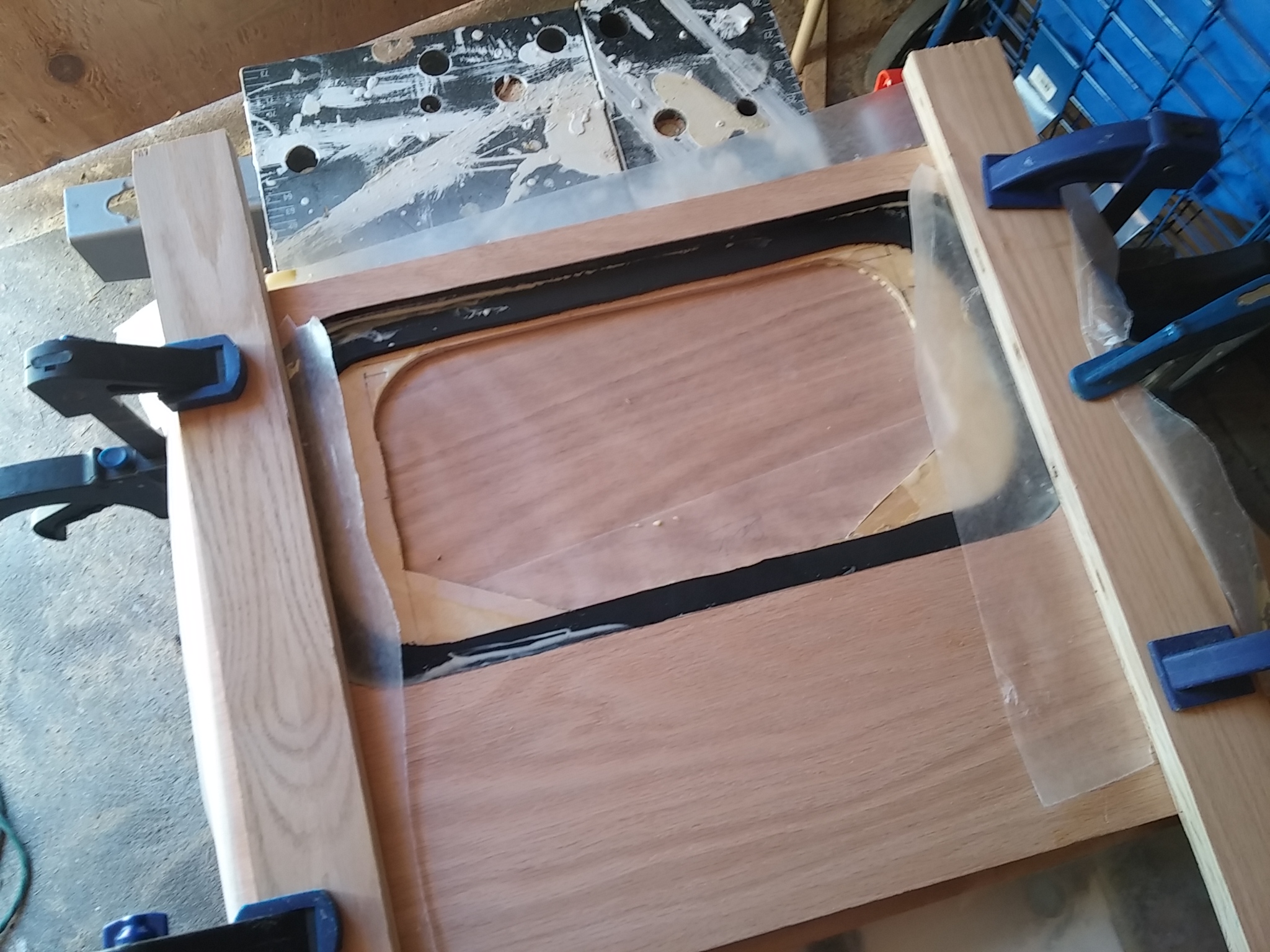

I don't know where you are in terms of wood cutting and glue, but some things a i learned along the way--
Glue to use: Titebond I. With lots of clamps, preferably. Clean up squeeze out with a damp cloth.
To keep glue from bonding to clamps and surfaces, use wax paper between. Particulay when laminating the baffle, clamp against a back panel piece
