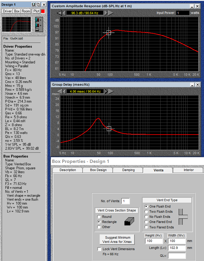

I tried to sim 8FE200 woofers, I need them to work from 90hz and they seem to provide a little more bass than 6FE100. What you think?
Thank you.
