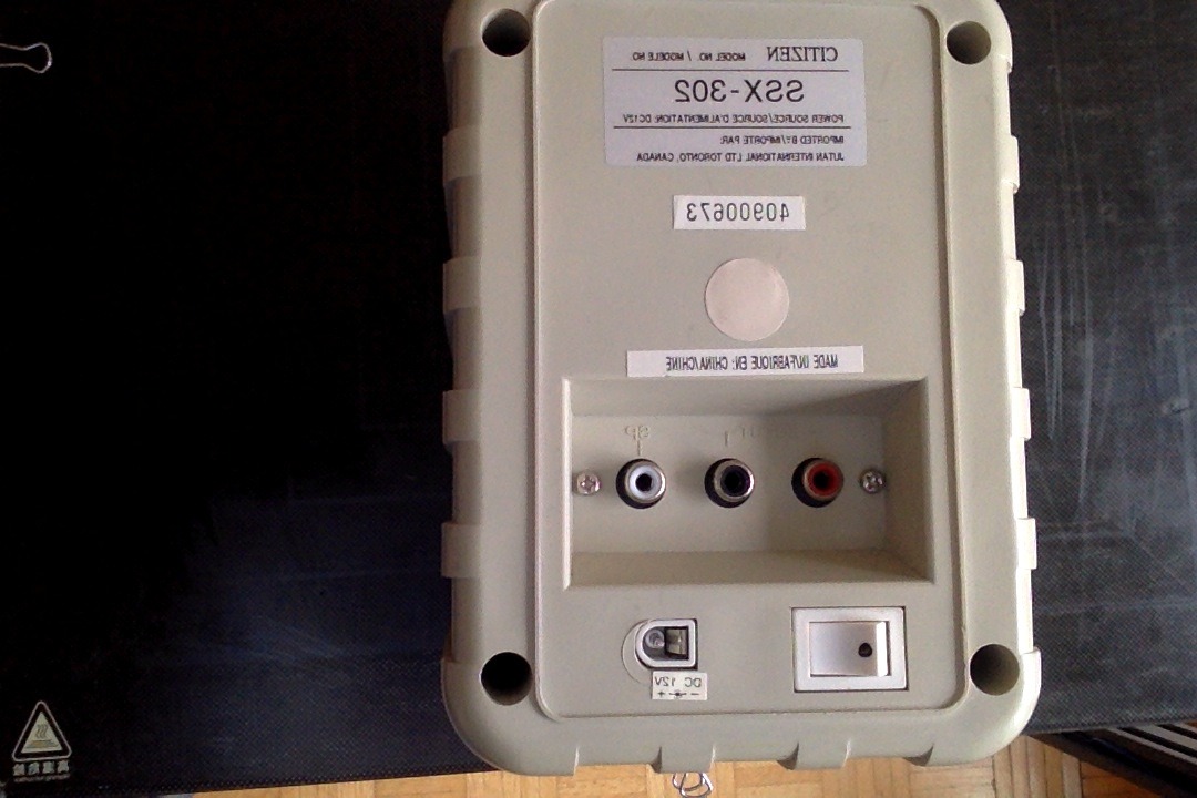

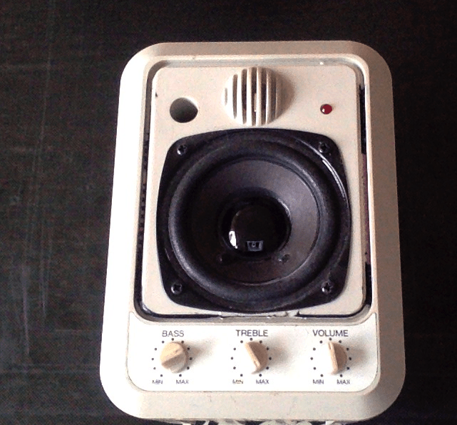

I have a pair of very cheap Citizen computer speakers. As reference they give me more then enough bass, but it's a bit muddy and poor high end.
Is this what you want. That bass, with better high end?
Can we see them, or get a model number.

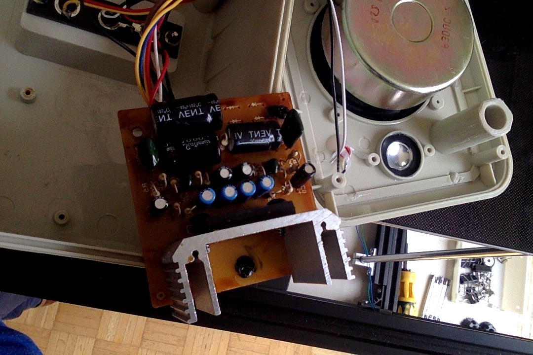

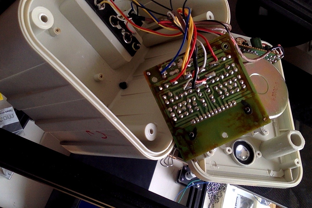

The cheap speakers I have, I googled them they do not exist, 20 years old, drivers are not made anymore “p3duc” the amp is this one:
https://quasarelectronics.co.uk/Item/3090h-3w-stereo-amplifier-module-ba5406-with-heatsink

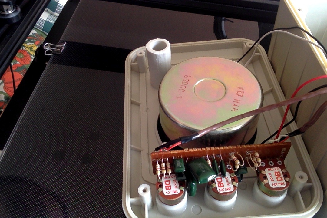

By the looks of it since I have tone controls it’s most likely up 28db gain on bass not sure f there is a shelving filter limit on that 28db.
When I crank the speaker volume all the way and my macbook to it’s max, no distortion, but I can see my the cone it’s at it’s max, any more db something will happen to it. Amp says it’s up to 85db, I’m just guessing that it’s playing somewhere near 80 - 85 db max.
Bass boost at 70% is where you can hear kick drums and bass guitar nicely as far as even level with high end frequencies, Treble is to it’s max, but still not clean too muddy, well it’s all muddy, too much color too much warmth.
The irony of it all, it’s perfect size driver, exactly 76mm (frame) paper cone, hard to measure X-max, I’d say under 3mm for sure.
I hooked up another 4ohm slightly bigger 89mm driver full range as well to see if it’s the amp that giving it color but it’s rated 10 Watts, it has more high end more balanced overall sound but it’s volume is so low I can’t bring it up to figure out which is which, the paper cone is thicker so I suspect its eating all the mid and low mid frequencies with that thickness.
In any case the driver is not the issue here, I can addition many drivers, the key is to sort out the active system as far as less color behind the drivers.

I thought about an array as well, with 3 or 4 2" drivers, the problem is I do not know the math on it, meaning if cone size of 2 x3" is the same as 2" x 3. Aesthetically MTM looks the best at such a close range, plus I have no idea how can 3 or 4 drivers work in synchrony without delays in a closed cabinet. I suspect one could push the air and it would pull the other one out, the more drivers in parallel the more chance they will play out of synth and more chance of mud in the middle.
Plus having multiple drivers play the full mid range is also unknown to me how muddy it will be so it becomes more difficult choice……. do I use two for low end two for mid, or three for low end one for mid....too complex on crossover and amp configuration. I mean requires more trial and error. Plus the choice on 2” - 3" drivers with 16 or 32 ohm rating is very limited.

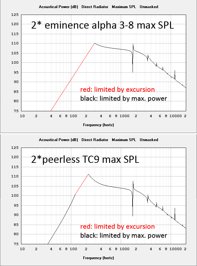

your specifications, if I remember correctly:
  • two 3" drivers
  • closed box
  • no high excursion drivers
  • bass extended down to 50 Hz via shelf filter
assuming two 3 inch drivers in closed box, 2pi radiation (box standing on a table or near the back wall which increases bass output) this results in maximum SPL at 50 Hz:
with 0,5 mm excursion: about 65 dB
with 1,5 mm excursion: about 76 dB
with 5 mm excursion: about 86 dB
furthermore assuming a music crest factor of 12 dB and avoiding high distorsion at peaks you can listen to music containing bass down to 50 Hz at an average level of:
with 0,5 mm excursion: about 53 dB
with 1,5 mm excursion: about 64 dB
with 5 mm excursion: about 74 dB

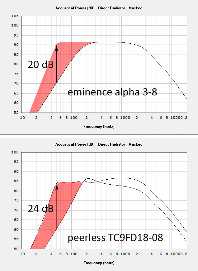

What dbs can I expect from these two drivers in the 50 -100hz range with a closed and stuffed cabinet, no passive radiators an no ports, not sure how you guys calculate stuffing, do you double the cabinet size?
for a closed box the maximum low end output only depends on air displacement, independent from stuffing or box volume.
for an additional octave of lower extension you need 4X the air volume (+12 dB).
for two 3" drivers with 2,4 mm X max this means:
max SPL @ 100 Hz: 92 dB
max SPL @ 50 Hz: 80 dB
Ok, we're back to square one then, my target was 50hz at 80db, I can probably live with maybe even 75db, does that mean I can get there without boosting the bass by 12db, if we take out your Crest Factor. As I understand it, Crest Factor is not an issue here, I do not do any mixing or mastering, music is already mastered so I can't see where all of a sudden something in a fully mastered song will jump out by 12db more then the rest of the sound. Sure some songs are louder then others but if we set the main volume to cap everything at 80db, then nothing will get thru past that limit. In fact with MP3/ Youtube logic would dictate it's even more compressed with less peaks and valleys.
if that is your target - perfect, your are fine!
that will depend on the parameters of you loudspeaker driver and the enclosure volume.
give me your driver TS parameters and the planned box volume and i can tell you how much you need to boost the bass for even response down to 50 Hz.

ok, so sealed cabinet for two drivers with (exterior) dimensions 3,5" * 5" * 12" and 1/2" wood: around 1,7 liters.
increasing the volume helps, but will need much bigger size for relevant change.
eminence alpha 3-8 has a smooth response and rolls off below 200 Hz, you will have to boost to a maximum of around 20 dB at 50 Hz.
peerless TC9FD18-08 will have a more peaky response around resonance frequency because of high Qts and will need a boost to a max. ~ 24 dB at 50 Hz (and some further equalization).
very rough graphs below:
  • response with needed equalization.
  • max SPL following the data of spec sheet (Xmax and 30 W max. power)
Are we boosting both by 20db? What if this was tri-amped, are we boosting each driver by 10db? More importantly is x-max the main limitation? I'm looking at Alpha 3-8, it's shorter x-max then Peerless but needs less boost, how is that possible if X-max is teh king of all measures on how much air you can push out?
For example they have a 32 ohm version:
https://eminence.com/collections/em...n-standard-series-speaker/products/alpha_3_32
So if we had more power, can we push it further with less gain to get to 80db?
yes, more or less.
no, total output must be boosted by 20 dB (10 * voltage and 100 * power);
it makes no difference how many amplifiers you boost. the ratio is always the same.
you can see it on my graphs: red line is X-max limit; black line is power limit (thermal limit for voice coil).
it differs for the drivers:
eminence is more efficient, so will produce more SPL with 1 W.
but it will also reach x-max with less power, because it travels more with same power and it also has less x-max.
eminence drivers will need less power but will sooner reach the x-max limit.
it's like having a car with a powerful engine but weak tires. it will accelerate quick, but the max. speed is limited by tires.
the other car with weak engine and good tires will accelerate slowly but may reach a higher V max.
ok, not the best comparison...
