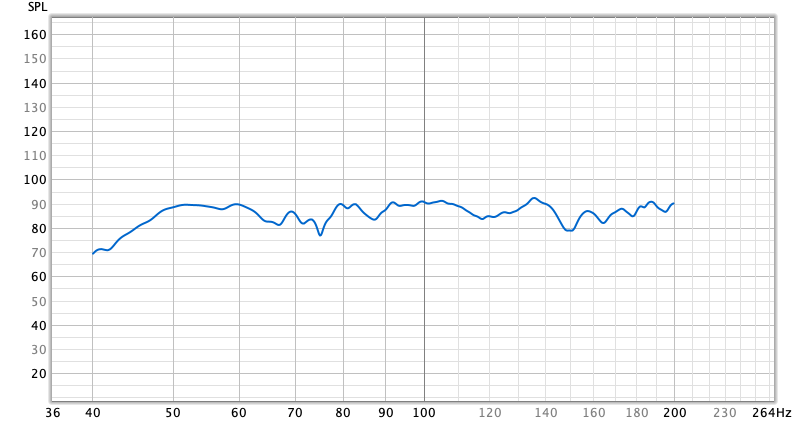

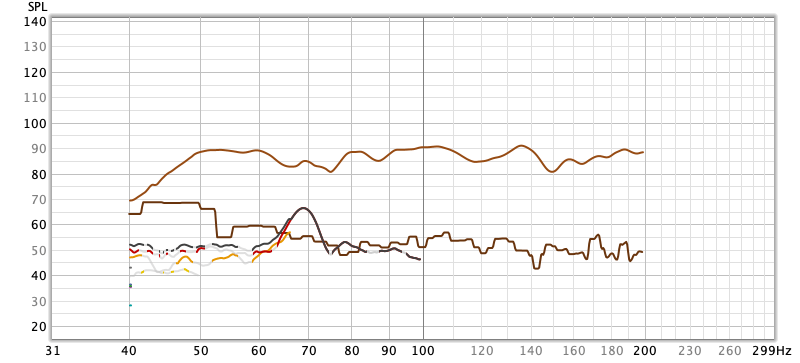

Here is the LF frequency response and distortion
You can see the distortion rise at 70Hz - this is due to a null in the response caused by a bay window, so we need even more power here
Brian
