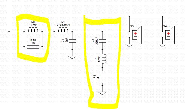

Ok, another question, someone else outside of this forum suggested this Passive approach, but did not have time to explain, his exact quote was:
"If you use an inductor (coil) in parallel to a resistor, you should get the desired result.
The resistor is in series to the two 3" speakers and reduces their output for all frequencies, however the coil is a short for low frequencies, therefore the bass will not be lowered in loudness.
Play with the two values of L (inductivity) and R and you should be able to find the balance point"

It would be a passive shelving filter for a loudspeaker with straight impedance plot, but as the impedance of a driver near resonance is everything but flat you will get a weird result.Is this a viable alternative vs Active Shelving Filter?
(Edit: and the inductor would have to be huuuuuge)

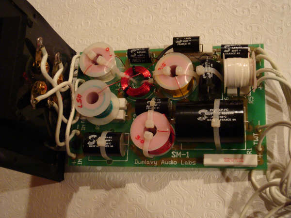

Define the word “Huge” .....Am I correct to assume that if we go back to that Dunlavy SM-1 cross-over where we know it’s 6db first order and it’s passive, it sure looks like he has a lot of inductors. Is he solving the same issue as far as, instead of one huge inductor he has multiple smaller ones in parallel?

Back to inductors:
Your speaker will have a 2nd order rolloff towards low end and you want to compensate that.
If you want to compensate for rolloff above 50 Hz and assuming 4 ohms (low impedance keeps inductors low) you will need a 25 mH inductor.
Nothing in your picture will come near that, as far as i know - usually such inductors need iron cores.
It's a very unusual method for many reasons - "not natural way of doing things" in your words...
(Edit: And keep in mind, this would only work for an impedance compensated driver - more inductors necessary here!)

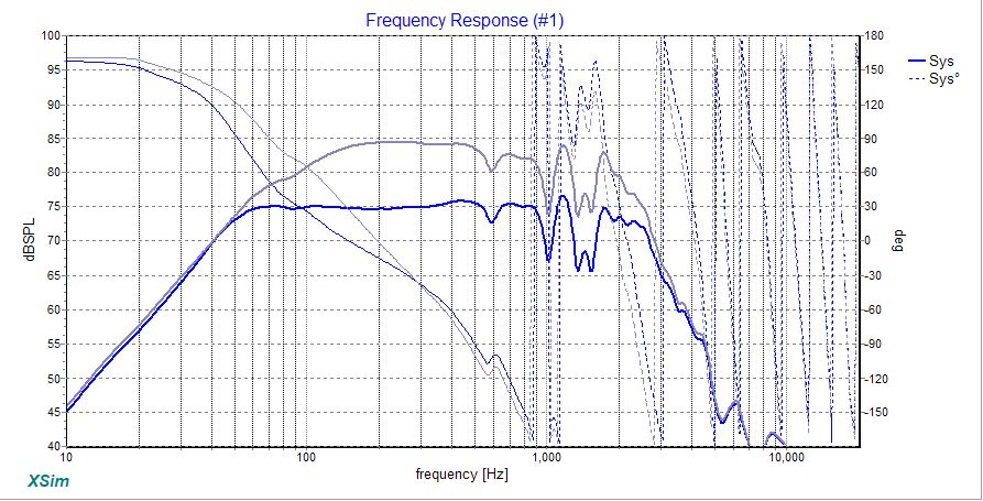

Here's an example of what stv was describing.
The grey curve is with just a straight forward 2nd order low pass filter. To get the blue curve, I needed to use both a shelving filter (parallel inductor L8 and resistor R10) plus an impedance compensation filter (series capacitor C2, inductor L2 and resistor R1). Inductor values are getting a little large and may need to get larger depending on the particular drivers you end up using and how you wire them.

@k’n’h: why do you mention the dunlavy crossover? That system is in no way comparable to what you are trying to accomplish.
