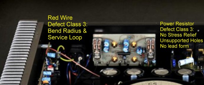

That wasn't so bad Bonsai,Here’s the review. There are others but I’d really have to root around some more.
but I think these might be the most obvious,
sadly our "reviewer" missed them.
Same here.
