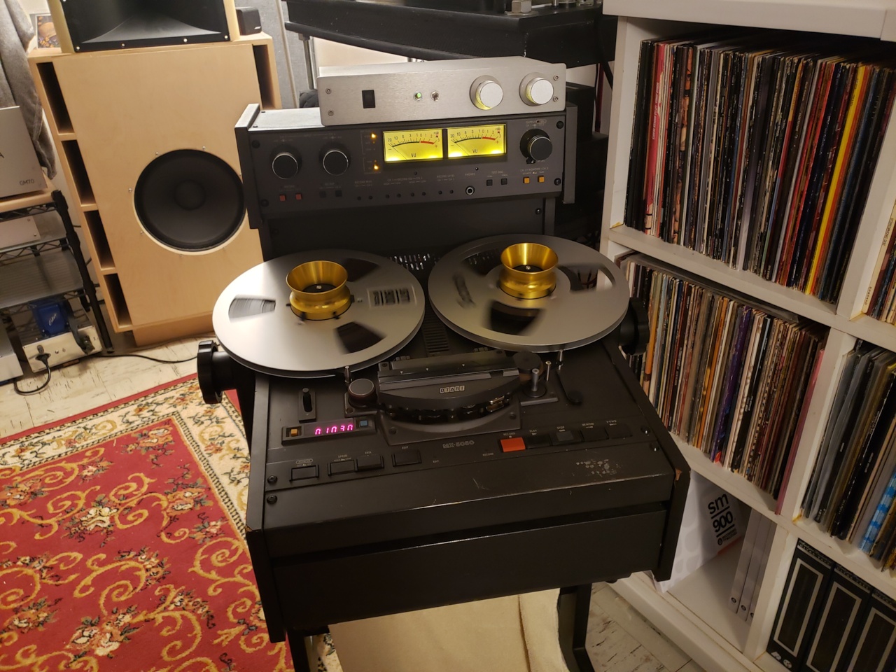

I own two MX-50 which I basically restored as stock. The nicer of my 2 units has a recently serviced head stack.
I also own an MX-5050MKIII-2 which came to me as a basket case and I've completely overhauled and done extensive modifications to. This machine has SAKI heads on it. I'm also experimenting with a tape replay amp I designed and built last spring. (Supports 7.5 and 15ips playback with either IEC or NAB eq.) In my opinion it sounds significantly better than the modified replay electronics in this deck, unfortunately none of my friends have heard it yet.
