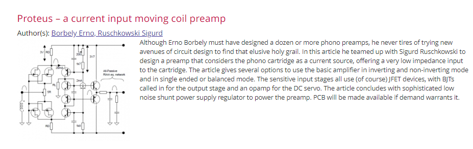

As far as I know Dr. Noburu Tominari of Dynavector was the first to propose using the MC cartridge as a current source and amplify the current from it.
"Current amplification, also called Current Injection, or CI, is of course the same as a current to voltage (I/V) converter for DACs, except with DACs the source resistances and current levels are higher. Current outputs of moving coil cartridges vary considerably depending on the coil windings of the cartridge. In general, the lower the internal resistance of the cartridge (10 ohms or less), the better the cartridge tolerates the short and produces a usable current output. Many of the higher internal resistance cartridges sound constrained by the shorted output and do not benefit from current injection. However, with the right low internal resistance cartridges, listening to a current injection phono preamp opens the listener to a beautiful new experience of vinyl music without magnetic distortion."
Regards

For me current sensing is a different approach (I like different), better or worse, i'm no expert to say that, that's why I suggested in the first place. In any case, some of the current sensing phono preamps got great online reviews and I have not seen any diy approach on that. Some of the claimed advantages: no need for resistive loading, ultra low noise amplification.
Have a quick look on Google Patents. Famous phonostage design guru John Curl took out a patent on a transimpedance (virtual ground) MC phono cartridge amplifier in 1976 (!!).
Its noise is remarkably low, and -- hallelujah -- the semiconductors used to build it are still in Active Production today, 43 years later. In thru-hole packages. diyAudio member "bonsai" included JC's circuit in a "bake off" / "shootout" thread of quite a few MC phonostage amplifiers. Spend some time and look for yourself.
Thanks you for suggestion Mark. I will definitely look into in 🙂

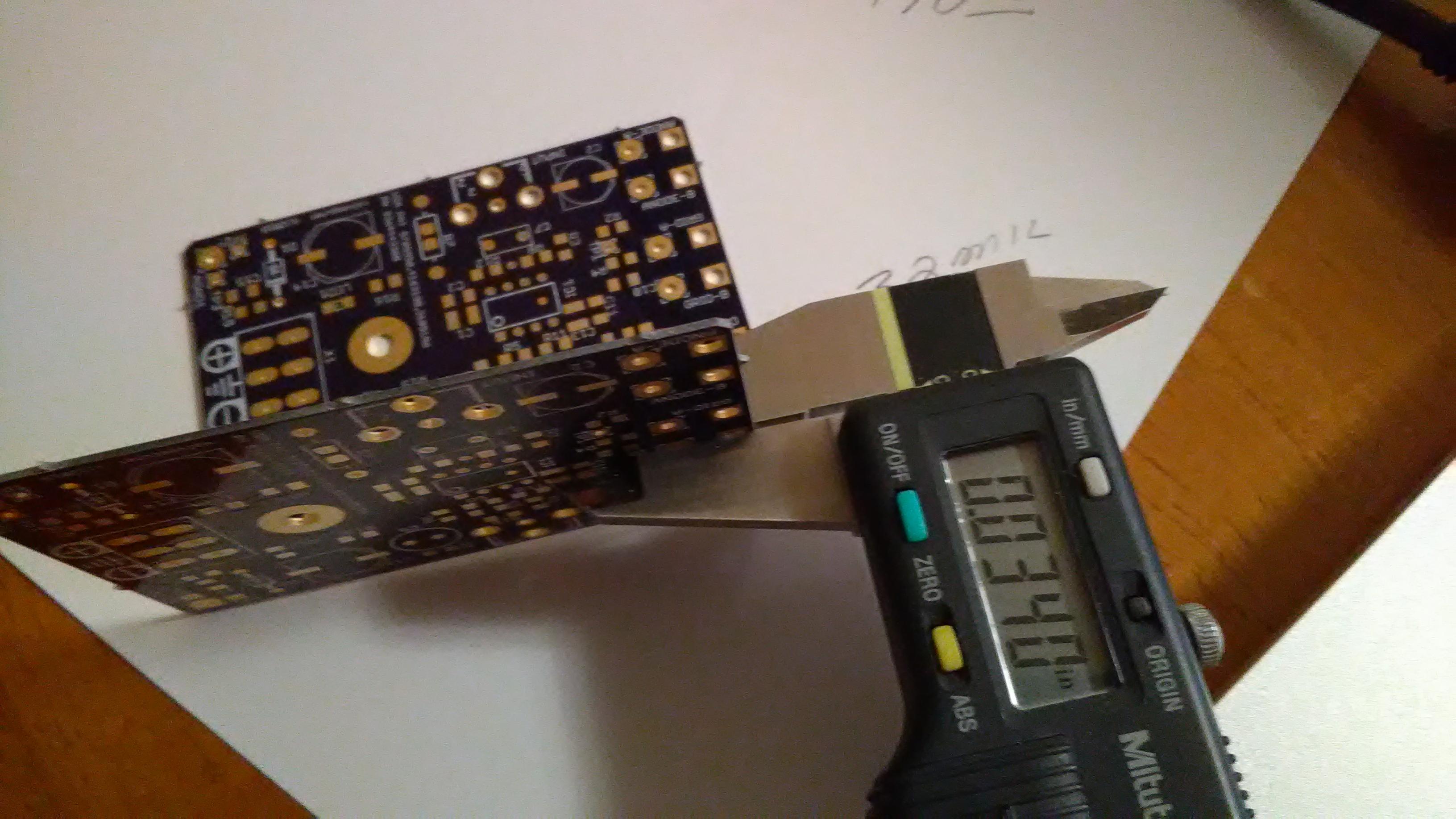

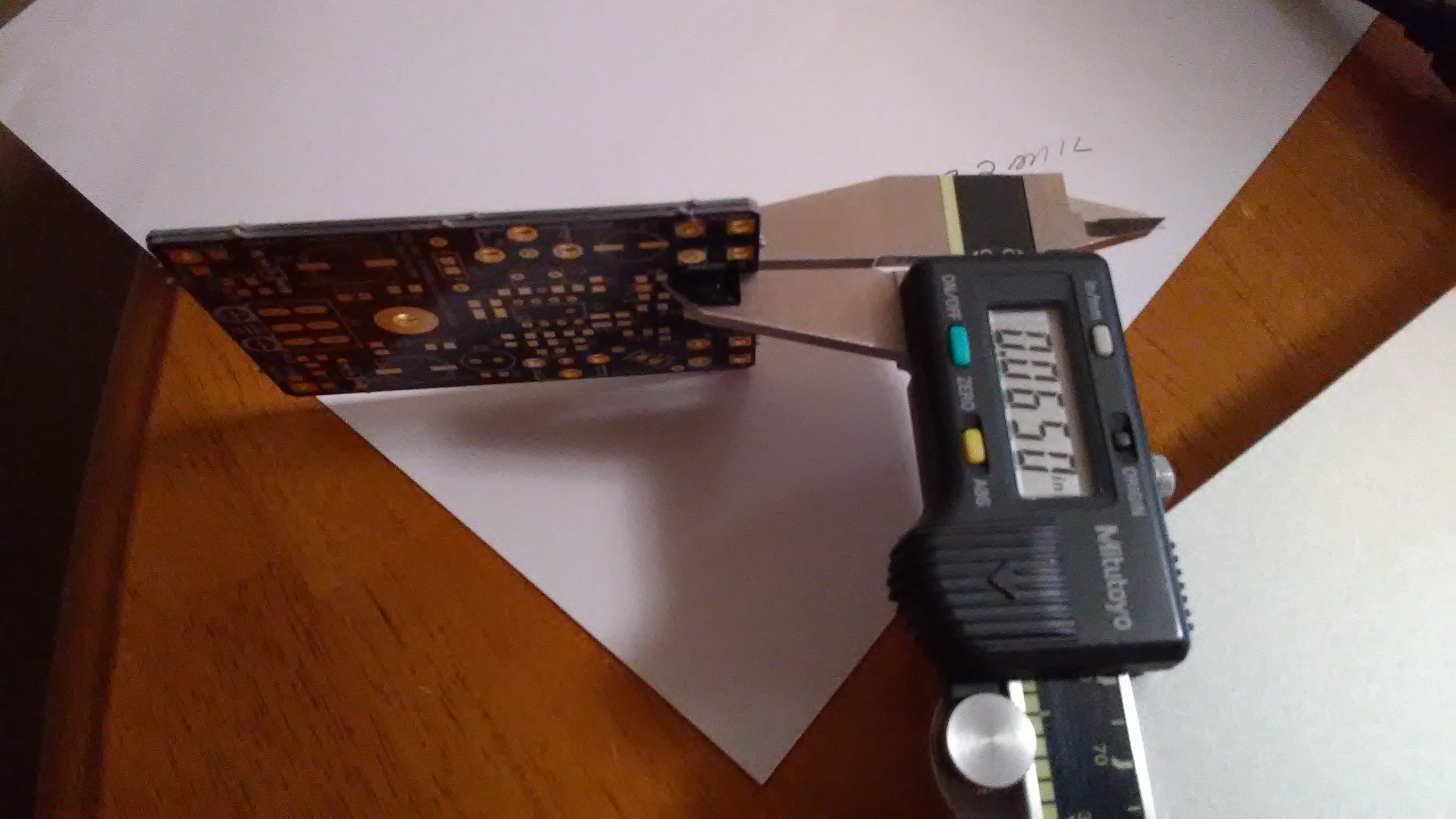

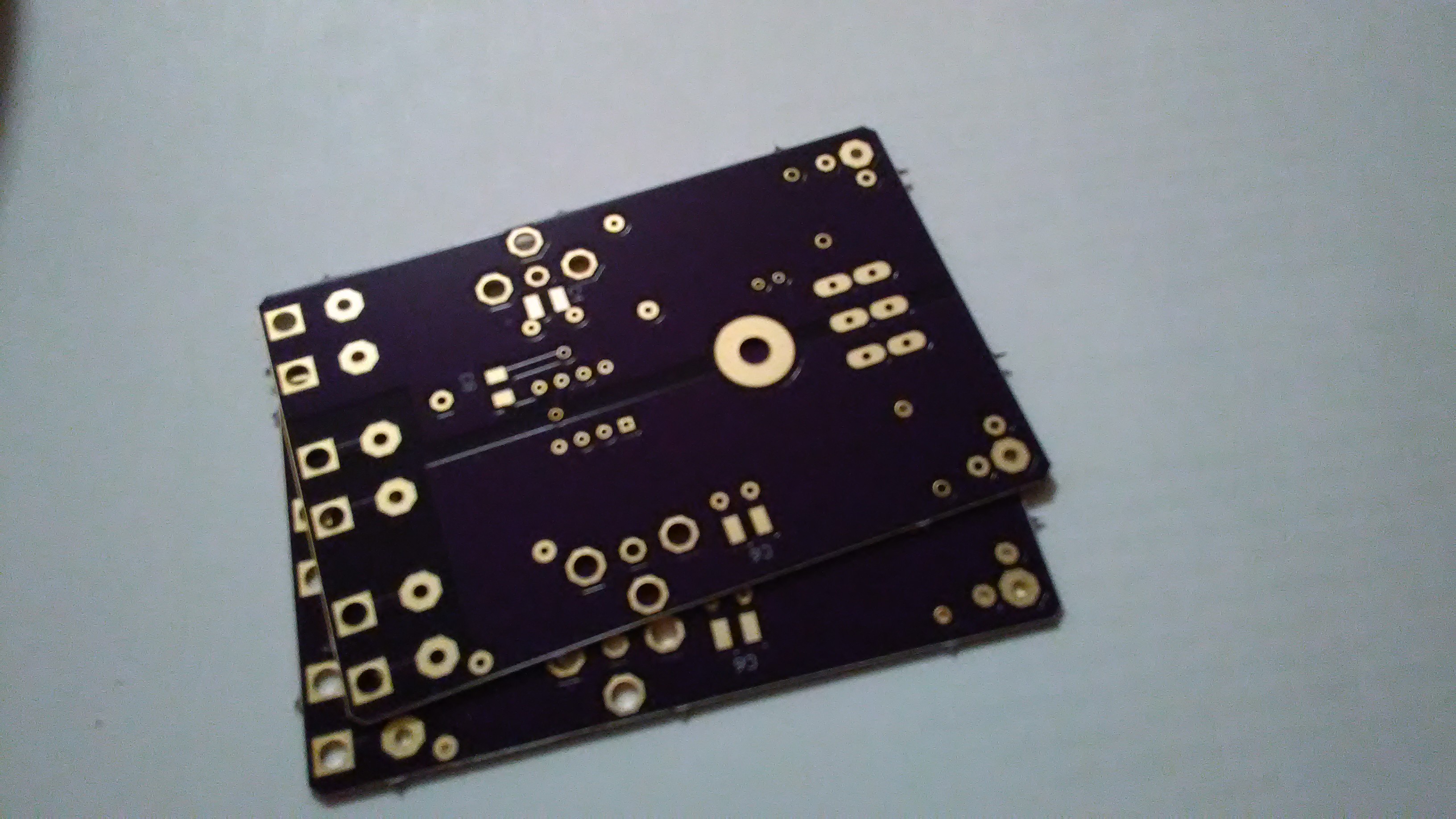

I'd call them 2.5 layers if its wire links for the 3rd layer, less confusing (!)
Yes its open to new descriptions such as 2.5 layer and 2.5 clamshell.
I think it can be useful. Possibly securing some ip.
Have to think some more on options.
This pic is of two 2oz copper 32mil boards.
