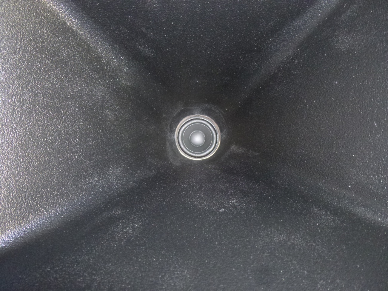

Is there a detail of the throat shape when FR drivers are mounted to a wave guide? The need to match the CD exit angle would seem to be absent but experience rules over speculation.

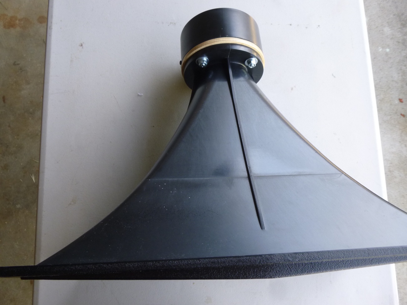

I've been playing around with some more horns and 2 incher's.
This time the Eminence Alpha-2. Mated to a JBL clone I believe. 17.5" x 11" x 12" found here 11" x 17" ABS 2" Bolt-On Long Throw Horn 90deg x 40deg For Many 2" Exit Driver 647356202421 | eBay

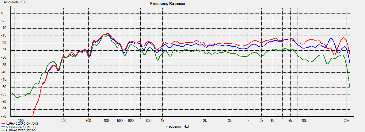

How does it hold up off-axis?
Here you go...

93dB @ 2.79V 3ft.
PRV WG45-50

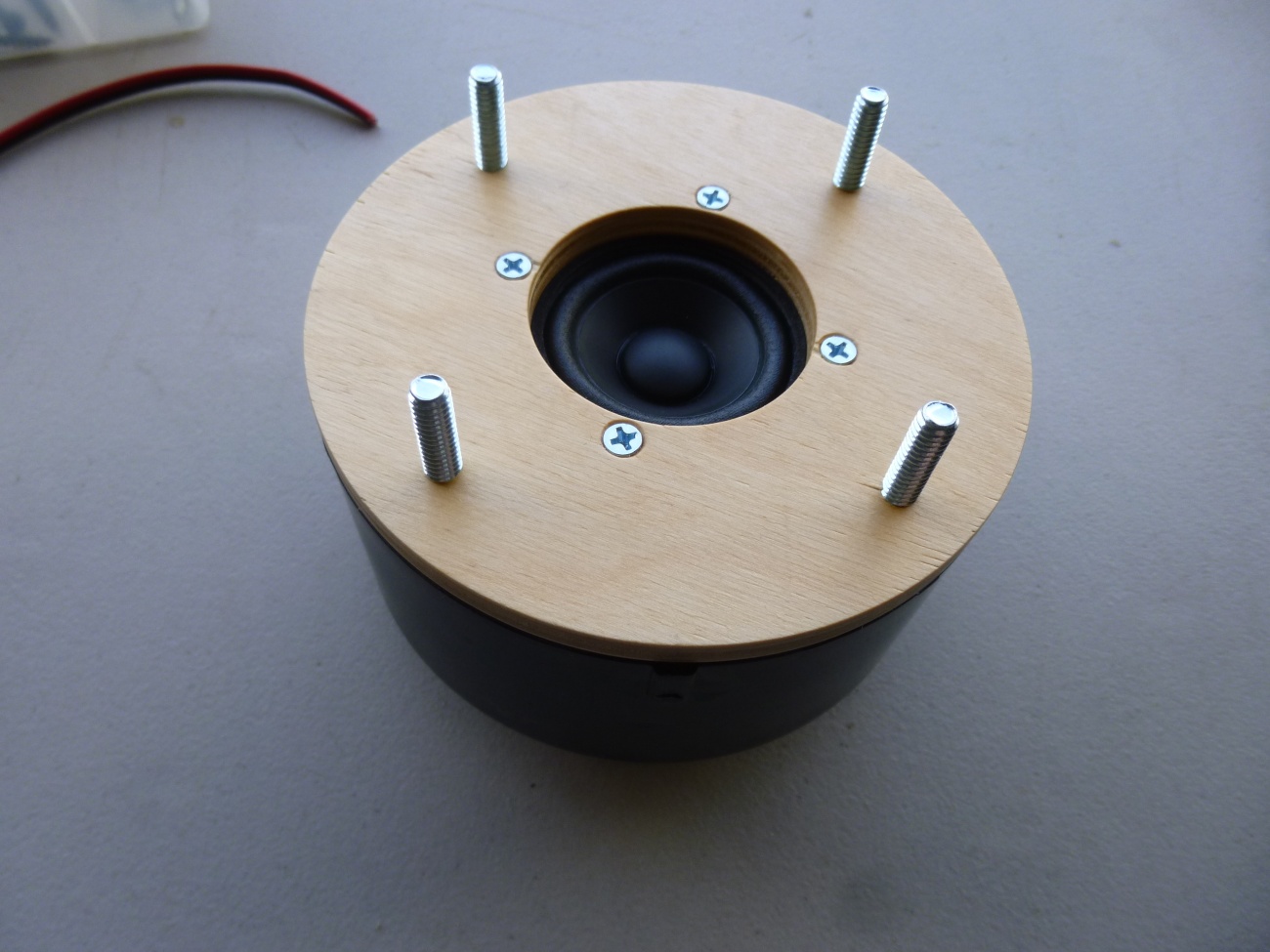

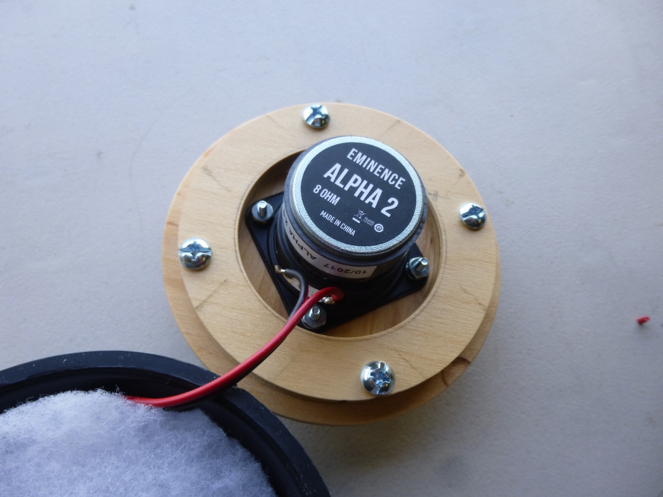

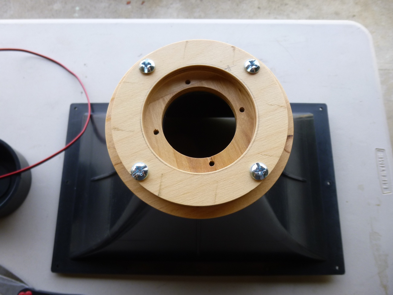

Swapped the Alpha-2 driver to the PRV WG45-50 horn. This is a well made thick ABS horn. The 2" entrance is perfectly round and smooth. I did have to block sand the flange to flatten it a bit, but that's usually the case with most plastic horns. I put a thin narrow piece of adhesive foam tape around the hole - which I normally do.
Regarding the driver. I used a 4" plumbing cap as the enclosure. The plate was made from baltic birch slightly less than 3/4" thick. 1/4" x 1-1/2" screws are used as studs (see the previous pictures I posted) and were drilled and tapped with threads - yes, you can tap baltic birch. A 1" piece of bonded dacron was used for stuffing.

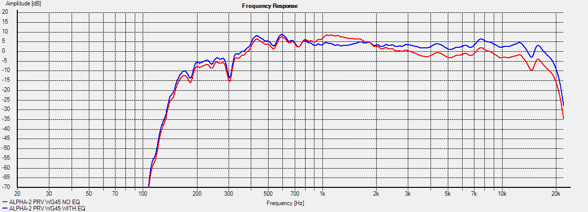

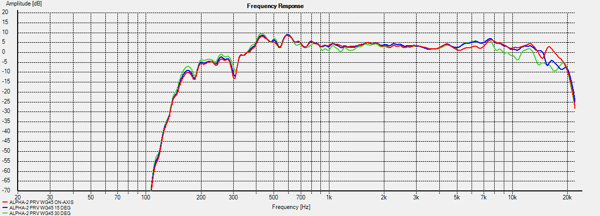

Measurements attached.
Actual SPL 92dB @ 2.77V 3ft.
Screws meaning machine screws, of course. Curve on the PRV horn looks better and I presume sounds better, plus it's from PE not ePrey. Inspiring!
Listening to the Alpha/PRV right now. Very good so far. I'm very susceptible to poor sounding (harsh) horns/drivers and can usually tell in a few minutes whether or not i like it.
The horn coverage is very good - which is what my off-axis measurements showed. I have a 15 ft. X 30 ft. room and can walk around with no sign of dead spots. It's smooth and consistent from one side of the room to to the other. I'm impressed.

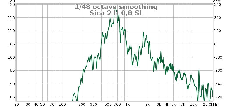

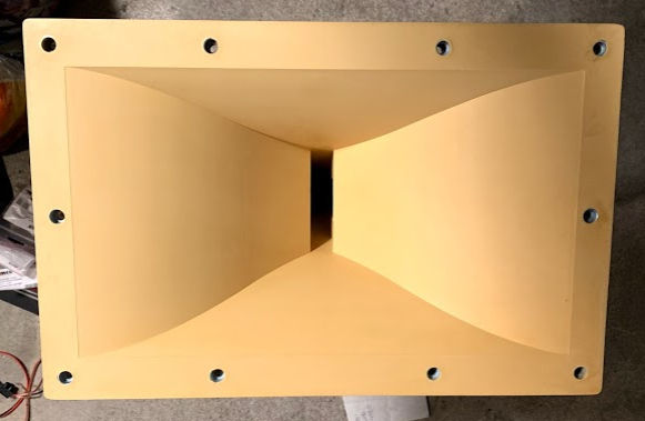

I have not had too much success with this. I got this cheap 2" yellow horn (JBL clone):
This is how Sica 2" full range (SICA 2 H 0,8 SL - 2" Full-range) measures in the horn:

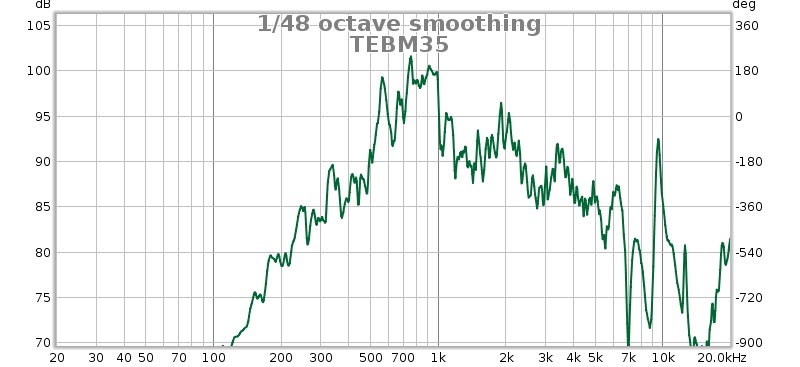

Just for confirmation, I put in a Tectonic TEBM35C10-4 and measured this:
I could not test a CD yet. Is this to be expected? I guess it is the mass roll off is working against me.
Edit: this is unsmoothed in room measurement, with the horn facing up, ca 70 cm above the floor and the mic is ca 50 cm from the front plane. The back of the horn was inside a plastic bucket full of acoustic lining, creating a sort of aperiodic housing for the speaker.

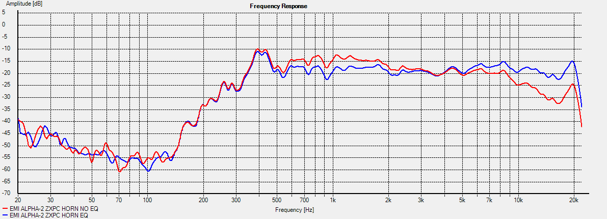

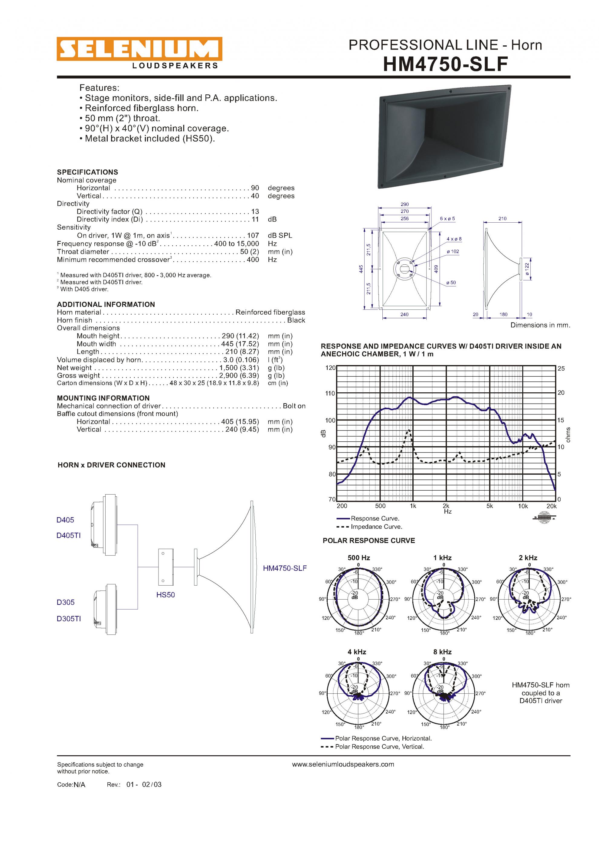

I have the same horn and I need substantial lift from 3kHz + a high Q notch around 800Hz. I guess the throat cavity wreaks havoc under 1kHz??
This was painstakingly done without measurements, lots of trials but ended up quite ok with Visaton FRS 5X.
Thanks to Ro808 I saw this a while ago...
https://www.diyaudio.com/forums/att...l-low-distortion-2-a-hm4750-slf_specsheet-jpg
