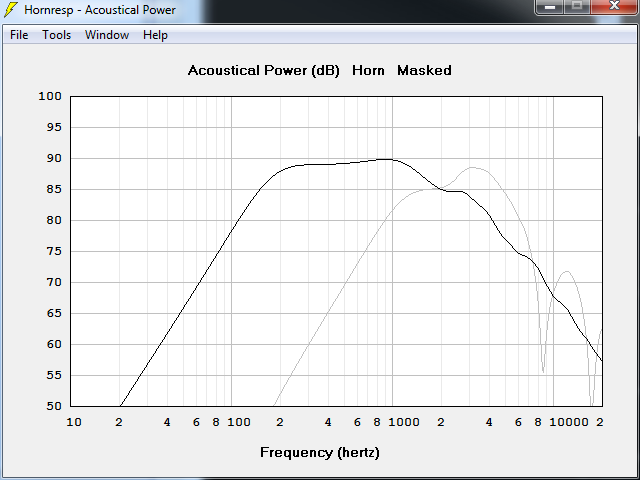

Edit: a quick sim with some geometrical assumptions shows that without a rear chamber and no baffle you would get a null around 8.7kHz and 17.3kHz. With a larger baffle that would bring these down in frequency and could be causing the dip between 6-7k. Try making a simple sealed chamber for the driver and taking the measurements again. Acoustical power response is attached showing a 1L rear chamber (black) versus no rear chamber (gray).

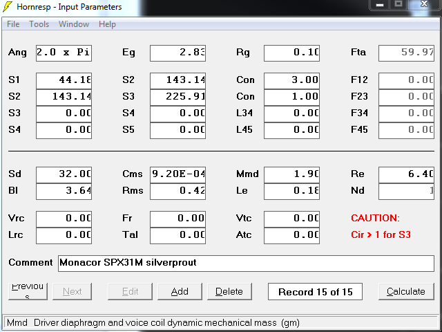

The entry mouth is 75mm and i don't know exactly what is the SPL (forgot to calibrate my microphone :fight:)

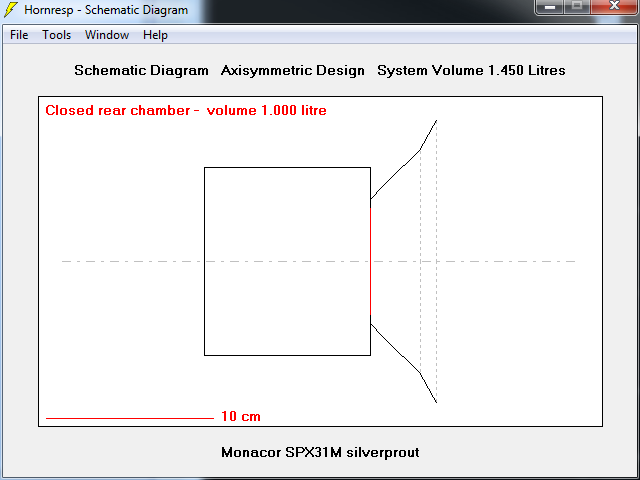

i'm trying to minimise the internal volume occupied by the midrange driver, the open back driver configuration gain is 0.8L

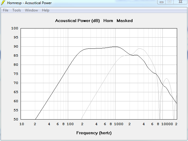

Thanks for your simulation, the WG seems to load the transducer efficiently up to 200Hz... i'm really dubitative with the grey line simulation, is there something to improve in the mathematical model ?
That changes everything if the throat area is 44.18 sq.cm. The other sim was based off of a throat area of 32 sq.cm.
Here are sims with updated data. you can run them yourself if you'd like.
The key things to note are that if the driver is truly open back and the waveguide has no baffle then you'll get cancellation in the lower frequencies and interaction with the front wave at higher frequencies. When the driver is put into a sealed enclosure the back wave no longer cancels and you get your lower frequencies back 🙂
The acoustic power plot is not frequency response. The falling power response is countered by directivity and beaming, so the frequency response is most likely much flatter above the upper power roll off.
Also note that the sims were done assuming a 2*Pi space. Using them in a room and close to a wall will make it 1*Pi.

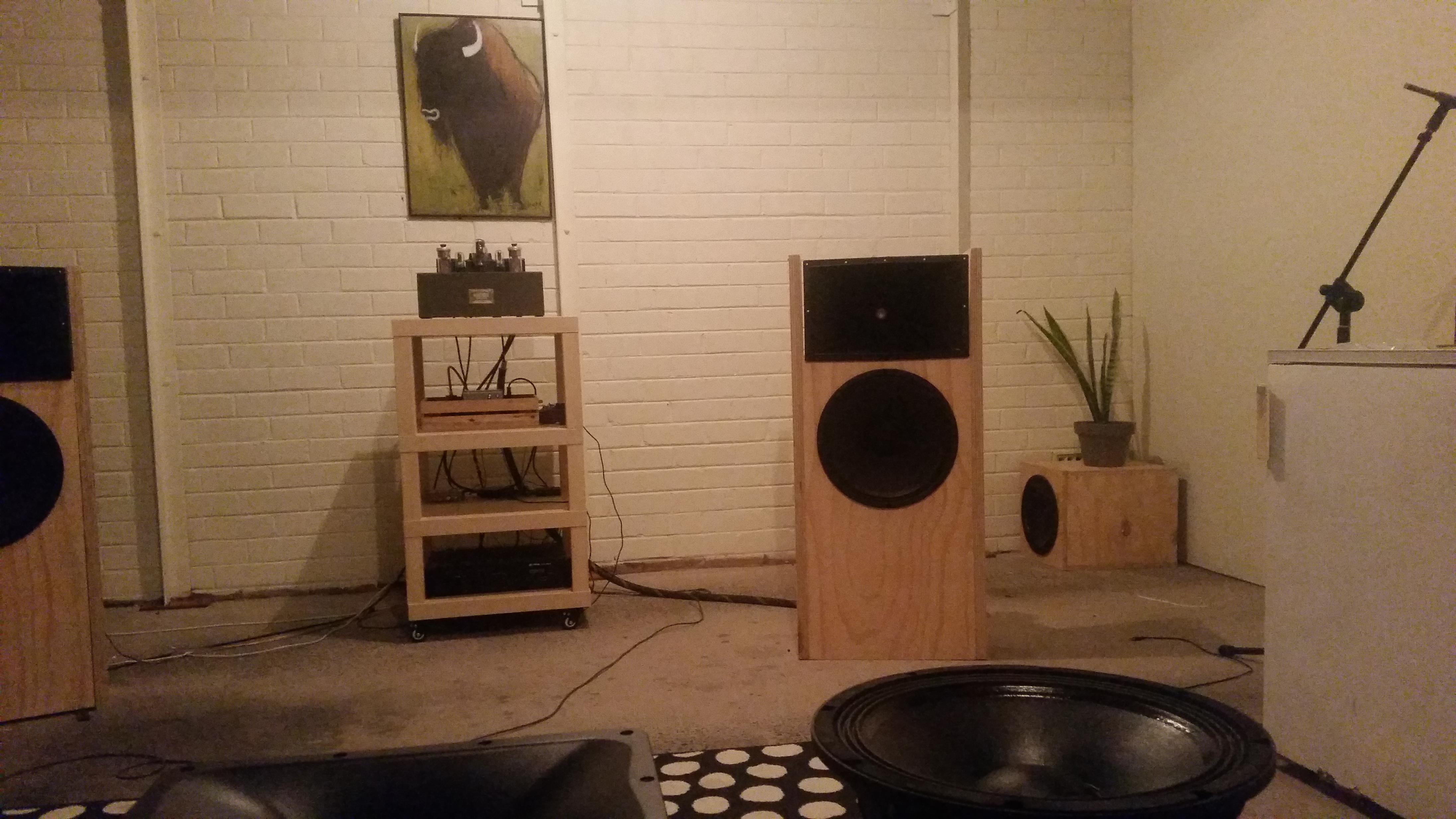

Audiophile footwear
A picture of my latest set up
Same driver but with wool damping over the back aka a sock 🙂 I was hopig to progressively dampen the higher frequencies to gain some clarity and better imaging. It seems to have worked very well
