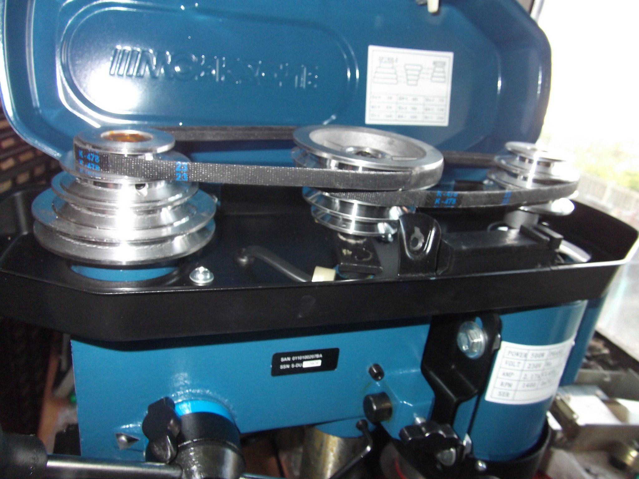

I took photos as I got it out of the box and put it together it was back in 2016.

Question: does anyone regularly use the multiple speeds on these drill presses? I have always just set the thing on the lowest speed and left it there. But I usually focus on wood and don't often work with metal beyond the odd flat/bracket like things.
Not a machinist, 30+ years ago I worked in shops with them, so I have used metal lathes, mills, etc. a couple times (and managed to not lose anything that didn't grow back), but that was semi-supervised where I could ask an old-hand.
I change the speed all of the time depending of the bit size/type and material.
I wish I had a VFD for easy speed change and for speeds below 300rpm(lowest I have now with pulleys)
