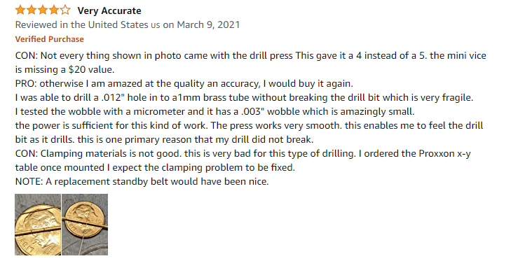

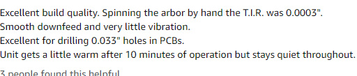

I'm little obsessive. I'm looking at this unit. a little expensive but much less than accurate high quality machinists type of equipment.
Might be a little small as I would like it to drill heatsink holes to rear panel connector holes for rca's and binding posts. it has some negative reviews but the attached positive reviews indicate it might be what i'm looking for

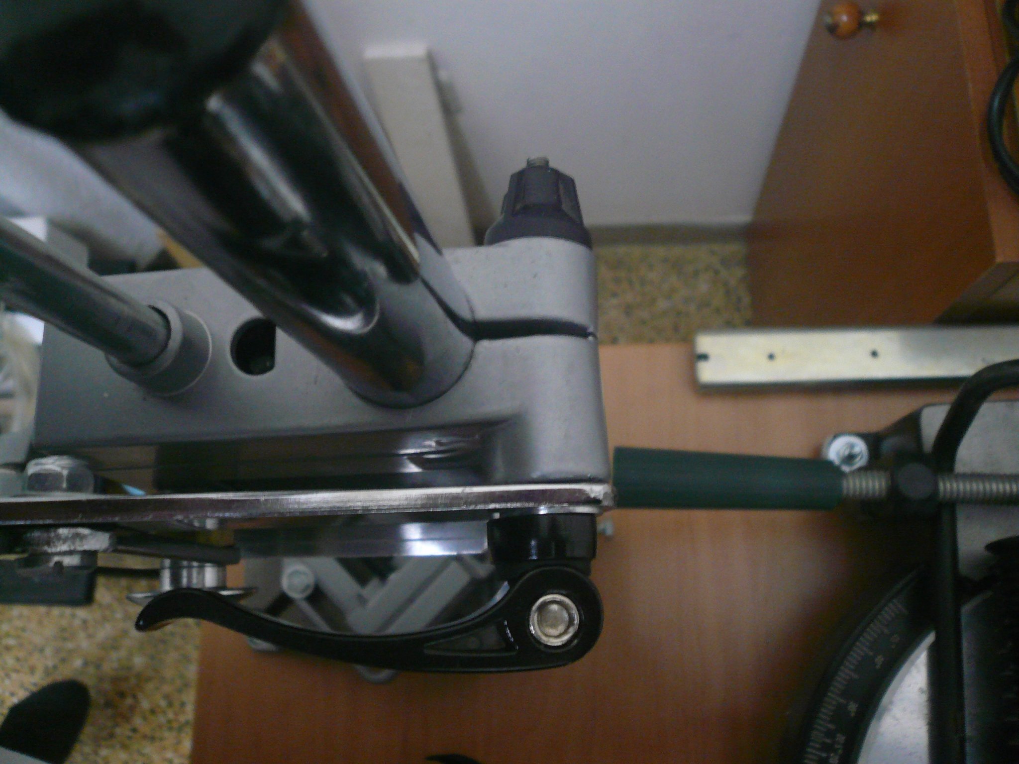

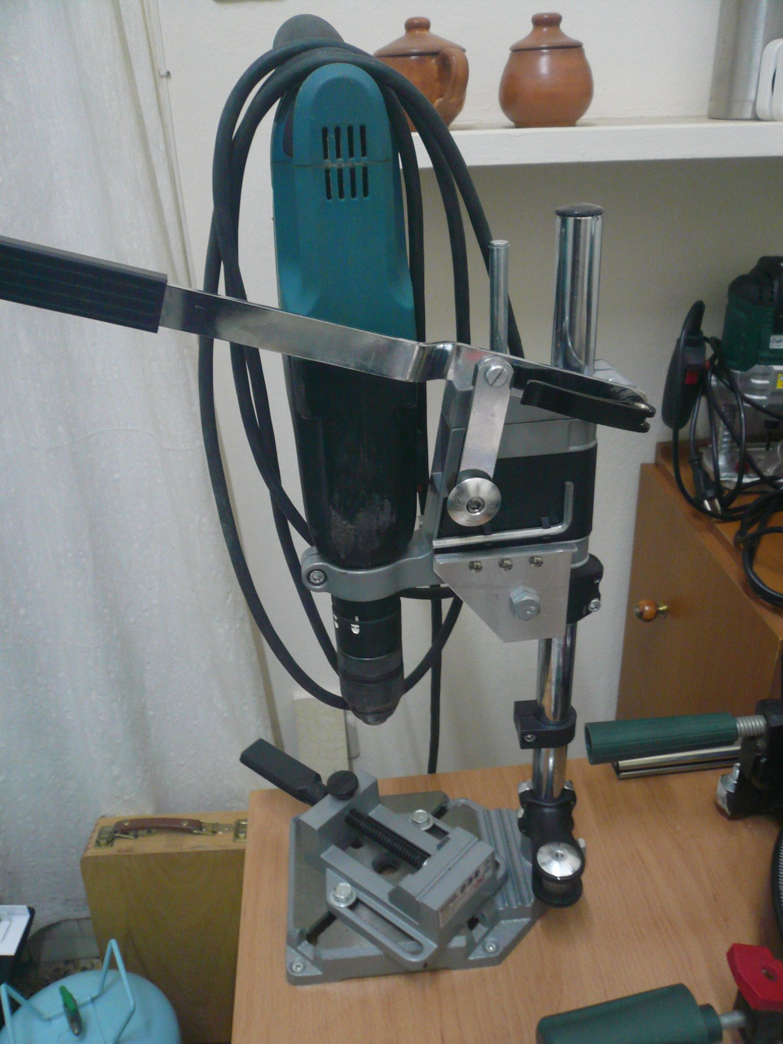

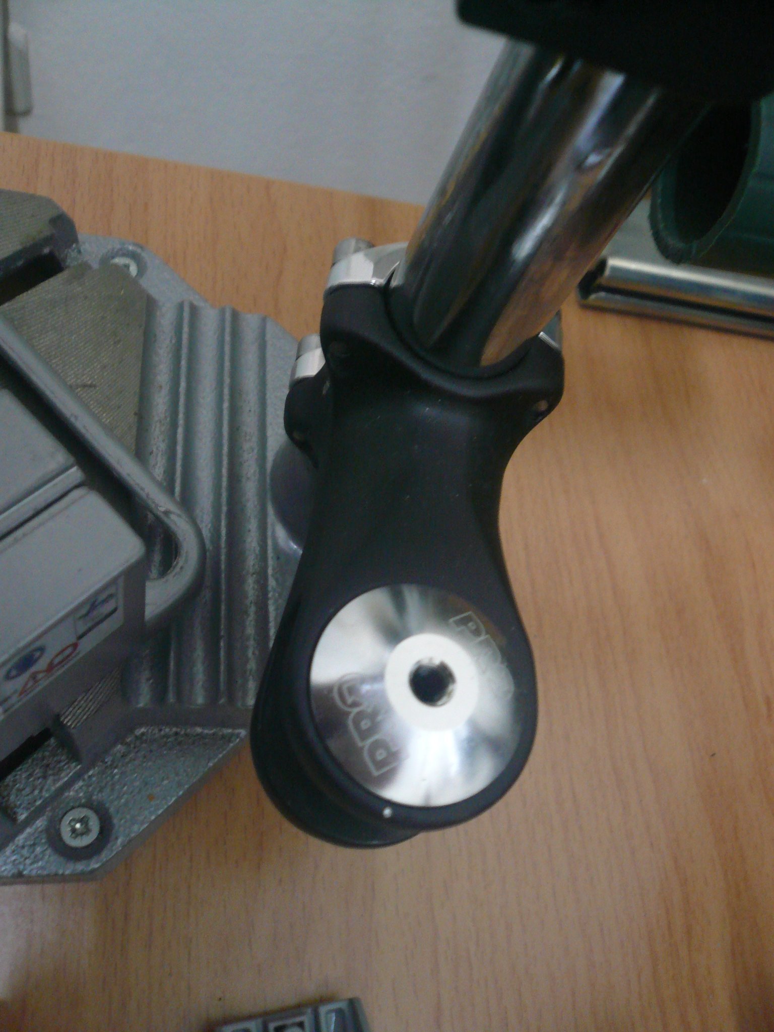

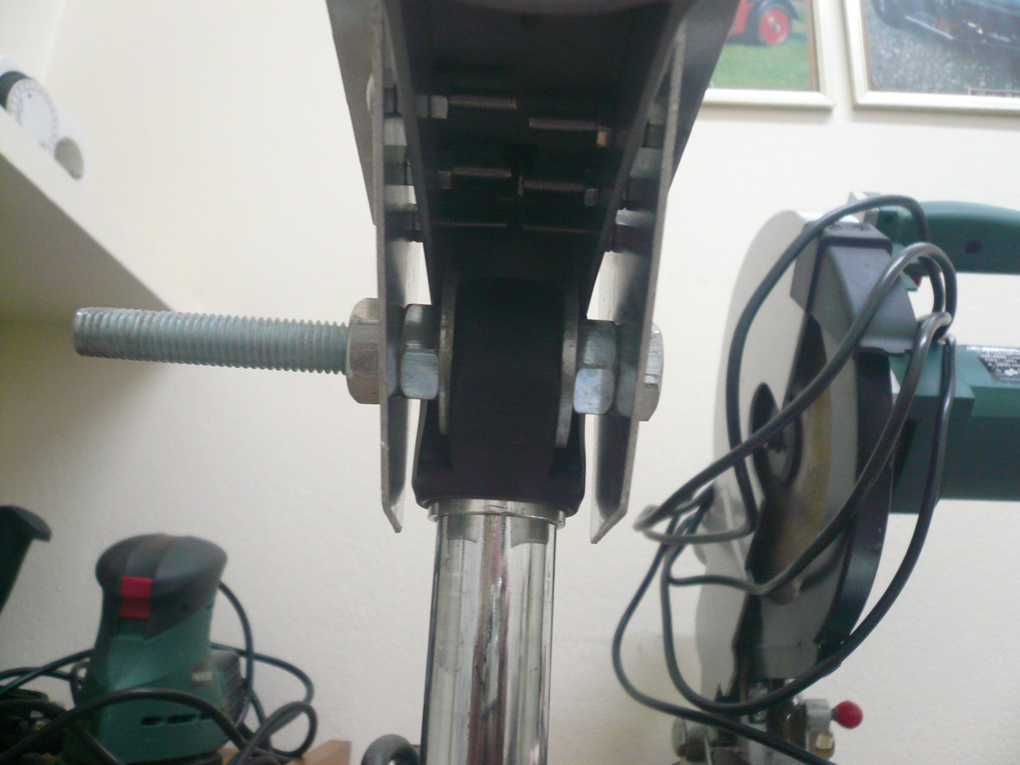

I have this one exactly. Out of the box is to be avoided... It's wobbling awfully. But I fixed it with an old bicycle stem - partially hidden behind those aluminum plates. And a wheel quick release for adjusting height. Very accurate now!View attachment 1148524

Do you have a better pic of how you used the bike stem. I have similar stand and it is not great… would be cool to make it useful.I have this one exactly. Out of the box is to be avoided... It's wobbling awfully. But I fixed it with an old bicycle stem - partially hidden behind those aluminum plates. And a wheel quick release for adjusting height. Very accurate now!

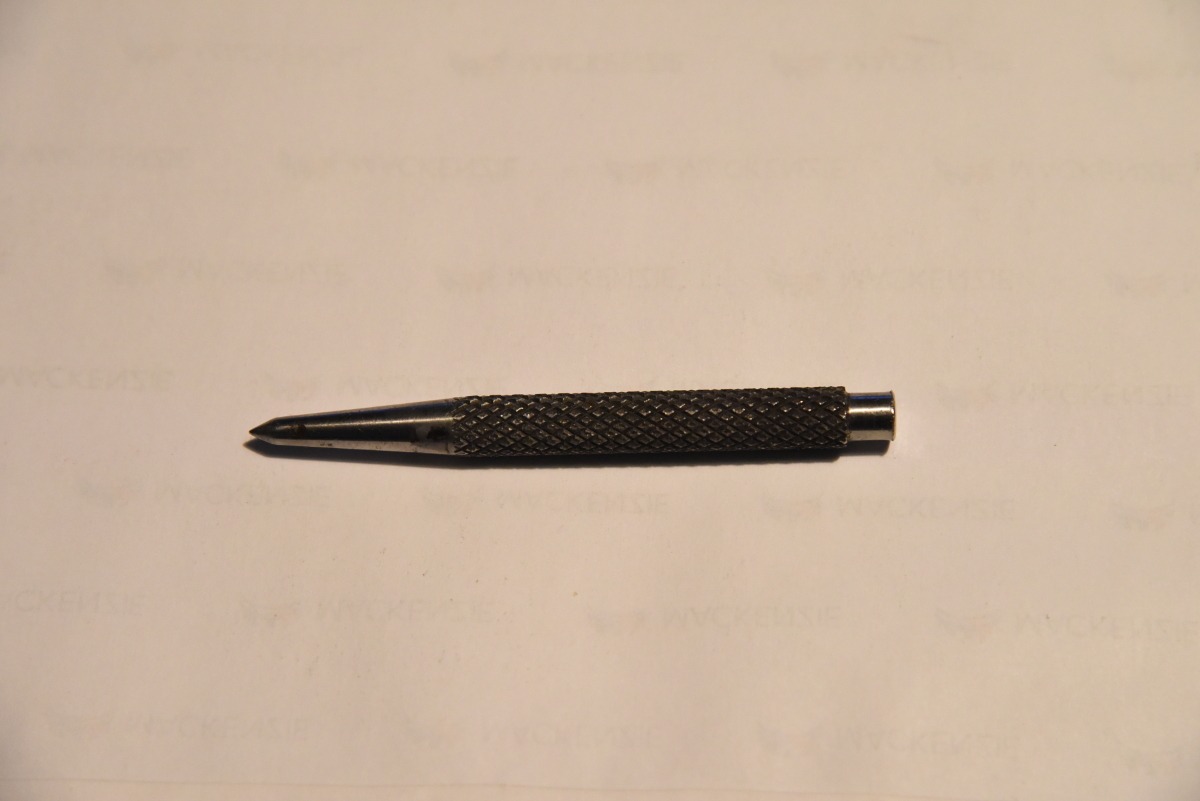

I've made a SHARP point on a steel rod that works like a dream.So it comes down to accurately marking the hole for drilling. I’ve used those spring loaded center punches but it’s difficult to get exact center for all holes
Or even a sharpened 3" nail works.
I've got one that's quite powerful and leaves a decent 'crater' to start drilling. For casework I've usually got a paper template stuck (double sided tape) over the metal with accurate crosshairs and it's easy to punch into.So it comes down to accurately marking the hole for drilling. I’ve used those spring loaded center punches but it’s difficult to get exact center for all holes

Best I could do. The stem is of the adjustable type -two pieces. One part waits for a light duty lathe project since the stand is now very stable. The other part is attached with a 10mm bolt as shown - aluminum plate, nut, washer, stem, washer, nut, plate. The plates are attached to the stand with small bolts, then everything is aligned and tighten. You may want to control wobbling with the stem's bolts but in my case it wasn't necessary. And a photo of the quick release that makes height adjustment easy.Do you have a better pic of how you used the bike stem. I have similar stand and it is not great… would be cool to make it useful.

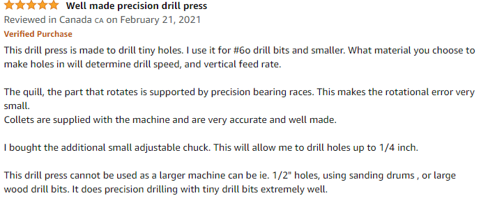

I bought this model Proxxon new about 5 years ago and still have it in addition to a Dremel drill press stand. The Proxxon is light but solid, very well made for precision modeling, and absolutely worth about half (!!) what they sell for new in my opinion.I'm little obsessive. I'm looking at this unit. a little expensive but much less than accurate high quality machinists type of equipment.
https://www.amazon.ca/Proxxon-38128-Bench-Drill-Machine/dp/B0017PUR1Y
The good news is that they sell used for about $125 US on the auction site fairly regularly. At $125 it is a reasonable value for a good condition example.
