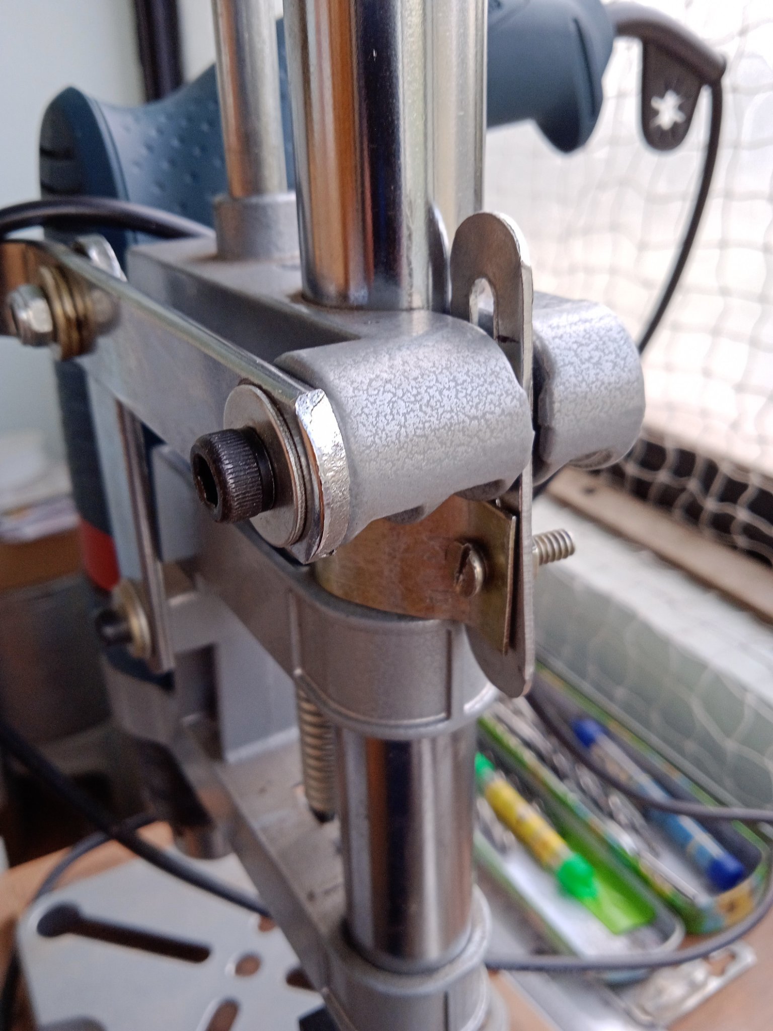

I tried to fix the rotational wobble by attaching a collar and fixing a plate, both mild steel.Best I could do. The stem is of the adjustable type -two pieces. One part waits for a light duty lathe project since the stand is now very stable. The other part is attached with a 10mm bolt as shown - aluminum plate, nut, washer, stem, washer, nut, plate. The plates are attached to the stand with small bolts, then everything is aligned and tighten. You may want to control wobbling with the stem's bolts but in my case it wasn't necessary. And a photo of the quick release that makes height adjustment easy.
