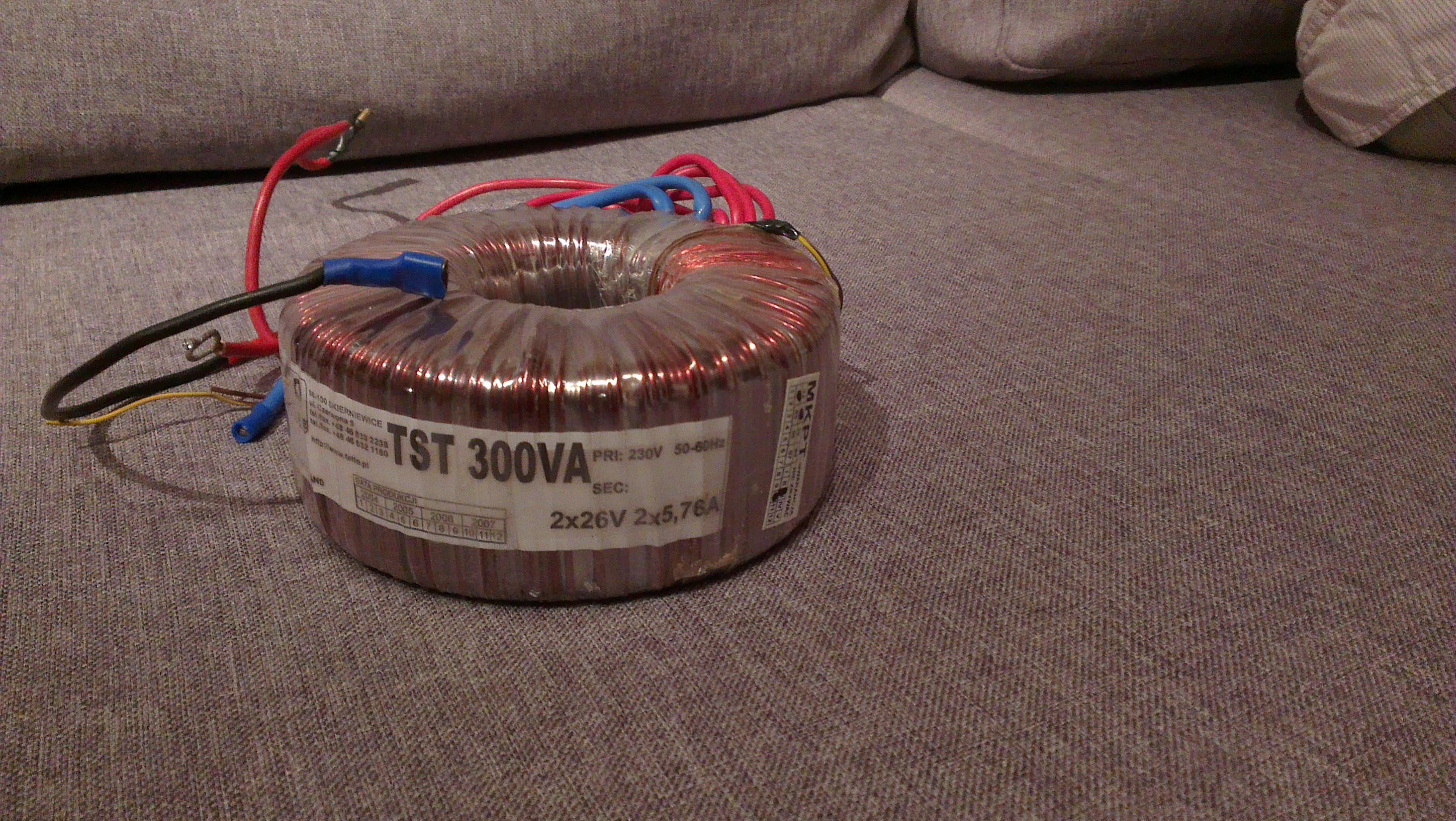

I want to stay strictly with VSSA, no modifications, I just wanted to stay in this topic. Basically it says everything from 20-45V dc is OK. I surely don't need 60W, cause I decided that this amp is my private one for my small room 😀 But lowering power too much is not OK too. Maybe I would just buy another trafo, with a bit smaller output voltage. I have to think about this 😀
25+25V trafo ?

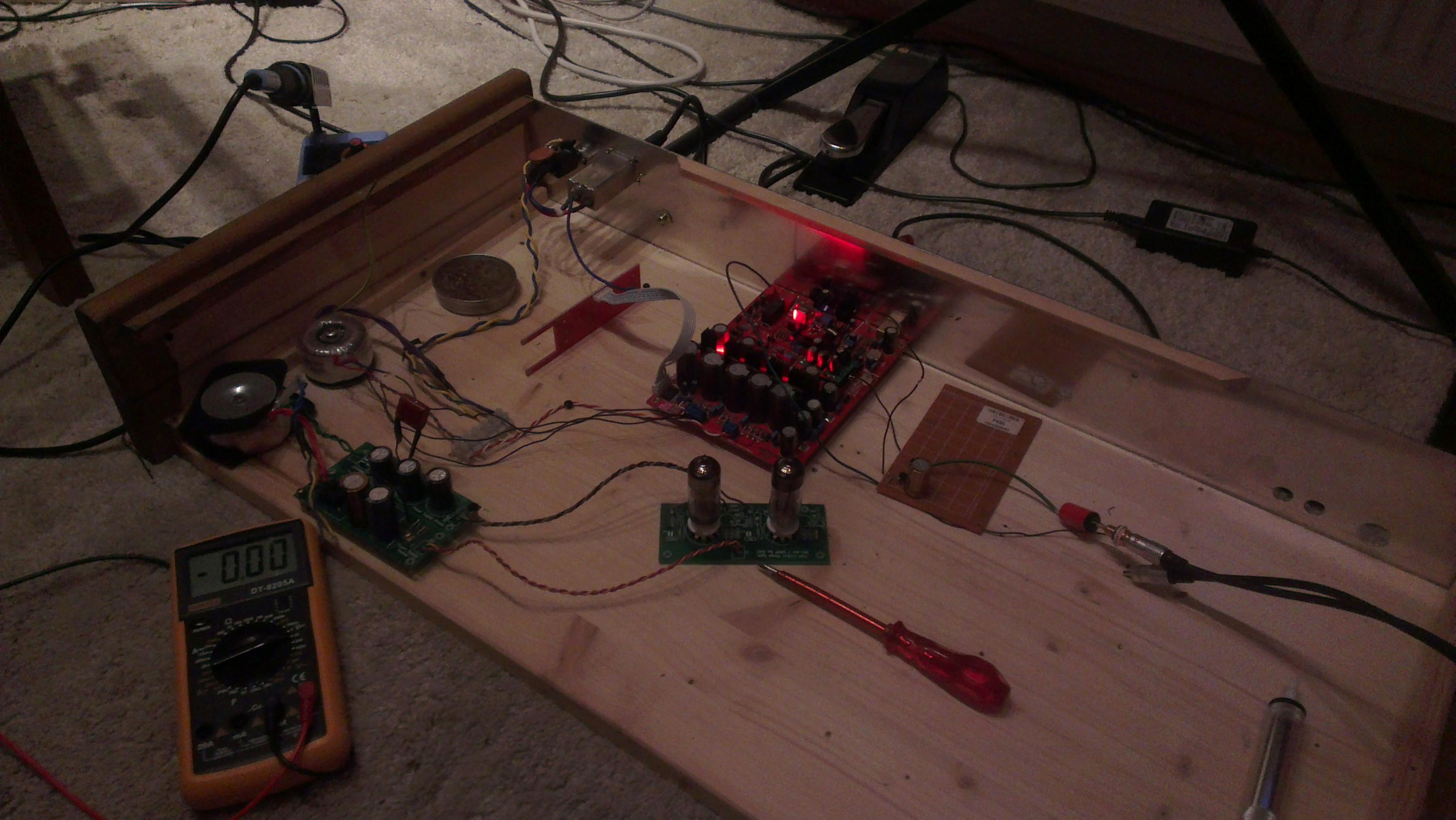

I had some issues with tube preamp, they picked up a bit of hum, but it wasn't big deal. There is something wrong with my PCB so I quickly made a small 1 solid-state preamp using BF245.
PCM1794 -56 ohm in series and parallel - bf245 - a bit too much of voltage and resistance for PCM (I think) caused a bit of distortion. I need more gain so I have to look for something bigger. Anyway, I'm pleased with what BF245 do and I have regulated supply for this one, so now I will stay with solid state preamp. Tubes will have their own box. Do you know any simple preamps using BF245 or similiar?
Everything is OK now - I measured it for A version of FET not BF245B

I got everything ! VSSA assembled and all the stuff, but there is a problem. VSSA is not running. I use 2x26V trafo (as above) connected to PSU (each 26V section to the seperate bridge and then to seperate caps and to VSSA). There should be around 35V on each VSSA, but there is 39V and 32V on each, setting the trimmer does change the offset (and voltage too) but there is nothing on input bias. Like it does not consumpt the power. PSU are grounded together in the star ground (with GND from VSSA too). Any ideas 🙁 ?
1) did you use the 20-22 Ohm resistors during setup?I got everything ! VSSA assembled and all the stuff, but there is a problem. VSSA is not running. I use 2x26V trafo (as above) connected to PSU (each 26V section to the seperate bridge and then to seperate caps and to VSSA). There should be around 35V on each VSSA, but there is 39V and 32V on each, setting the trimmer does change the offset (and voltage too) but there is nothing on input bias. Like it does not consumpt the power. PSU are grounded together in the star ground (with GND from VSSA too). Any ideas 🙁 ?
2) If you did, what is the voltage drop across the resistor (you can divide that by the value of the resistor to see if excess current is being drawn by one of the rails)
3) if all that shows normal current drain, what is the DC voltage at the output? In other words, is the output pegged to one of the rails?
Yes I used the resistor. There is no voltage drop and amp is cold. No current drain. There is a change of DC at the output when turning trimmers, however it's all in small values, like about 10mV.
Measure supply voltage from TP1 to GND. It should be 0,5 V lower than + VDC. If not, check R19, R20 if they are still 10 Ohm.
TP1 is 0,5V lower than +VDC. R19/20 are 10ohm.
The problem is I measured the rails from + to - not to GND (yea...) so they're about 17V. Which is not good when the trafo is 2x26V (26V between two wires). I just can't get it work normally. In every option it just lowers the voltage so much.
Now the power supply is done, the trafo is center tapped and PS is symmetrical + and -37V rails. 37V because still not under stress... VSSA is still not wanting to run. 60mV... drop across 22Ohm. What should I check then? Why should VSSA not run with voltage connected?
