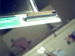

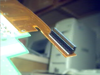

You need to extent the connector at the far corner of the LCD not the FFC cable...
Joe
Joe
now that i opended it i see what you mean.. its not really an extension, but just we need a wire to go from point a to point b.. do u no exactly what we need? cause i got this magazine that has wires that will probably have it
the corner conector is all we need to extend. 80 pin connector 3/4" ling, have to make an extention cable of some sort.
joe is this wat we are looking for ?

No wrong connectors they do not look like that at all. and it is not a FFC cable. it is a connector with the pins on the outside 40 pins each side a total of 80... i will see if i can find a pic of one.
i then tried bending it so that i would only lose a little bit, because im gonig to have to make it smaller anyways, and the circuit screws me over- its to big. so im all out of ideas. Do you think youll be able to find a connector?
I think Digikey.com will have them have to get the connectors male and female and also a cable. i will prob. call them tommarrow. They might be the SMT connectors. not sure. look at the catalog they have online under connectors.

frankly
I have no clue, it is not the best picture but I cannot make up any information on size, etc....
tell me what is printed on the flex cable to goes into the connector
it usually has the name of the brand, and 2 series of numbers
that should be enough to get a step further.
J-P
